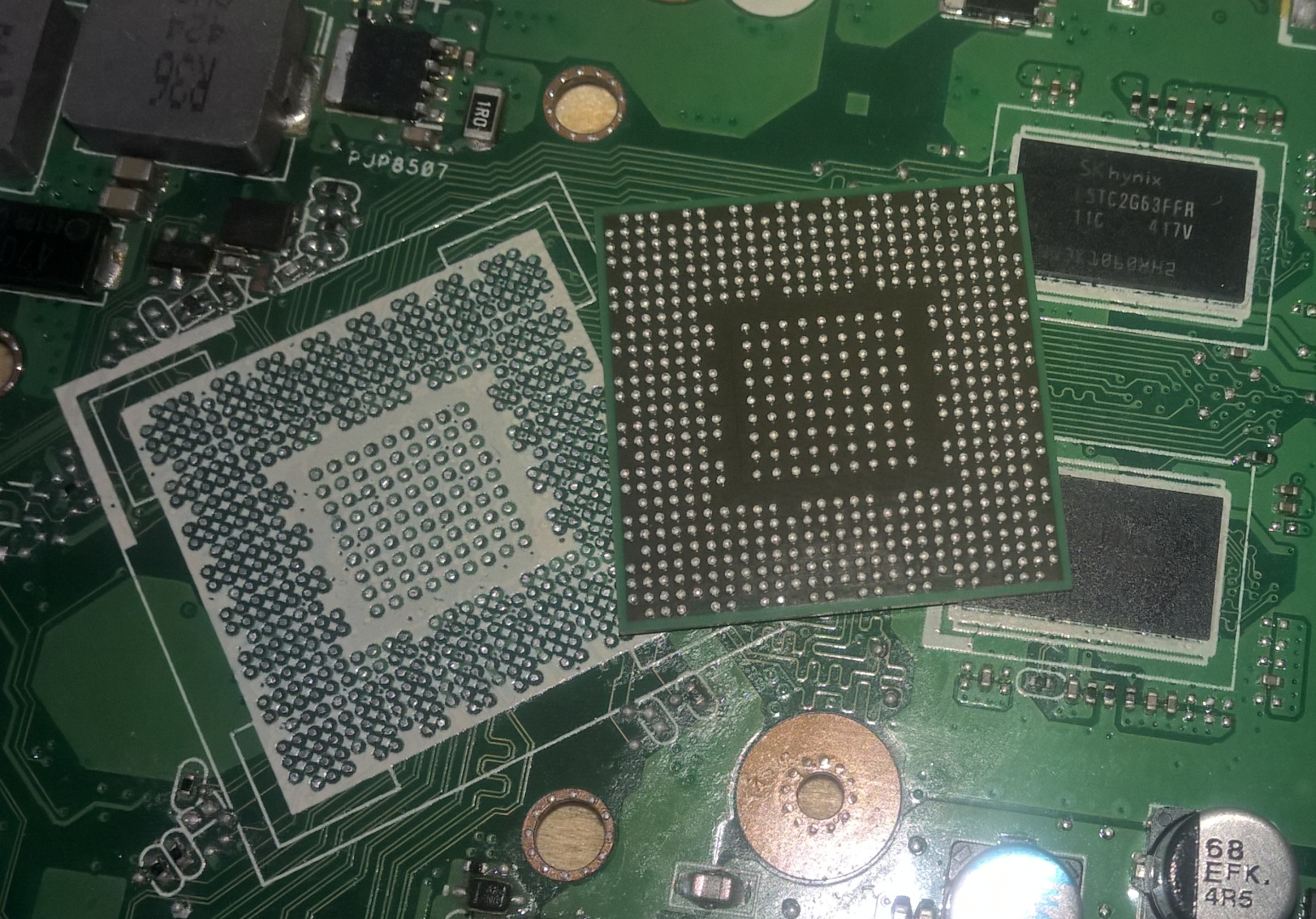

          The second one is an ASUS X552CL, nVidia GPU had code 43 in device manager, reflow did not change anything. This chip I bought brand new as it was very cheap. With the new chip everything worked fine, did not even have to reinstall drivers. Have already sold the laptop last month.

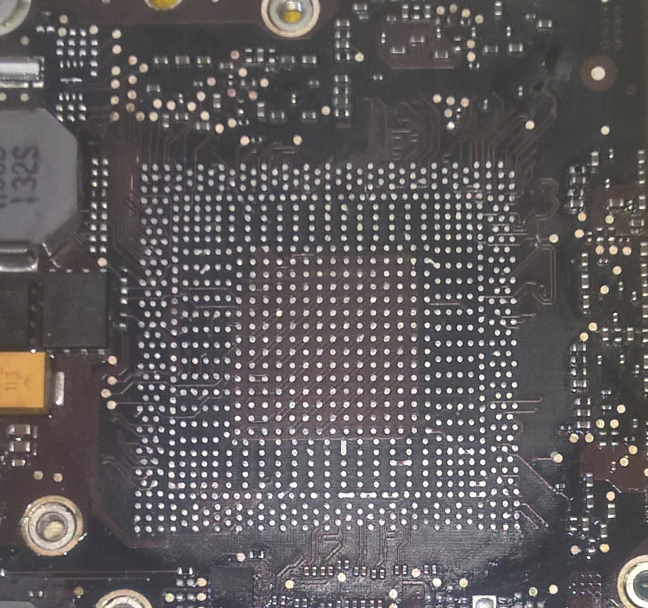

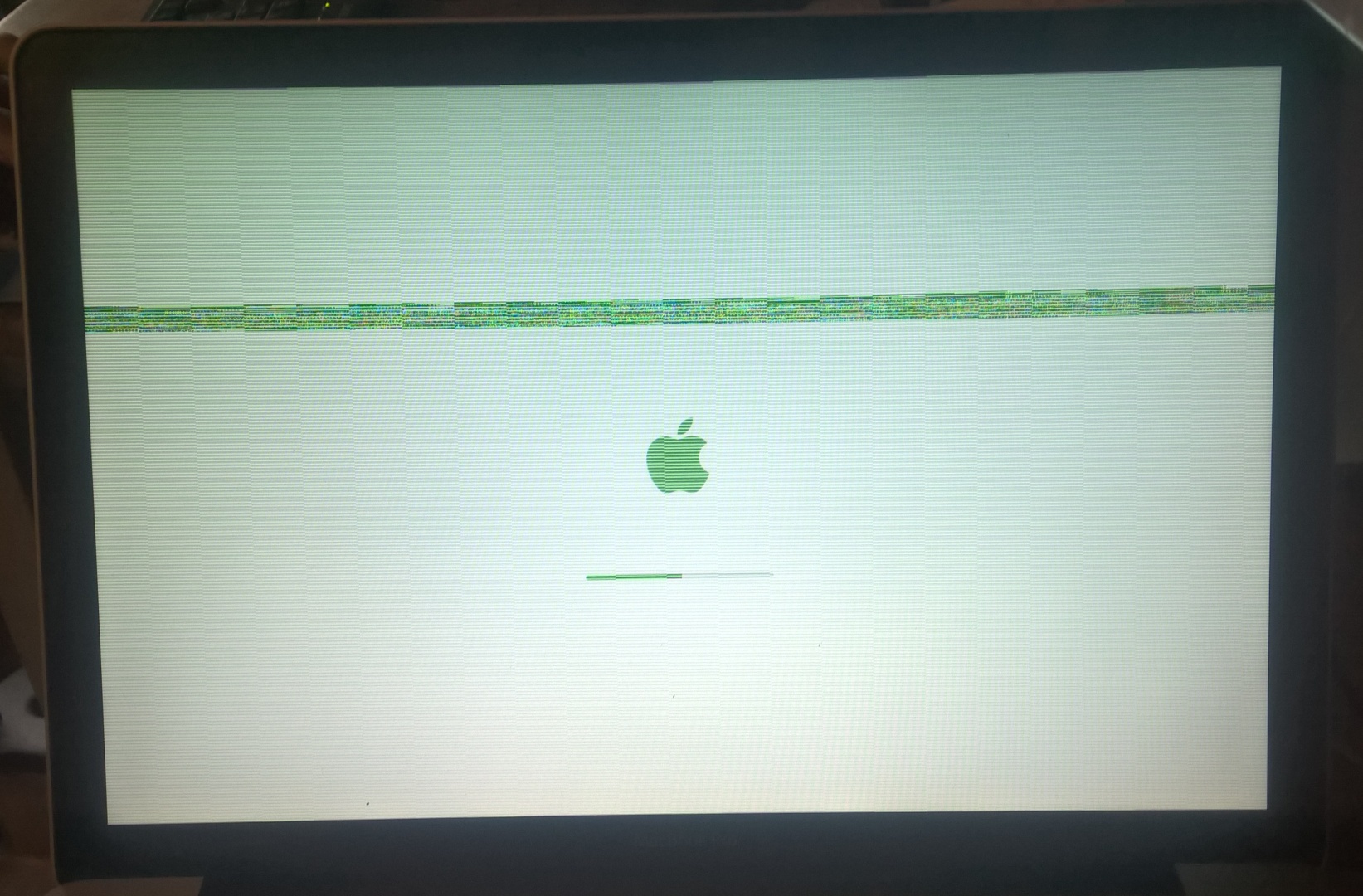

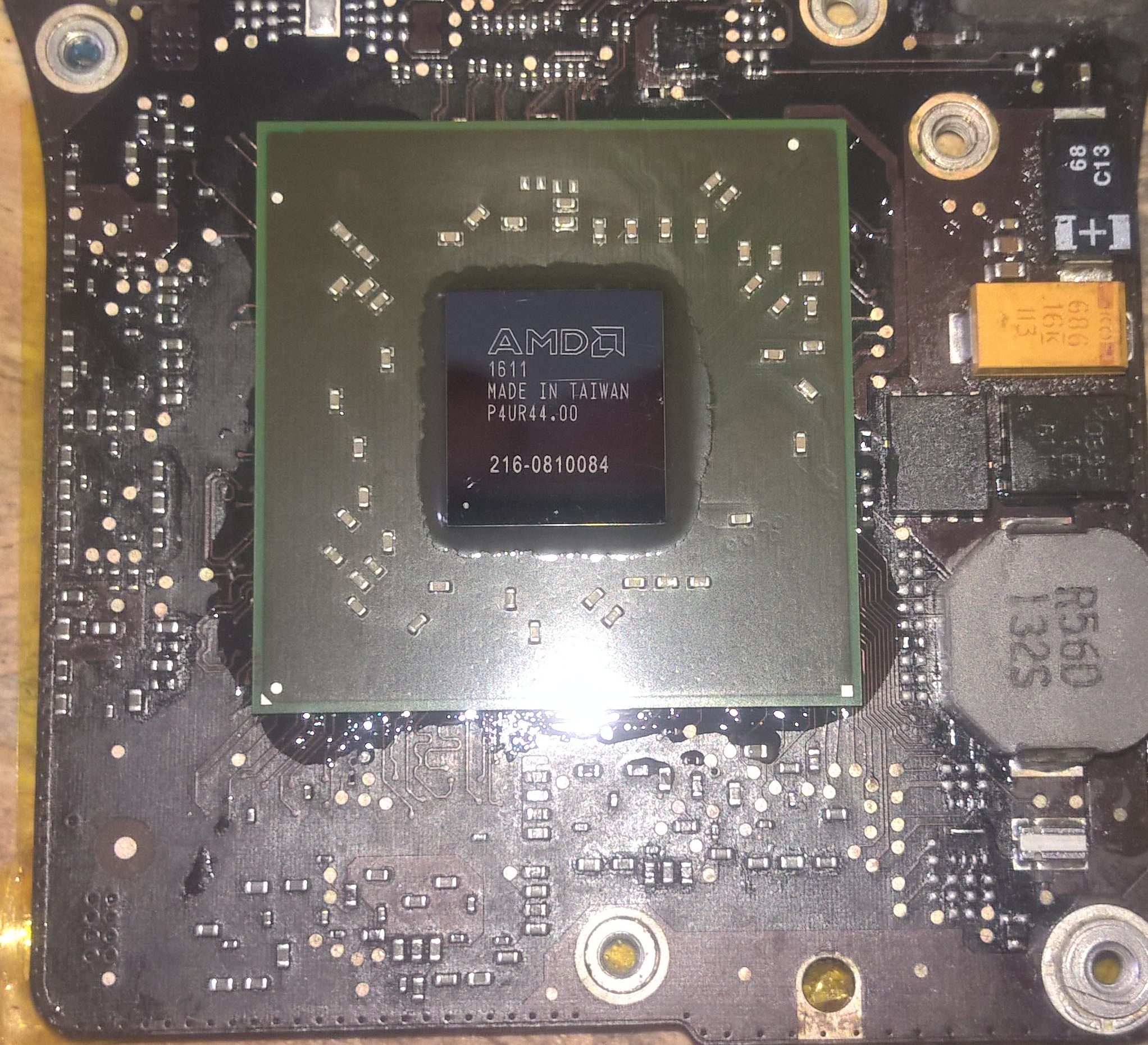

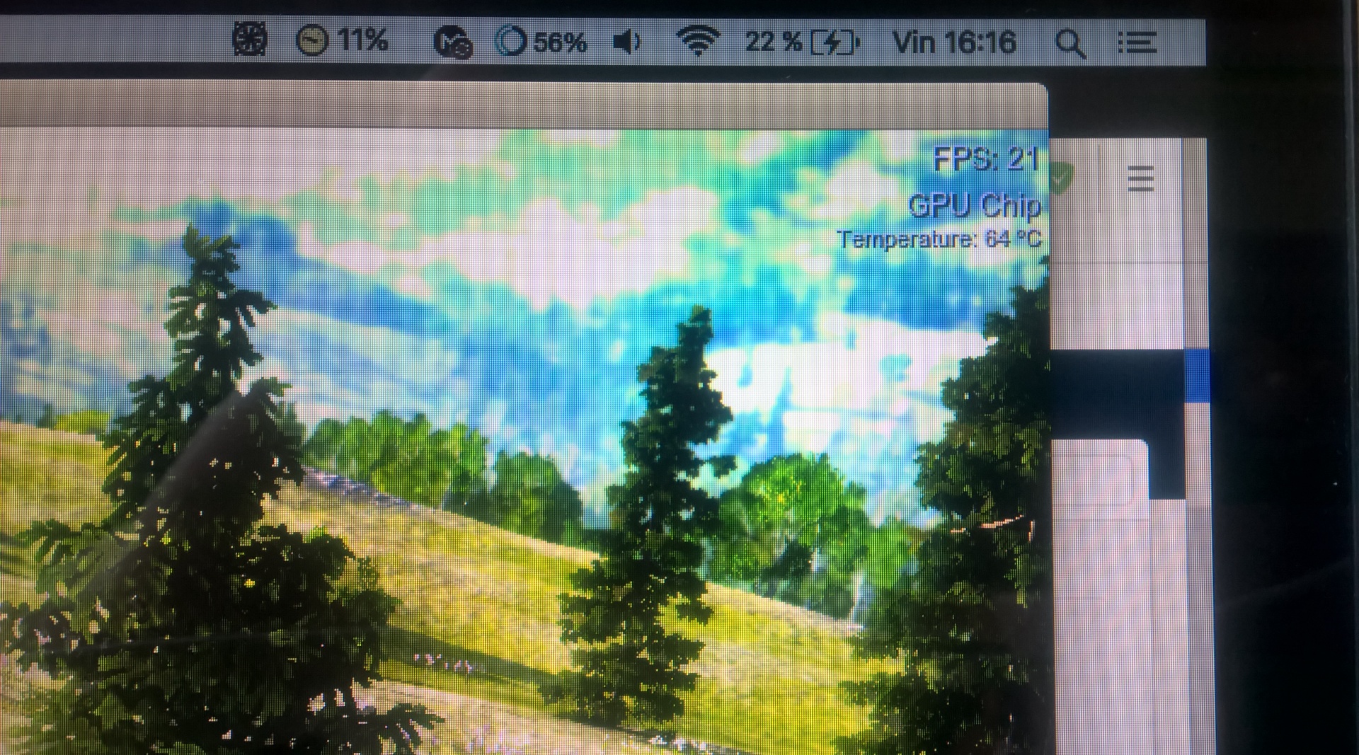

            Re: Let's talk about BGA Chip suppliers
            And here is a Macbook Pro 2011. Replacement chip sold as "bulk".

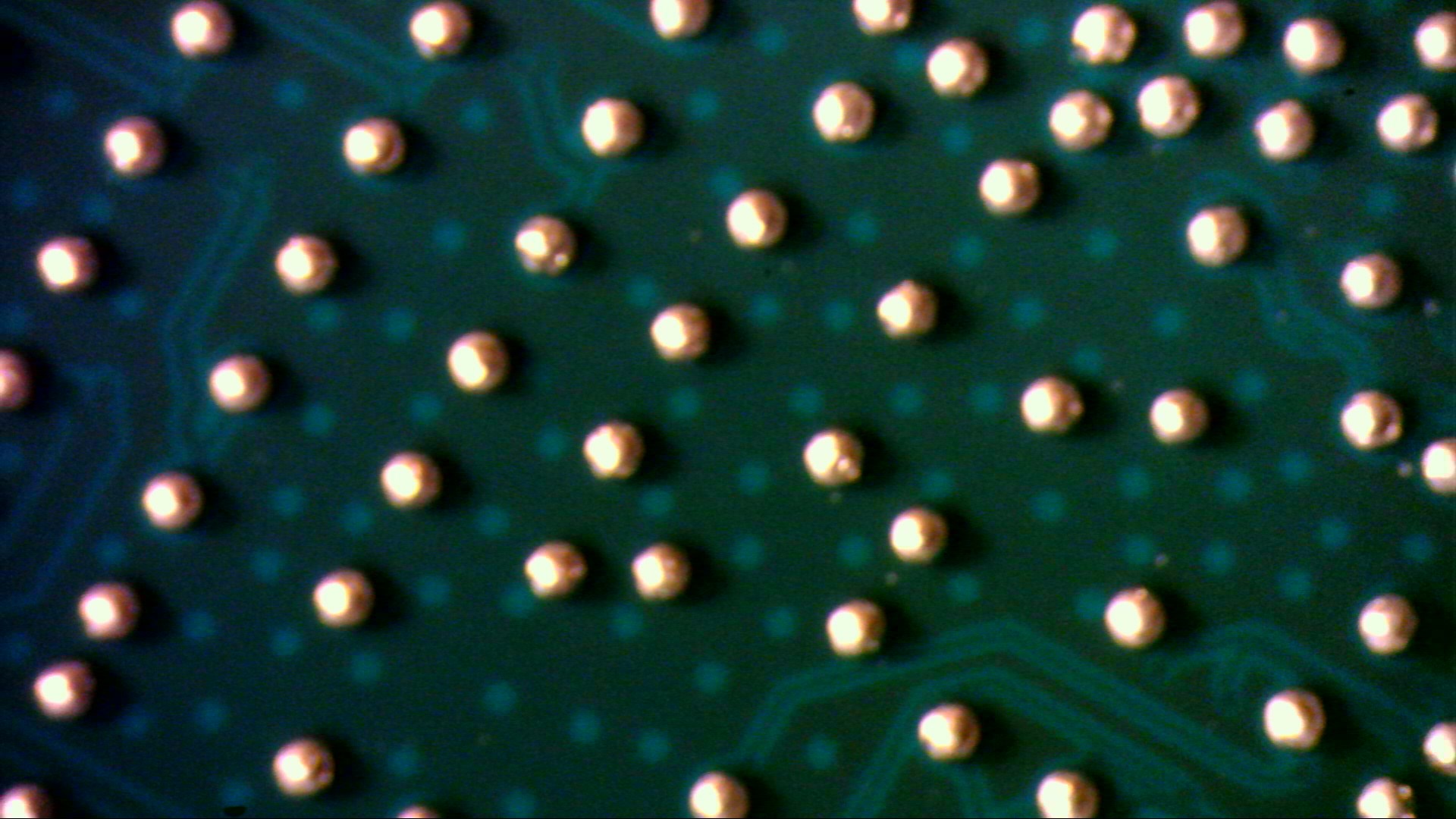

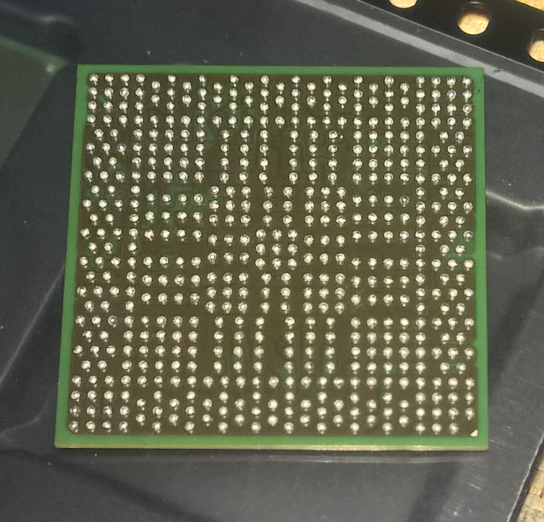

              one chip from goldenchipset: n13p-gt-a2 buy it new for 50 $. notebook give a error on bga, after solder that new one (after reballed ) i got an error 43 if i try to install driver manually from device manager, while if i install from nvidia procedure, it all seems fine except when it get to the end of installation, display freeze. when rebook display become black after the windows loading logo.
              second i got a bga refurbished always from goldenchipset, and they told me he already got leaded balls, so used my profile to solder it, but first time it give me a white screen. after a second reflow notebook give me a black screen.
              they used different balls (maybe 60-40 instead of 63-37) and i need more heat to solder properly, or bga is defective ?
              its an intel n2840 all in one bga (nb sb cpu vga).
              there are bga that works just fine after replace , and some others just give me black screen or doesnt work well.
              in addition, the stencil goldenchipset sent me was defective and i damaged original bga when reballing. they just sent me a new stencil (1.2$), but my bga was damaged and got this refurbished one for 19 dollars plus 17 for shipping plus paypal commission for a total of 37$ for a non working bga atm....
              edit: how do u place bga on non marked pcb like macbooks ?
                You got sent a damaged chip.
                BGA is definitely defective at this point. 60/40 and 63/37 are not too different in melting point, it should have soldered fine. But you might have been sent a lead-free chip, most of the refurbished chips I have bought used lead-free solder, likely so unscrupulous sellers can pass them for new ones.
                Easy way to figure out the solder type is to shine a bright light onto the balls, lead-free has a matte texture while leaded solder will be shiny.
                I take several "before" photos, to have a reference. I compare the chip's distance to the parts around it to what I see in the photo. I also use a flashlight and shine it from the sides to see if there are pads sticking out. And, you're going to laugh here. On this one, what gave me 100% confidence of a good alignment were the scratches that i had made with my tweezers while removing the epoxy in the corners of the BGA. They were so accurate that i'm thinking of intentionally making the scratches next time, so they are more clear.

                    about the refurbished bga, they told me it got leaded balls. generally i solder leaded bga with a temperature setpoint of 200° and watching the bga, it start getting down at about 193° so i set temperature to shut off bga machine at 200°.
                    on that bga i did same profile, and bga dont move so it must be soldered....if it was a lead free, it should have not melted the balls and bga should not have attached to pcb right ?

                      If it were lead free, it may have melted a little bit but it definitely would not have attached to the board properly. If it sat down on the board at 193C then it was leaded solder, indeed.

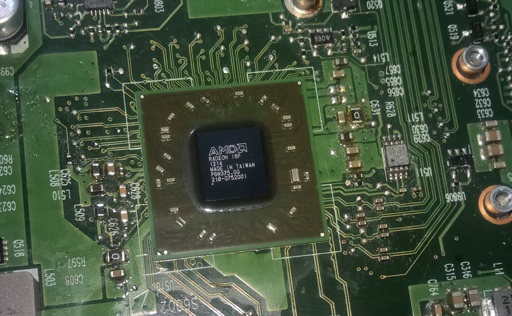

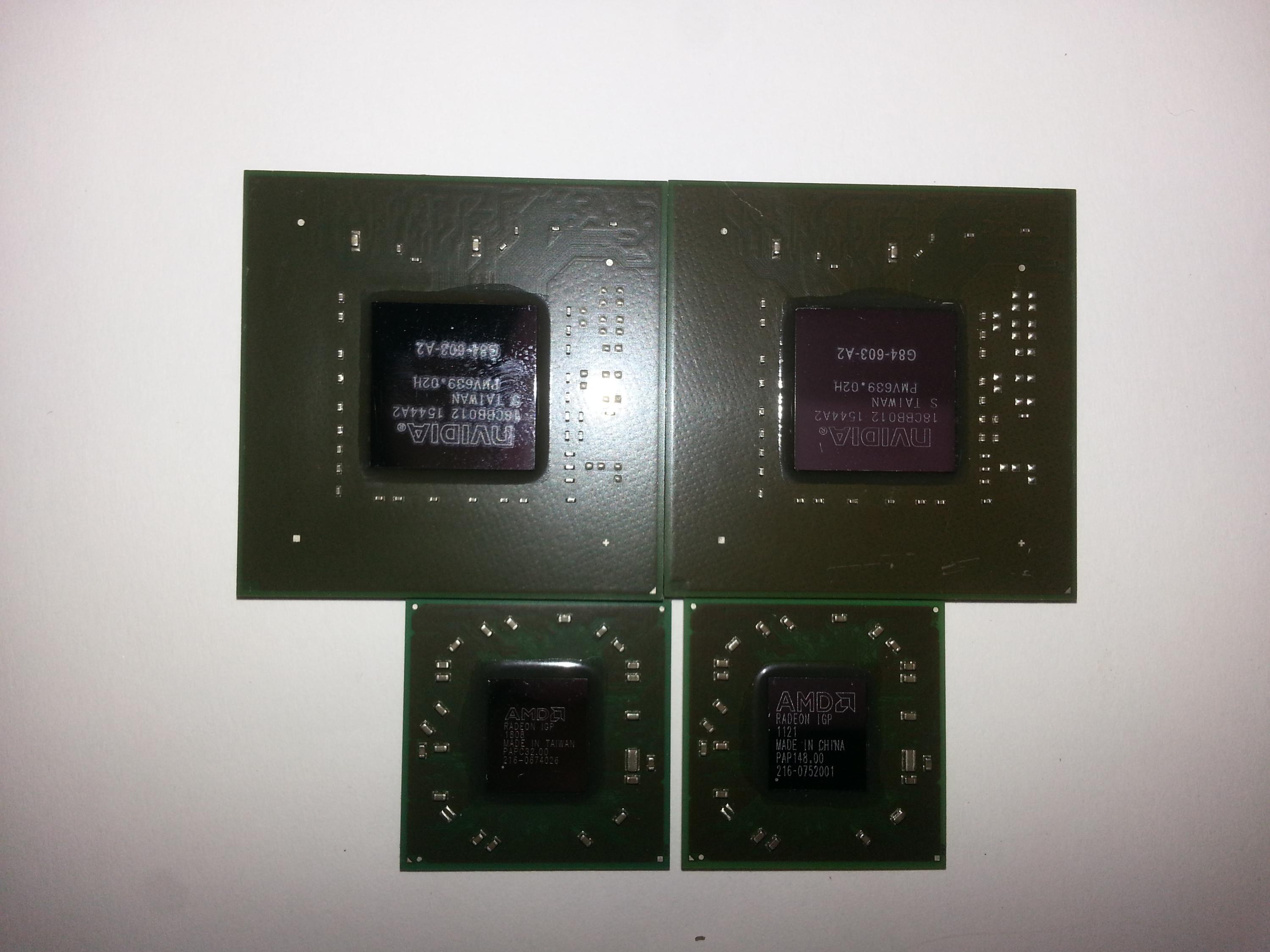

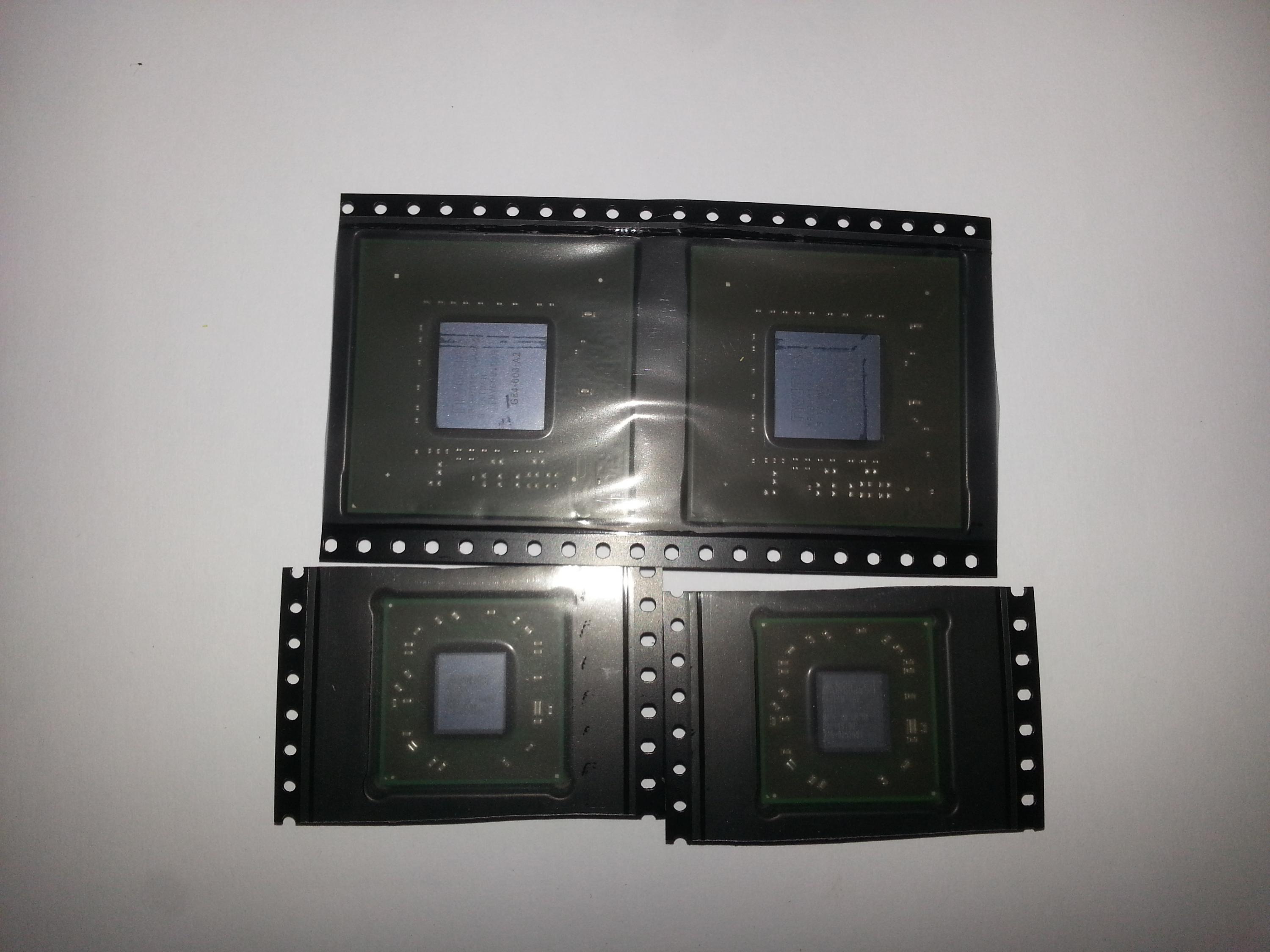

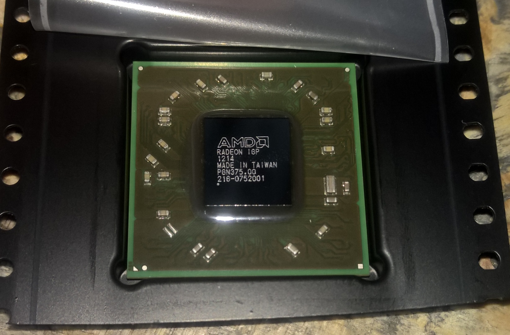

                                Ok so here we have a bunch of chips from see-ic.
                                The G84-603-A2 are crap. Black underfill, laser etched part number and they didn't work. Chime loop and no video on MBP 17" 2007/15" 2008
                                The 216-0752001 is good, HP 6545b back up and running fine.
                                The 216-0674026 is not shorted but the motherboard doesn't turn on. Maybe something else is wrong.
                                I didn't try the other but here are my observations: G86-770-A2 has white underfill, seems like an original new chip.
                                The NF-G6150-N-A2 are datecode 2009 but they have black underfill. Dunno if NVidia still produced those in 2009 with the bad underfill though (not the case for the G84 and G86 for sure).
                                The MCP67M-A2 doesn't have a fixed revision AFAIK, so black underfill is normal. Let's hope this is a new chip anyway and it will last at least a few years…

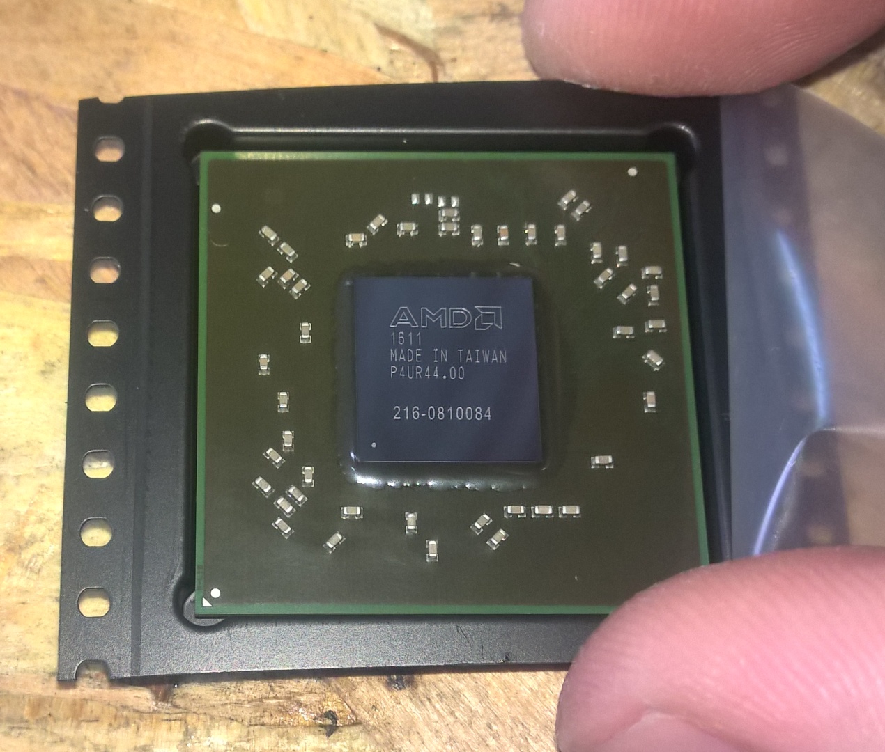

                                216-0809000 was a "refurbished" datecode 2017. Dunno if it's any good, probably not. Tried a 216-0809000 datecode 1607 from goldenchipset and it was crap (no internal display, garbage on external VGA). My stencil from oycc-ic is garbage and I've a hard time reballing those so I'm gonna order another one first.

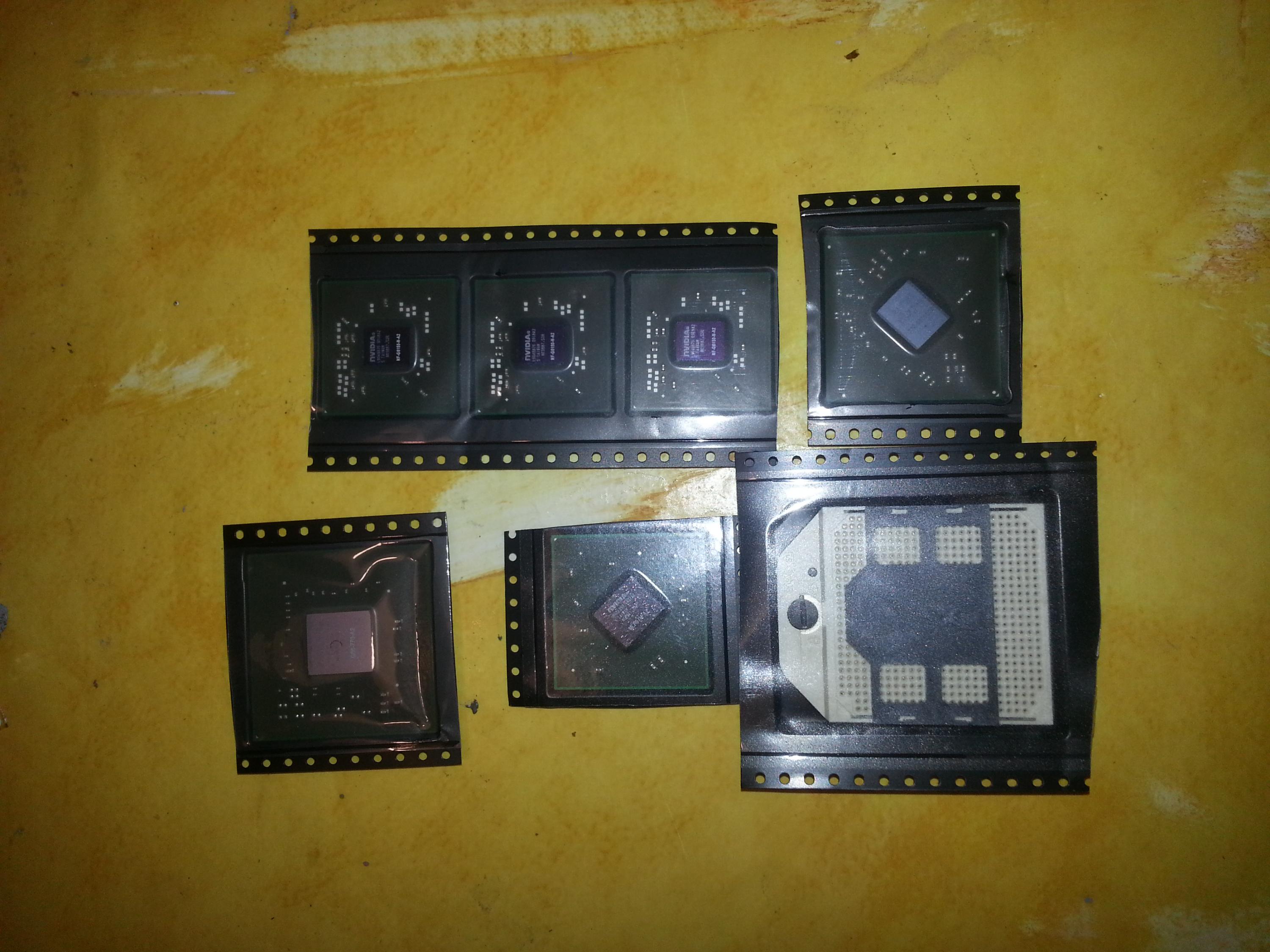

                                  Over the years, I bought some bga chips and I was not satisfied.
                                  I understood, by doing research, that there are no more honest sellers than others.
                                  This because there are no low cost and fast methods to test this type of chip. I prefer to buy non-working motherboards, even if I do not need them, to have a stock of the main chips, especially cpu.
                                  I can do this because I have a small business.
                                  A friend of mine, who works very high quantities; uses very expensive sockets to test the chips before welding.
                                  "If I have to buy bga chips, I ask these questions first to see if they are really new:
                                  If I buy more than one bga of the same type, is it possible to have them in the original package without dividing them? have the same datacode and progressive serial number?
                                  Is there a possibility to change them if they have not been soldered ? "
                                  In most cases, sellers are not able to provide chips under these conditions.
                                  I tried to buy in other countries, Spain, UK, but all the chips come from China and that is the reference market.
                                  However, I don't immediately solder the bga, I first inspect them under a microscope to see if there are signs of reworking and with a multimeter I check the main signals, if I detect a strage value or a short I ask for a refund that usually the seller accepts.

                                    Unfortunately for GPU you don't have this possibility. When you get a failed NVidia or AMD GPU, it has been properly cleaned and reballed and remarked (with newer datecodes for example). They very rarely fail short, and they often resurrect for a small amount of time when heated a lot. So you get a chip that you think is new, but it's an old failed reballed chip. You solder it on, it works for a couple of weeks then fail again.
                                    Only way to not get scammed is to know the signs of "refurbished" chips, but sometimes they are very hard to detect, and buy from a trusted seller (well… none of them are). When inspecting under microscope, if you see some marks especially scratches around capacitors (seller probing them to find shorts, because they know people will check and fill a claim), or if the substrate color is off, or if the balls are not consistent, markings on the die not looking new, different datecodes in the same spool, etc… you know that it's a bad chip. But even then some are very well done.

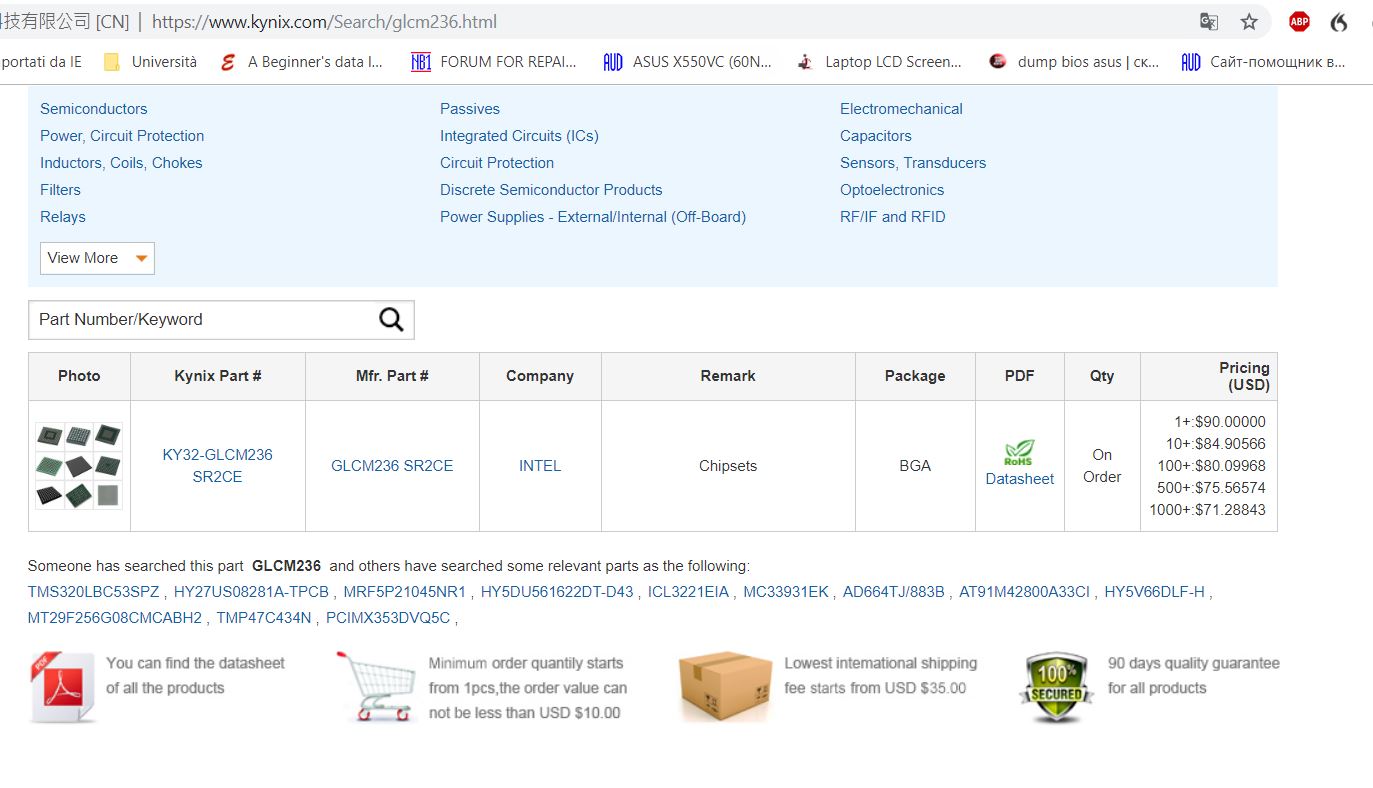

                                        I try to buy directly from manifacture (intel-kinix) an intel CM236.
                                        The price is very hight compared from usual chinese market (25 USD for new and very strange 22 for used USD).
                                        To be honest, I would never spend such a high price, but in this case it is an Asus Rog and a use motherboard with a three monts warranty costs about 470 USD, (in China but I know very well the vendor so a return is not aproblem) so I would like to be sure that the chip is working, if it goes wrong it is only my fault but perhaps an attempt should be made

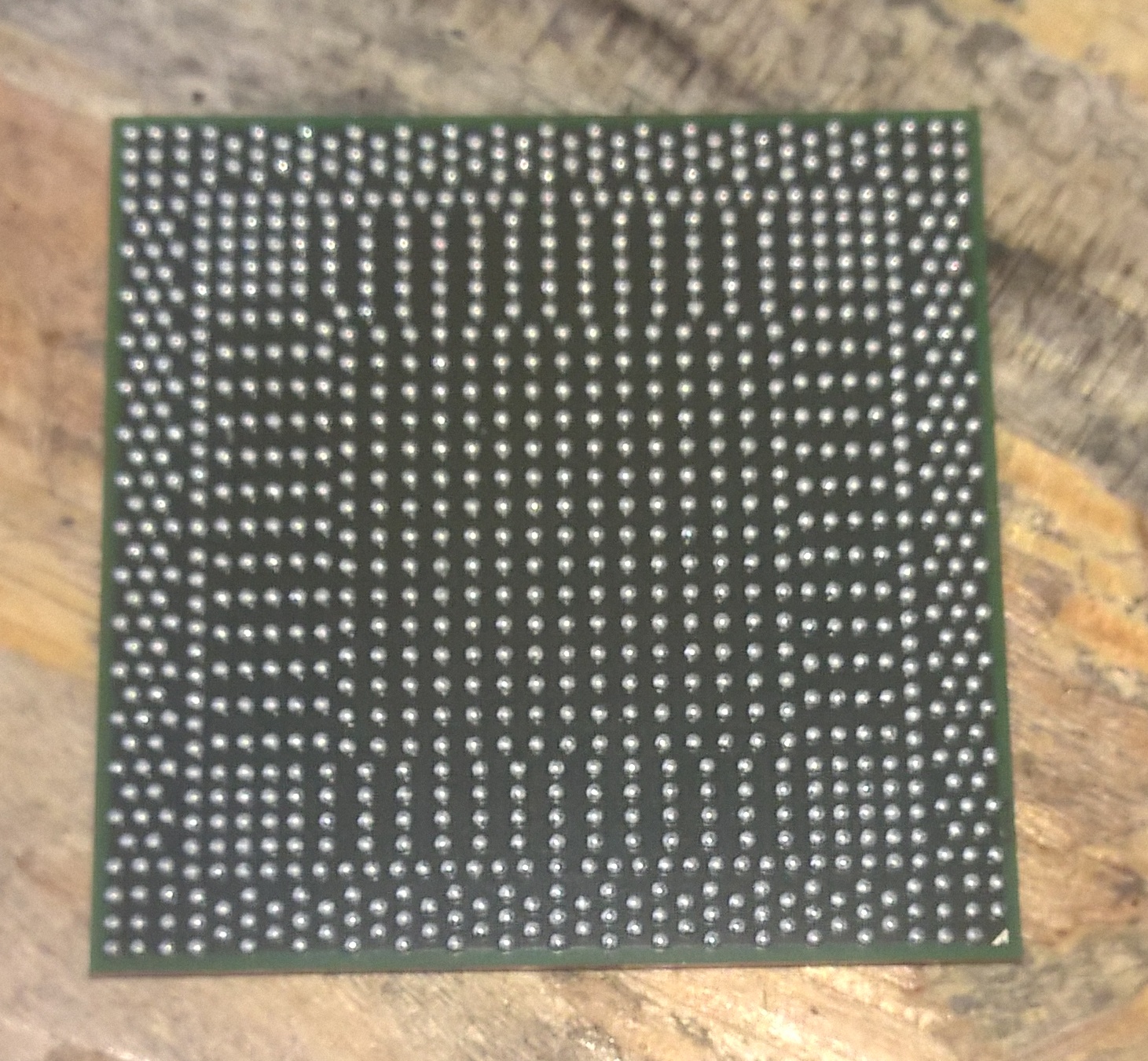

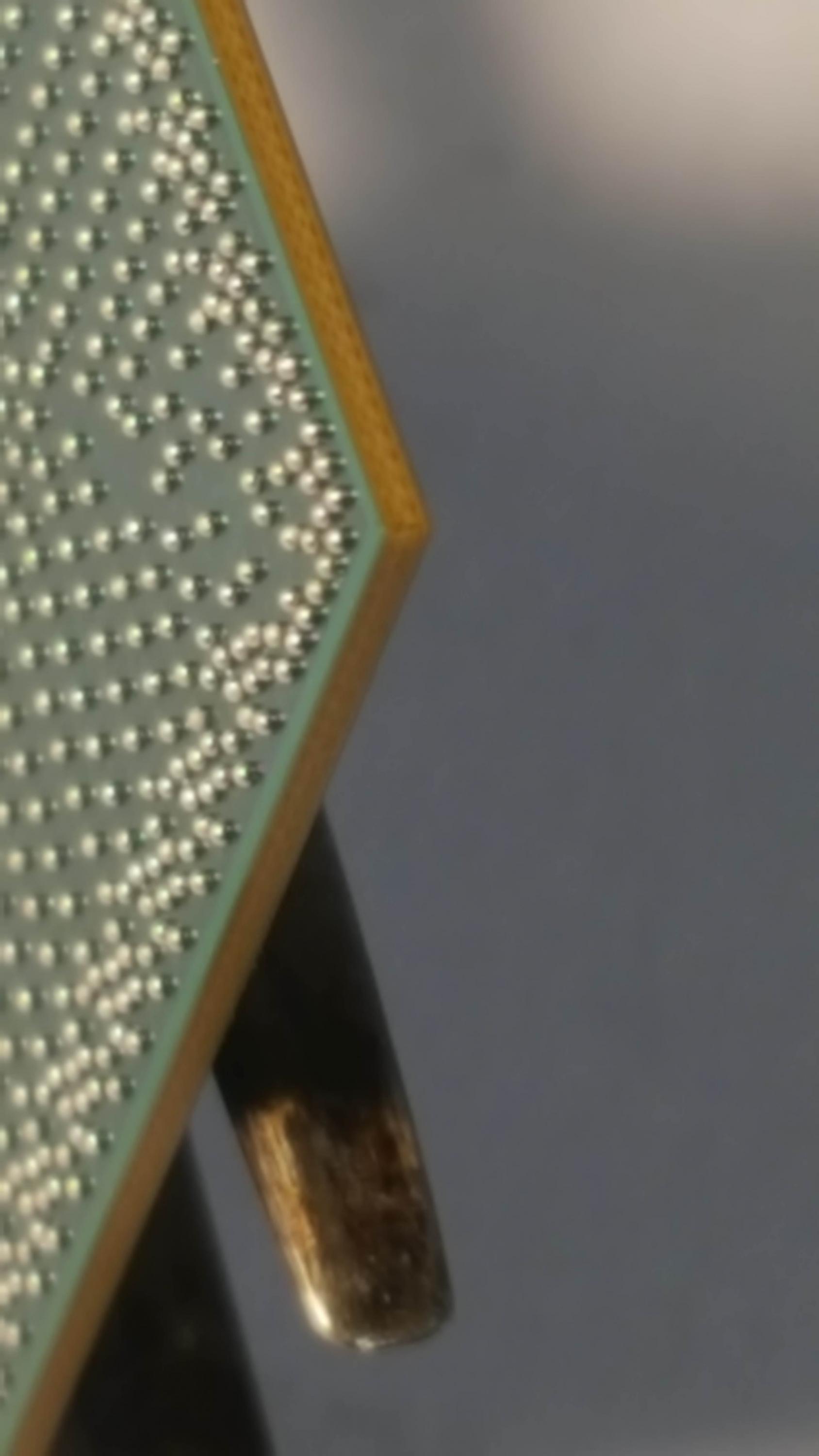

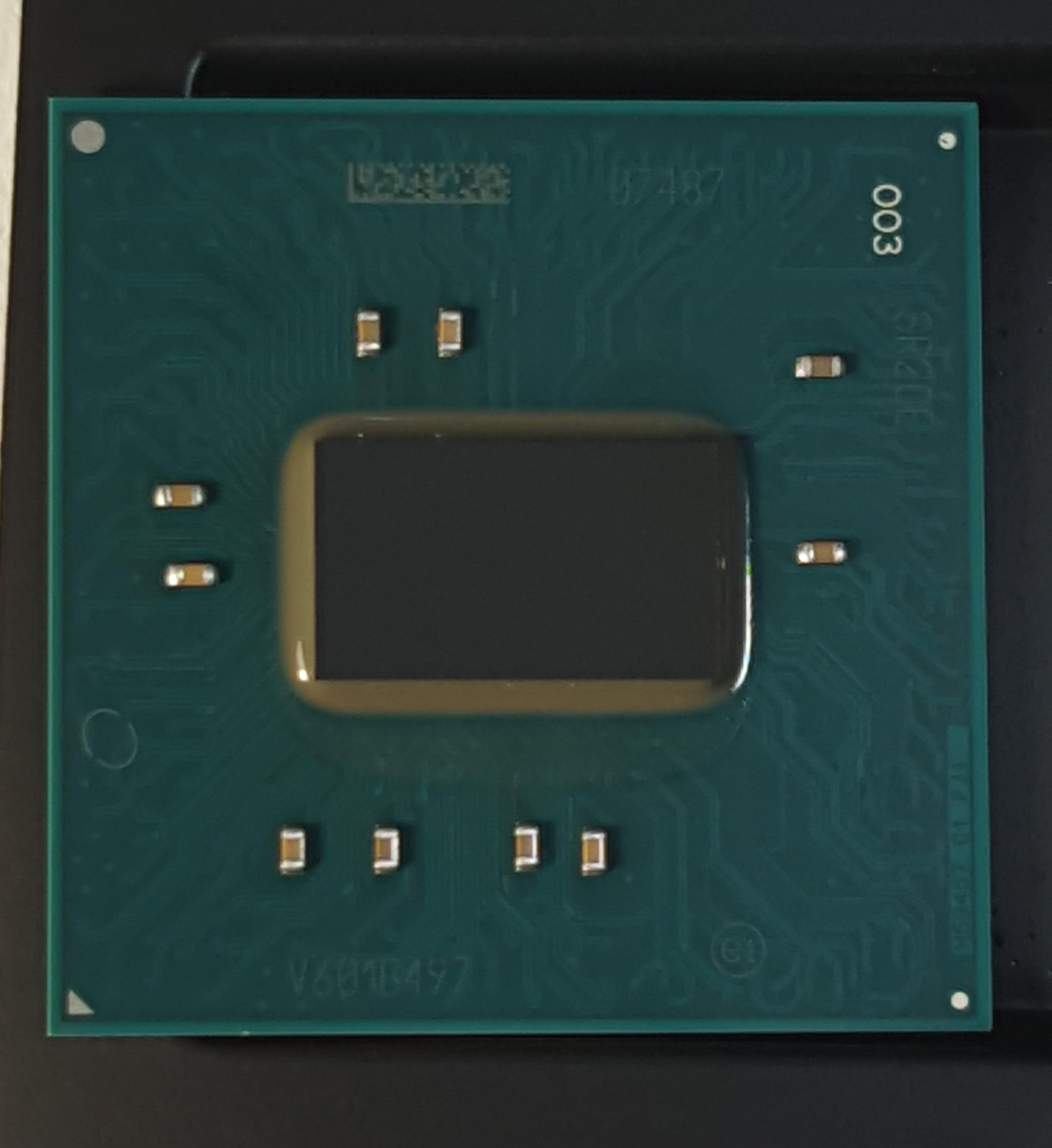

                                          I bought this chip on ebay from a German seller. The cost is 25 euros.
                                          As you can see from the photos it looks new or reworked very well. The only doubt is the color of the border, perhaps too yellow and dark.
                                          I solder it and see if it works.
