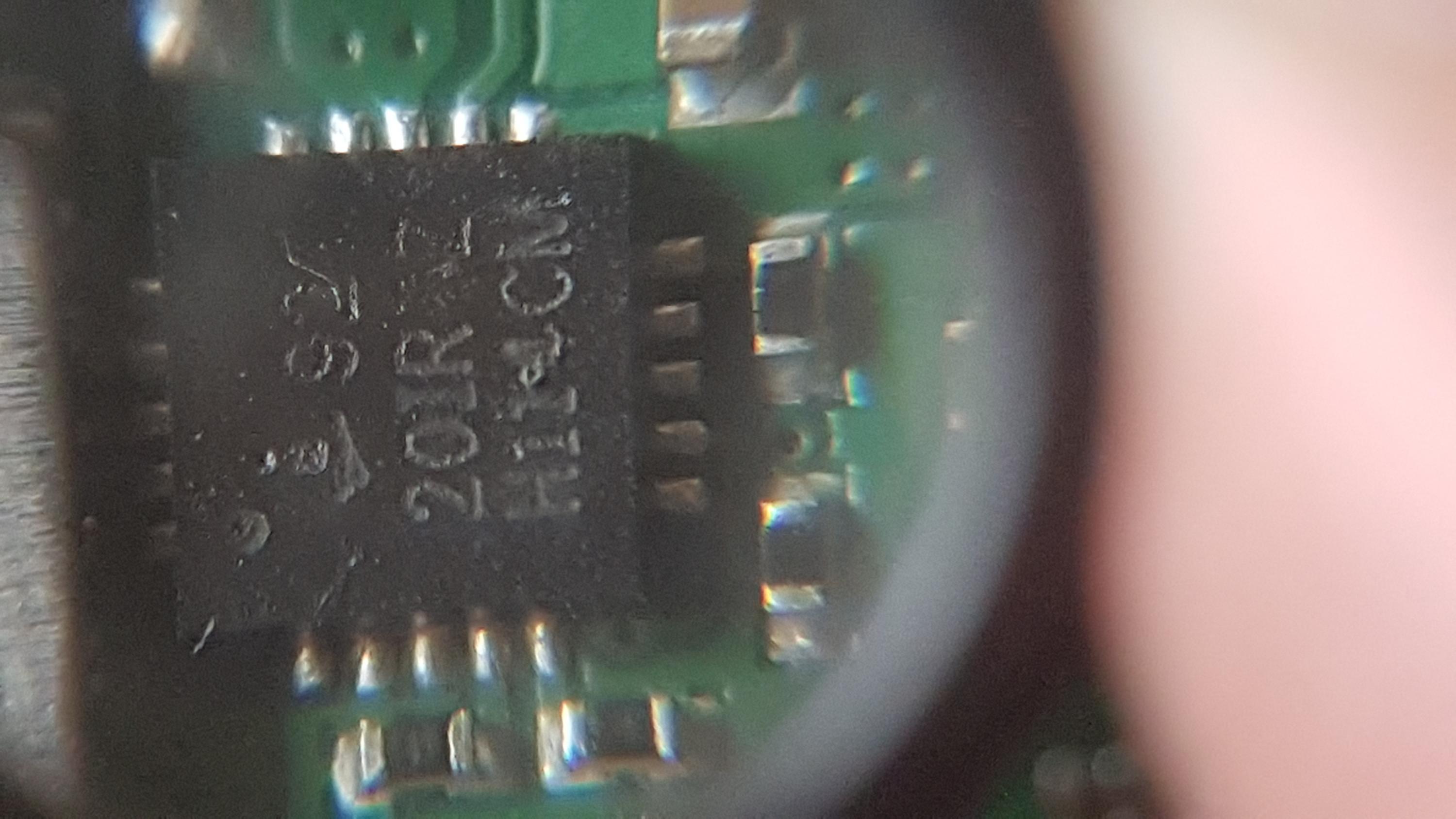

    The voltage is 5v 2amp output from specs.
    I have a tab that has green light on but don't turn on due to battery not charging so i setted on dc power supply to 5v max 2amps and connected the gnd to ground and red to + of the battery on the pcb board(battery disconnected) now when i turn the dc power supply on i can se voltage drop and current increase and i feel parts heating up.
    The part that is heating up is that the main issue to whole problem if i changed that will it fix it.

    yes, you are on the right track. Whether replacing the hot pars will solve it or not-that you can verify once you replace the parts. There can be multiple parts which might have failed.

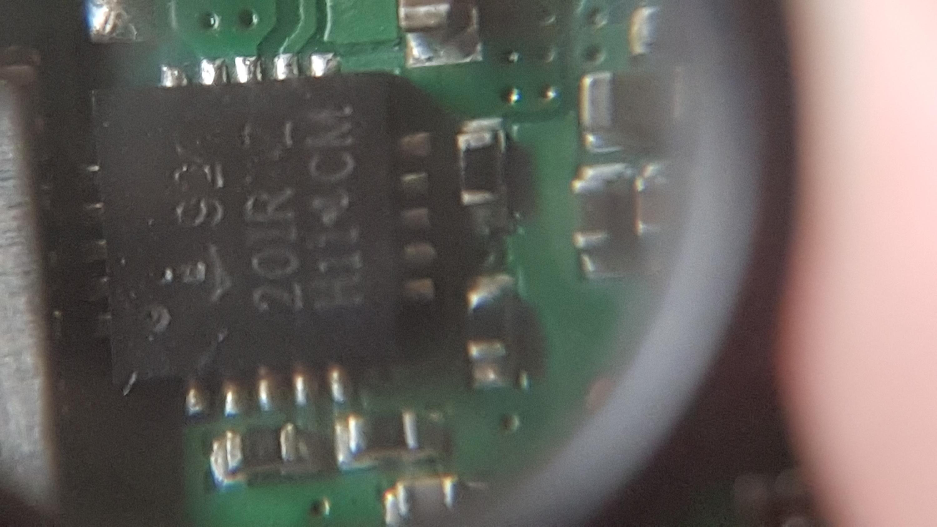

            It's the same tablet also too I'm guessing. Why not show the area where the ic was removed to help identify it.

              for ordering parts always try and order what the part number is on the old ic etc, you cant use any ic just because it fits, if your not sure post the part details with a picture then usually we can then help you source a new part.

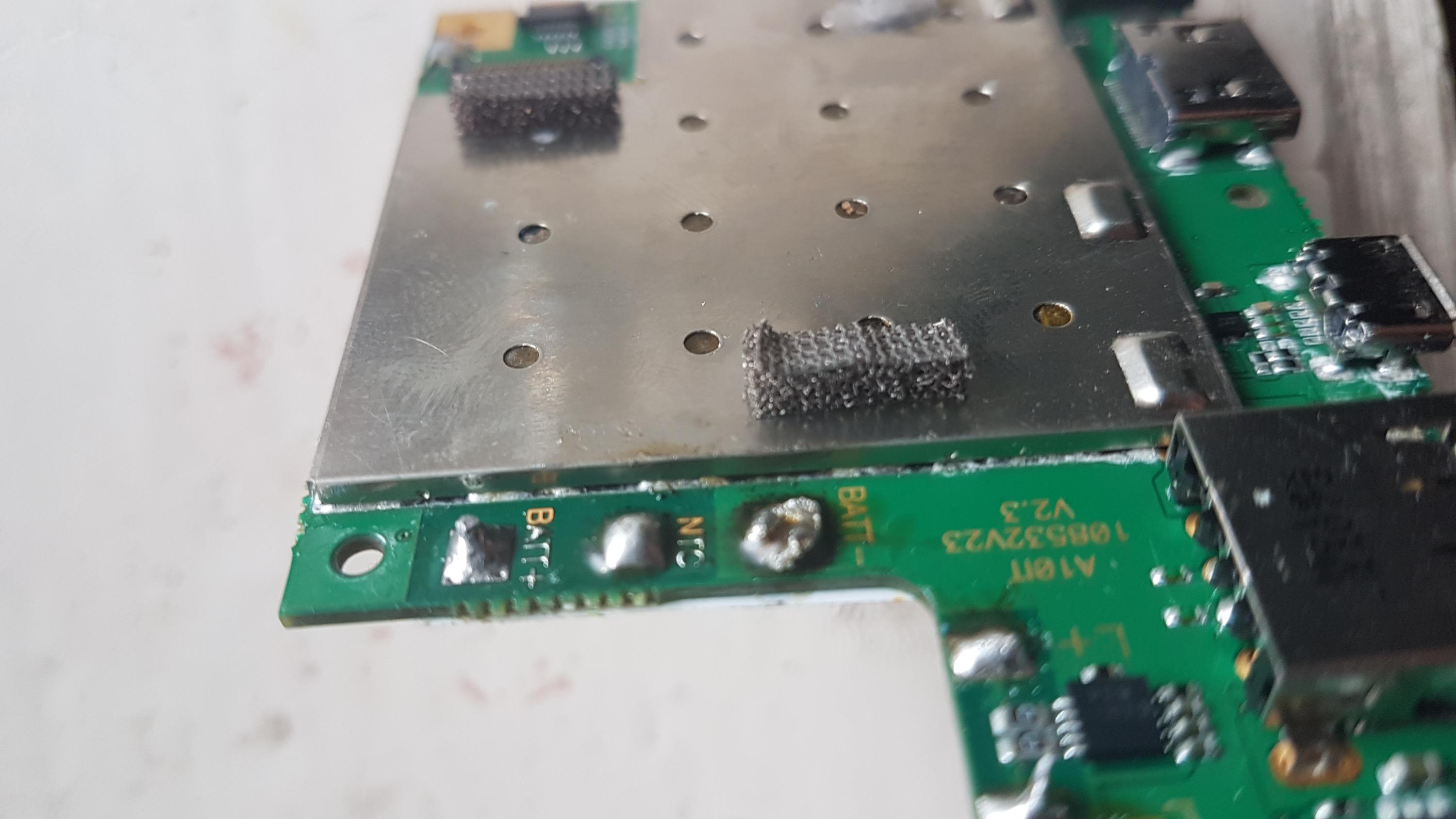

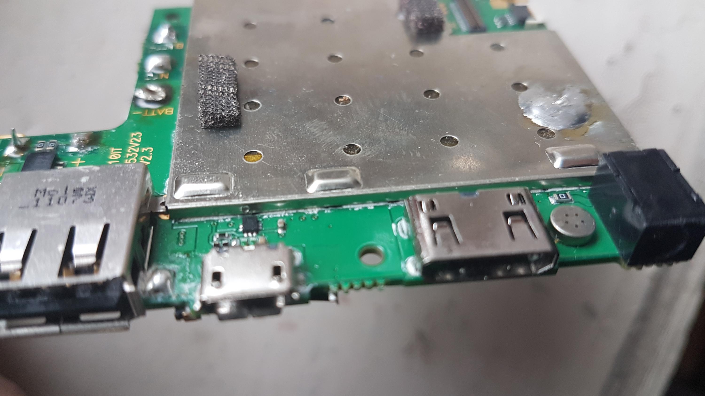

                  I have de-solder station was wondering what is the best way to take this off without damaging components as it is soldered all sides.
                    Re: Question about finding short using dc power supply
                    what part is it your trying too remove? the heat shield or one of the ports etc

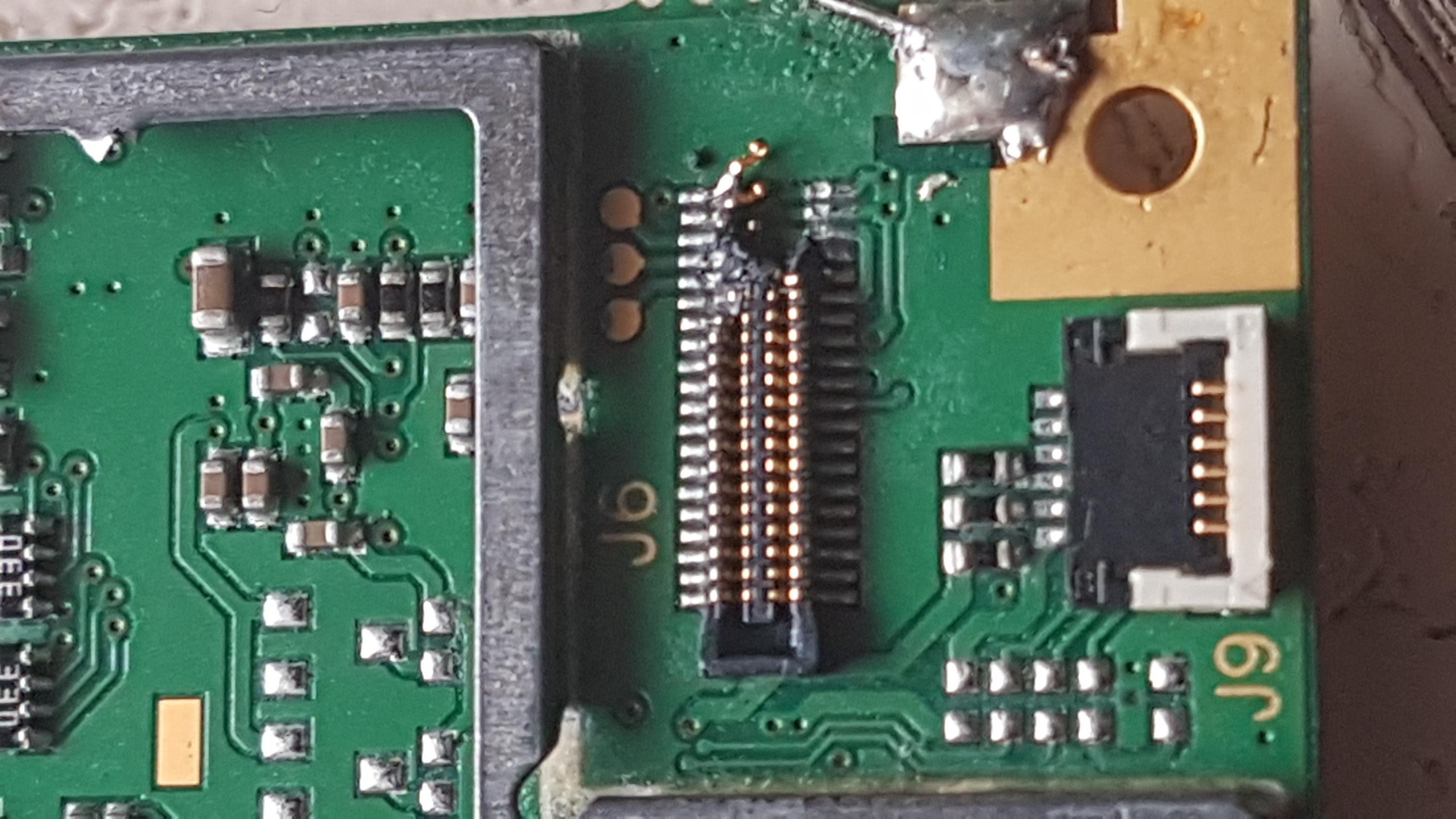

                      I tool the shield of i noticed the port is defect and may need a replacement can you help find this part
                        what make/model is the tablet i would search on https://www.aliexpress.com/?spm=a2g0...00002.1.cZwafk

                          Archos 101 internet tablet
                            Is that it
                            https://m.ebay.com/itm/5pc-40-Pin-FP...wAAOSwstxVUjc0

                              no dose not look like it as the center ridge bit is missing

                                Am looking for it on ebay as i dont use ali express takes long time delivery. Plz help ebay

                                  ebay does not sell all items especially parts like this hence me saying try aliexpress lately parts are taking just over two weeks to arrive from them.

                                    Ok np please find 2 things for me on ali express.
                                    92
                                    201rt2 or 20irt2 h114cm ic
                                    And that fpc connector
