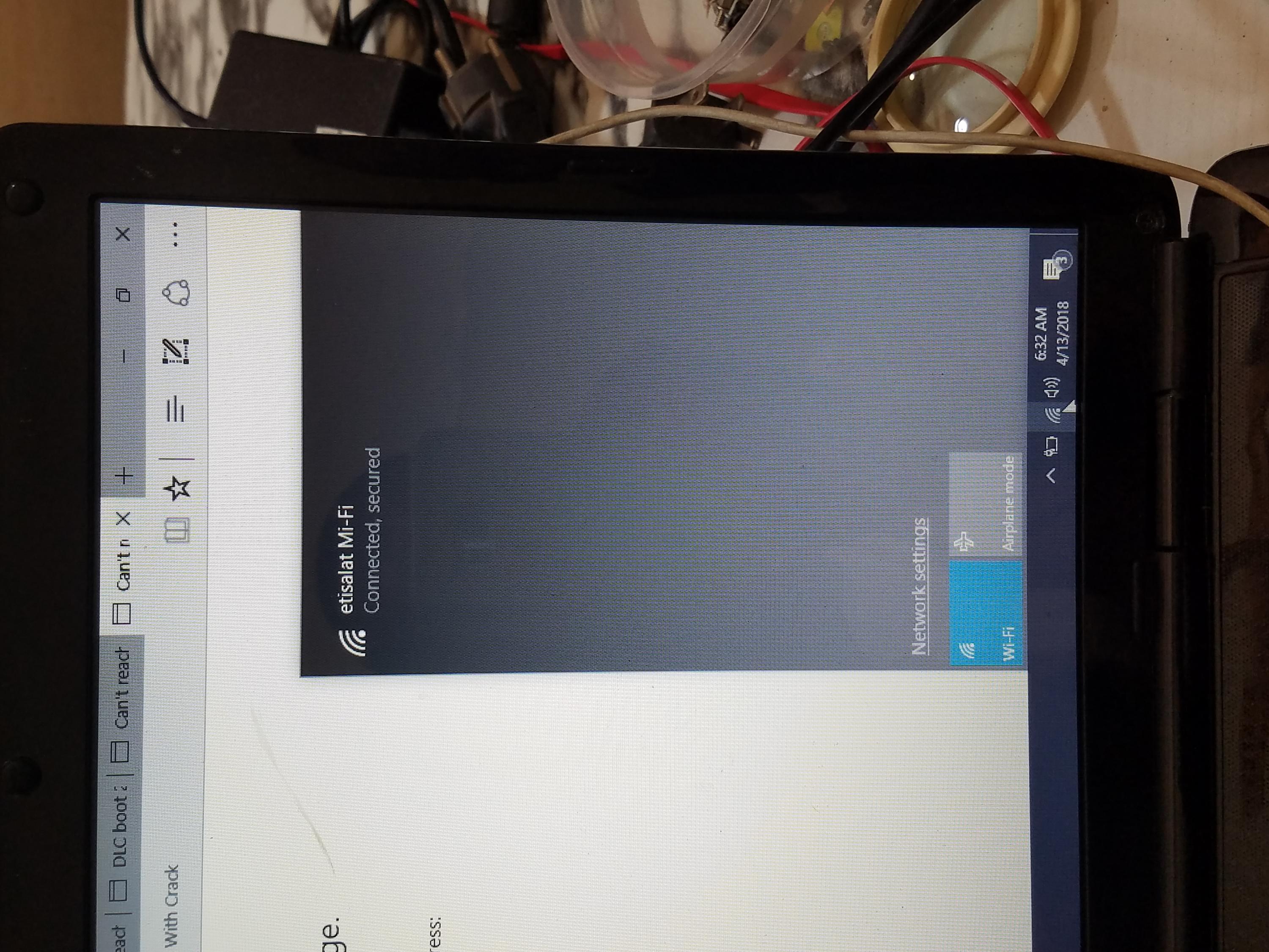

    This is worrisome , my inspirion 1545 has full WiFi connection but I cannot surf the net with it, I reload the with different OS no luck, change WiFi card, use dell assistant tool, no luck can someone help me out pls

      Re: Dell inspiripon 1545 WiFi cannot browse
      Set the date and time of the computer from the BIOS settings.
      The problem is not in the Wi-Fi card.
      Replace the battery cmos

        Thanks for reply, the time in bios is correct but let me change the change the close and feed u back
          try ipconfig command
            Check your IP address and your firewall

              Thanks for reply, have put the firewall off, changed cmos battery, problem persist it will just browse 2-3 hrs and show no Internet secured

                All the option given didn't surf my problem, so I decided to reload the OS and redrive it, after the it browse for some minute and stop again. Pls I need perfect solution to this dell WiFi issue
                  Have you tried with another laptop on your MiFi ? I've seen similar devices needing a restart after long periods of use.
                    log into MiFi and check settings .. ip something like 198.192.1.1 .. see if it stays logged in after wifi stops .
                      another thing to try is use your phone as a hotspot and connect to that instead of mifi
                        plus you flush the dns to see if that helps ..cant harm nothing trying
                          This looks more like a bad wifi receiver. I had a laptop that acted similar, and the tracert and/or the ping utility, reported packet loss! (IIRC)
                          The wifi card may have a bad solder joint or a bad cap...
                            With this problem persist
                              Ji have Try 2 Different Working Card,But Problem Persist
