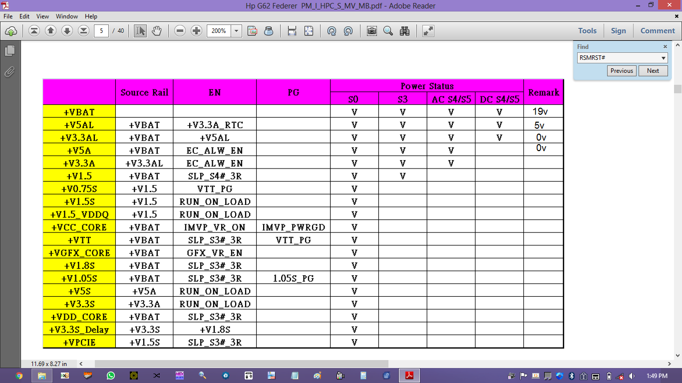

    See if this schematic matches your board. If so, page 5 shows the power sequence. The steps are numbered in red. Measure each signal/rail in order until you find something that doesn't seem right. And then measure some more. Then post it all here.
      Re: hp g62-a46se cannot power on
      Bios chip is powered by +V3.3S from +V3.3A via PQ763
      +V3.3A is from +V3.3AL via PQ2
      +V3.3AL is enabled by EC_ALW_EN from EC
      +V3.3S is enabled by SLP_S3#_3R from MCH

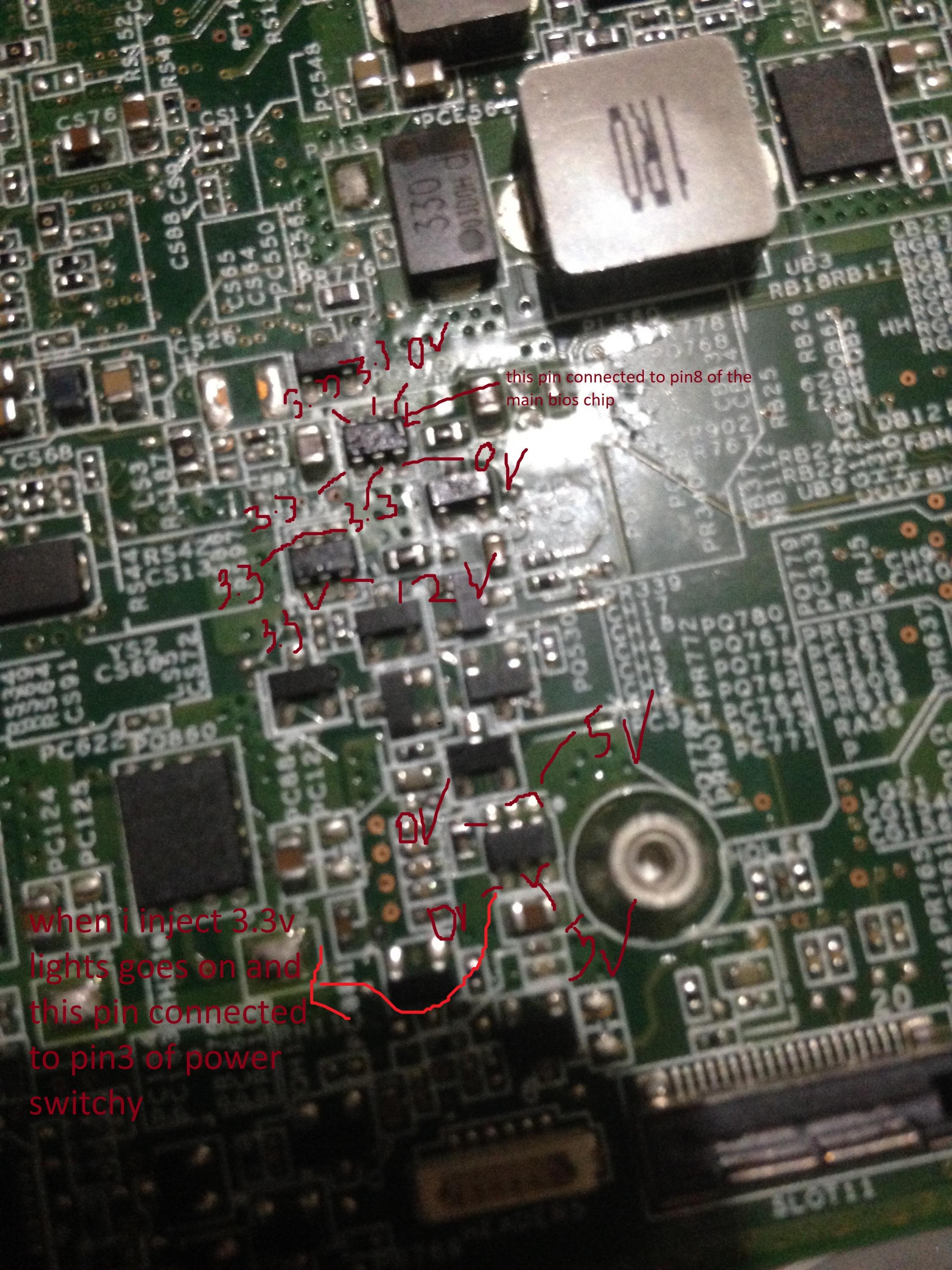

        thanks for the response and schematic meritosari but i checked on the pins of the power switch 3.3v is present but no voltages on the main bios chip.where should i check next please

            Measure the voltages on PQ762.

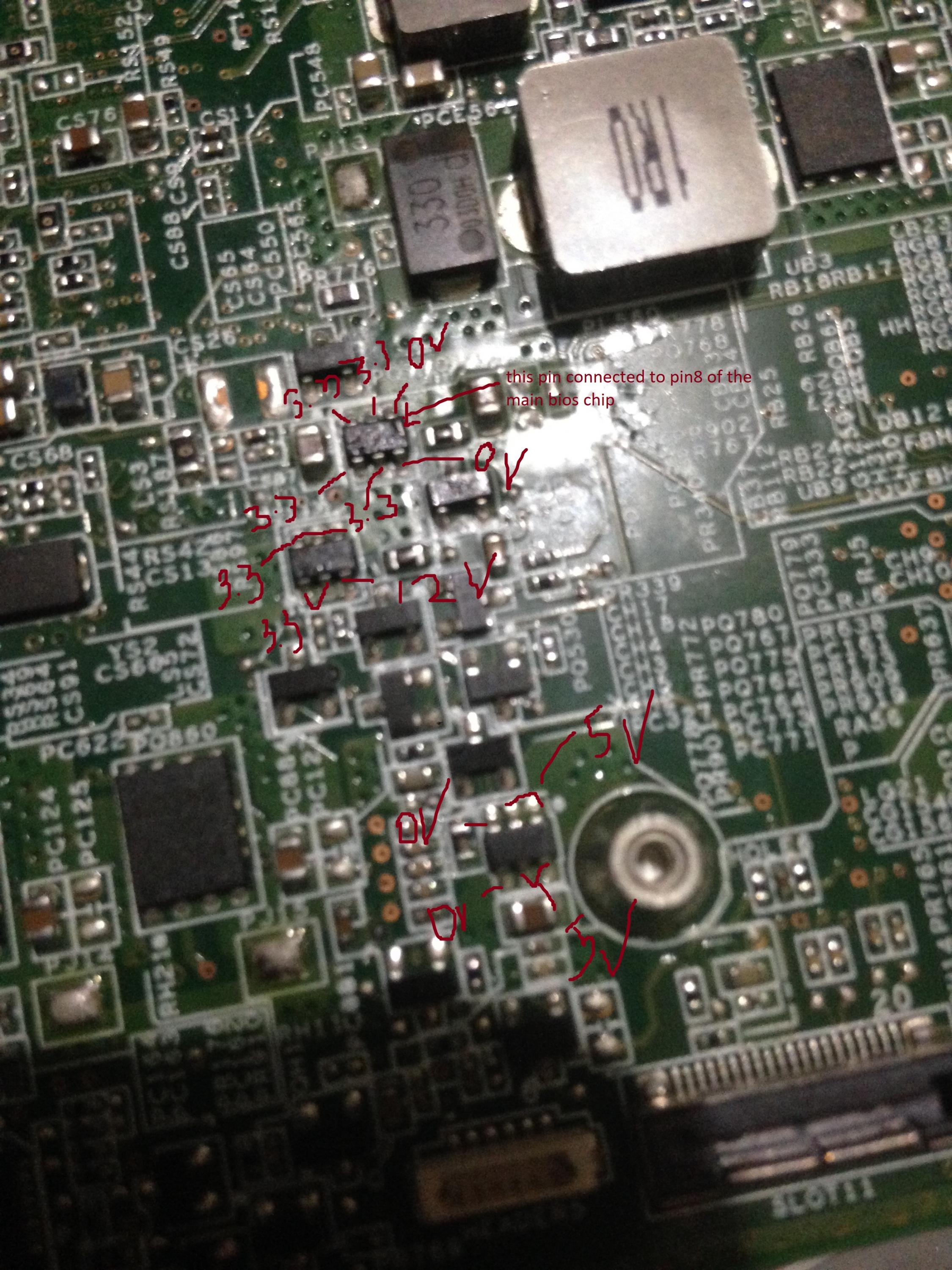

              Thanks for the response jarotech I have attached the image and measurement of the chip, I dont know which is the PQ762

                PQ762 is a 6-pin chip, you have three similar ones next to the SD card connector.
                  thanks for the response jarotech already uploaded the image and measurements i dont know which is the pq762

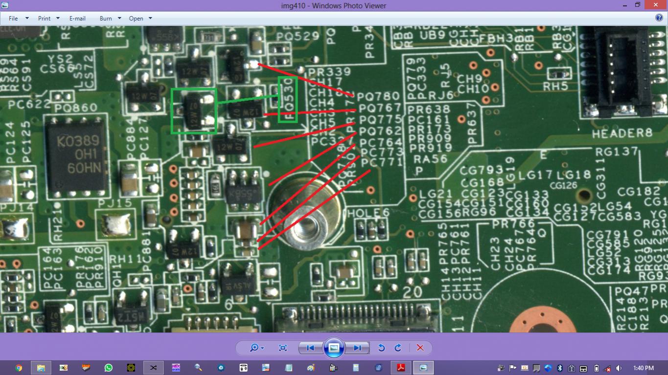

                        @meritosari i did not answer because some of the components i cannot find on the board.i have attached the image of pq762

                          Seems like "run_on_load" is 0V
                          Measure voltage on PQ779 (is 3 pin transistor,located on right top of white socket in photo) and PR765
                          Better look at photo

                              thanks for the schematic and boardview PR765=10K ohms and PQ779 pin1 D=0V pin2 S=12.2V and pin3 G=12V. I noticed also that pq762 pin5 when touch by probe power led goes on and its connected to pin3 on the power switch and also checked PQ780 no voltage

                                Check on PQ778 while pressing power
                                But I think "SLP_S3#_3R" is missing.

                                    When press power if PQ778 drops to 0 then in that time "run_on_load" must be around 10V
                                    As result in that time +V5S,+V3.3S and +V1.5_VDDQ are present.
                                    Check if are or not.
