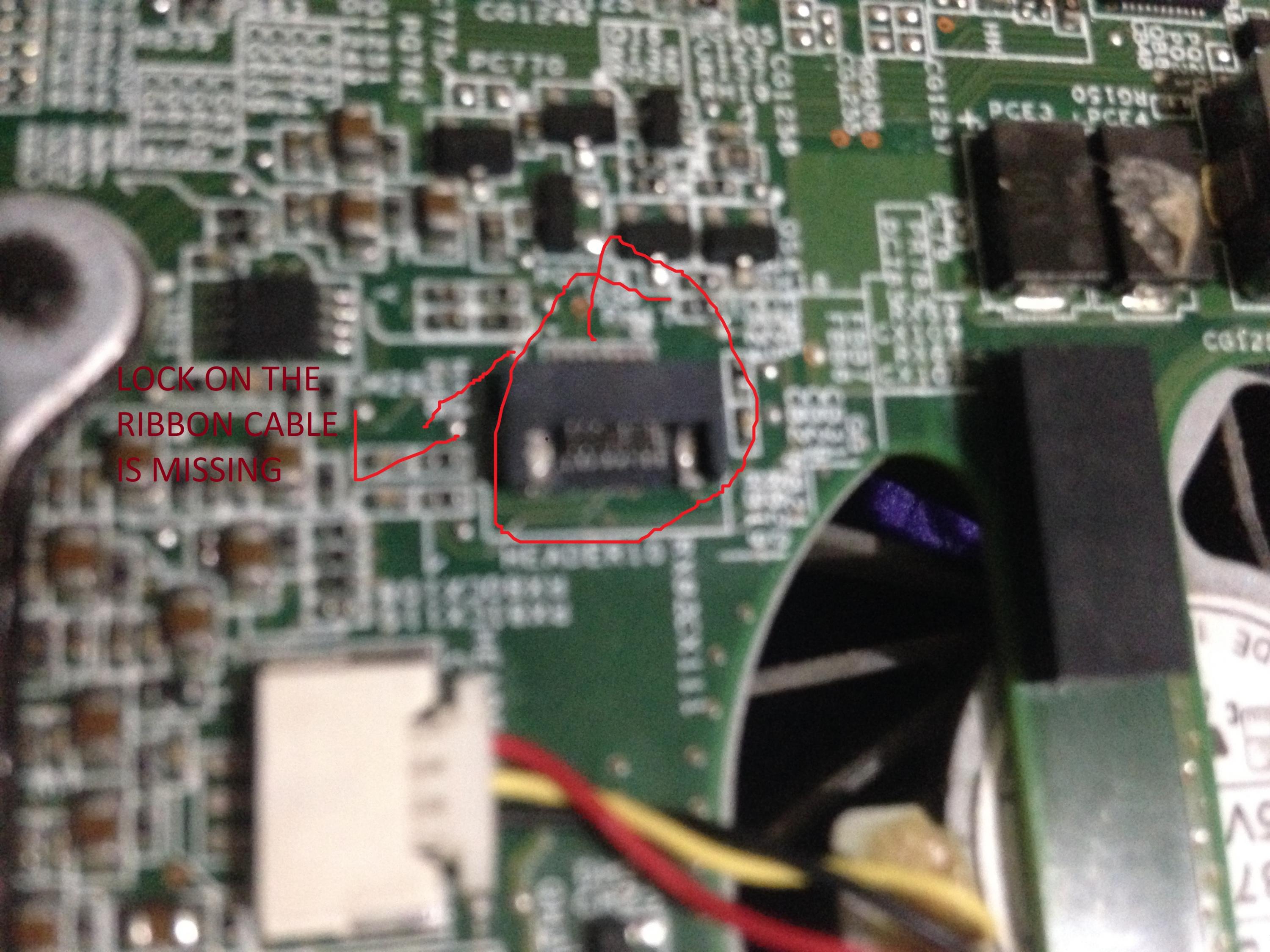

                        #51
                        Re: hp g62-a46se cannot power on
                        yes on the motherboard the the plastic lock for the ribbon cable is missing and power button ribbon also is broken
                          #52
                          You can replace the ribbon with a new one, the ribbon connector will be harder to find without a part number. If you are good at soldering, you can still solder the ribbon directly to the motherboard.

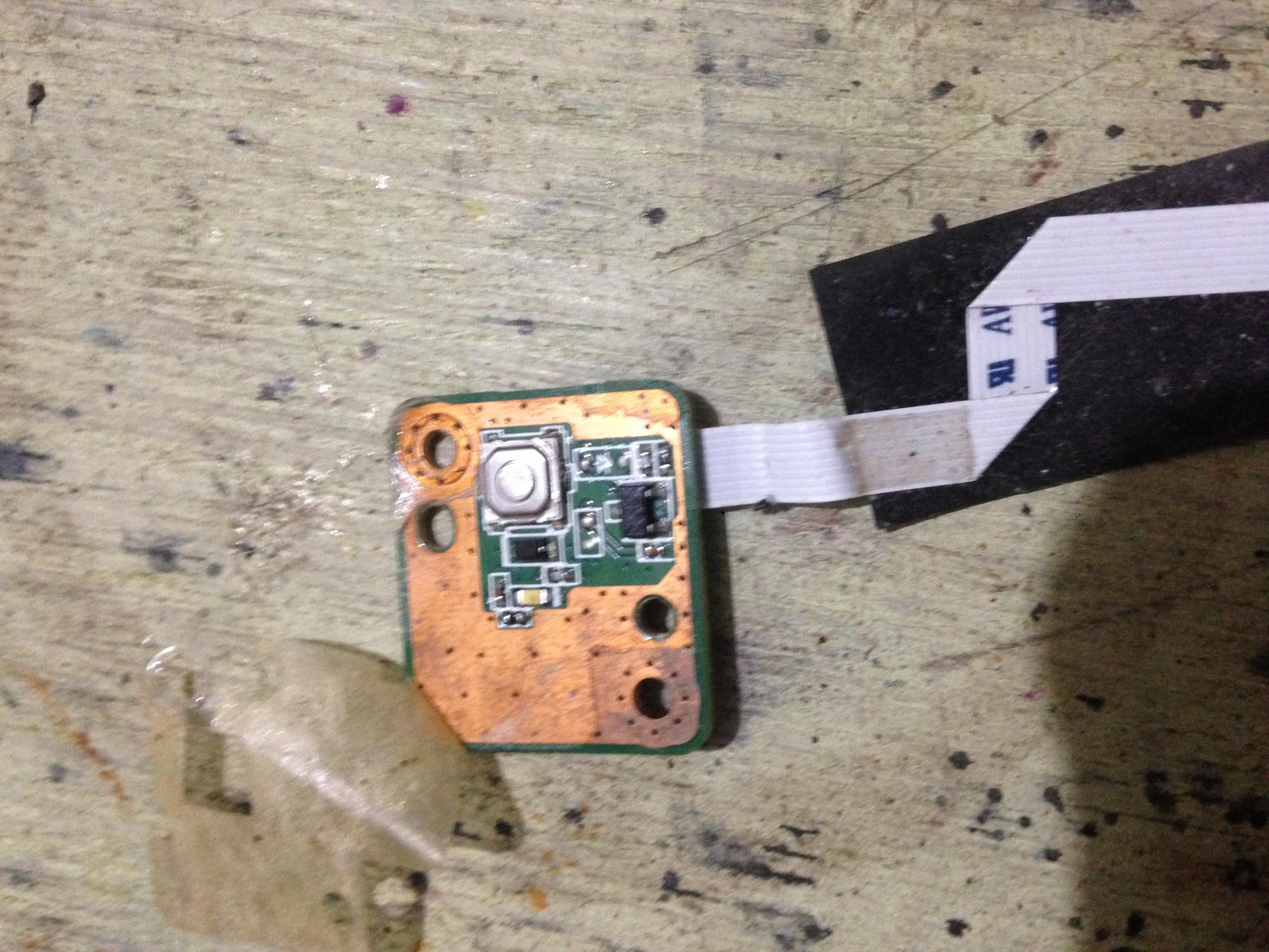

                                #55
                                Thanks again for the response how could i connect pin6 on the switch board to power button board in order to make it work?i have attached the image on the power button board
                                  #56
                                  As I said before, you can solder the ribbon cable directly to the motherboard, I do not see the end of the ribbon.
                                    #57
                                    im not good in soldering skills.in the picture that is not the original ribbon cable that is i got from another hp g6 laptop because original ribbon cable is completely broken.is there a way to make a jumper wire for this?
                                      #58
                                      Is the power connector on the other motherboard good?
                                        #59
                                        yes its good i put it on ohms mode connect ground and positive when i press the button it response.i think power button is good
                                          #60
                                          I am referring to the other motherboard you took the power button board, the connector on the other motherboard is it good, if so, you can use this connector on the motherboard that you are repairing.
