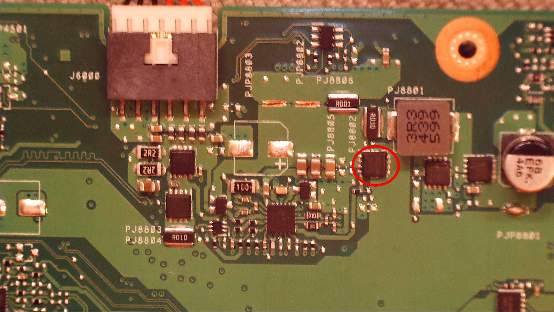

    Asus X751LD no Power
    I have no Power no LED´s
    There are 19V before first fet but no voltage (swapping between 100mV and 200mV) on Gate.
    Checked the two dc-in fets with multimeter from Drain to Source and it seems all ok.

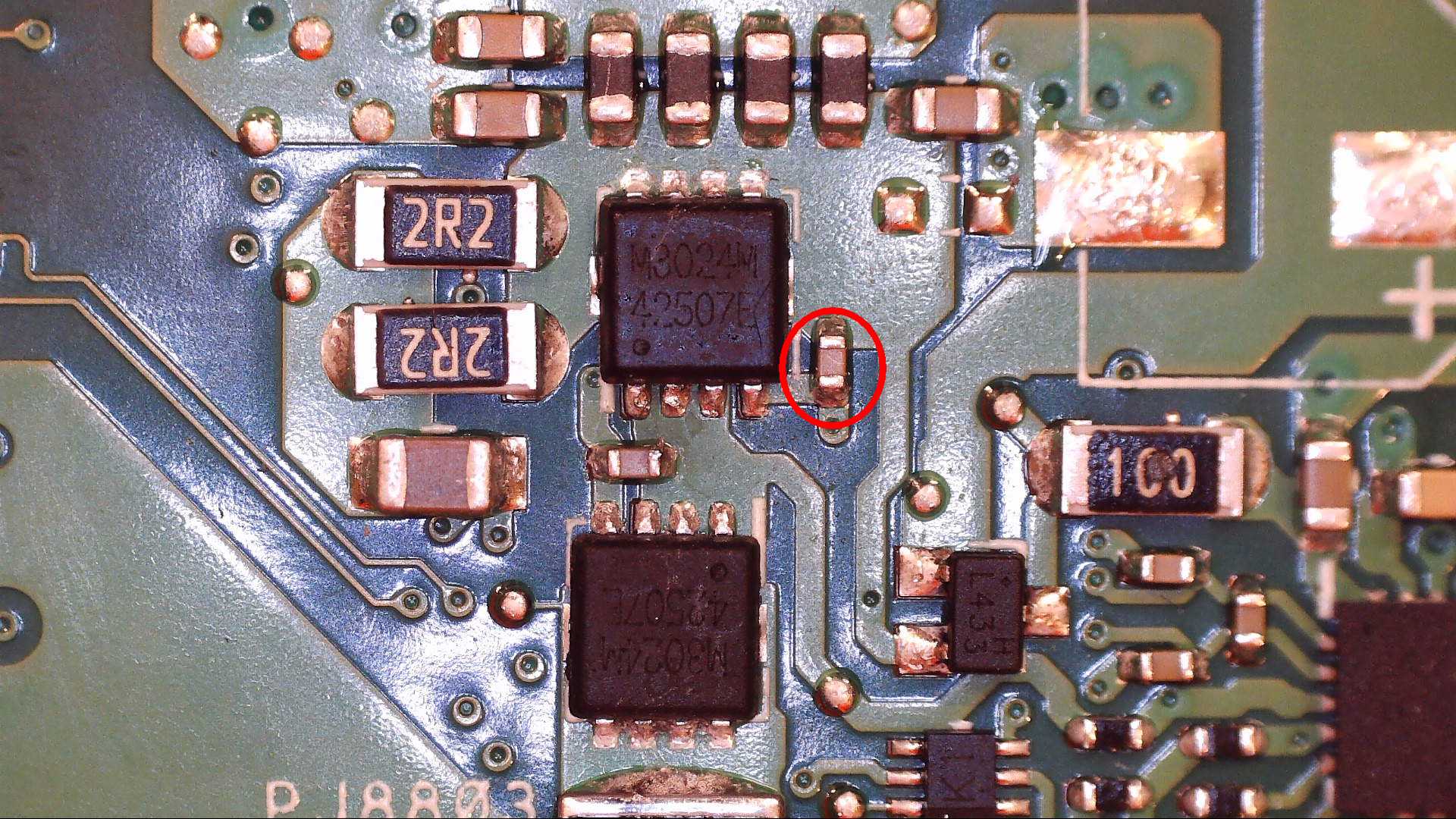

    But the fet on the second picture has 30 Kohms in one way and 250 kohms in the other... Is this one shorted?
    How can I check the capacitor marked in picture?
    On bq24735 I have 18V? on VCC, 6V on REGN and 2.6V on ACDET.
    Got 0.4 V on several pins for battery?
    Or is it some other problem?

      Re: Asus X751LD no Power
      The capacitor must not be shorted and that's all.
      Also check gate-drain and gate-source on both MOSFET (next to the circled capacitor).
      The MOSFET circled in the second picture is for working on battery voltage, doesn't matter here, several kiloohms is not a short.
      On the other hand we can clearly see a burnt mark on resistor marked 100 right next to the circled capacitor. Check the resistance across its leads, but I guess it will need to be replaced.
        Yes, you are right... The resistor need to be replaced. I measured 2 kohms not 10 ohms.
        I also tested gate-drain and gate-source on both Mosfets... I´m not sure about the second one... I will replace it as soon as possible and post the results here.
        Thanks first for the quick reply
          Check that 10 ohm resistor, it suplies the chrg chip, resistor its blown due a short after it
