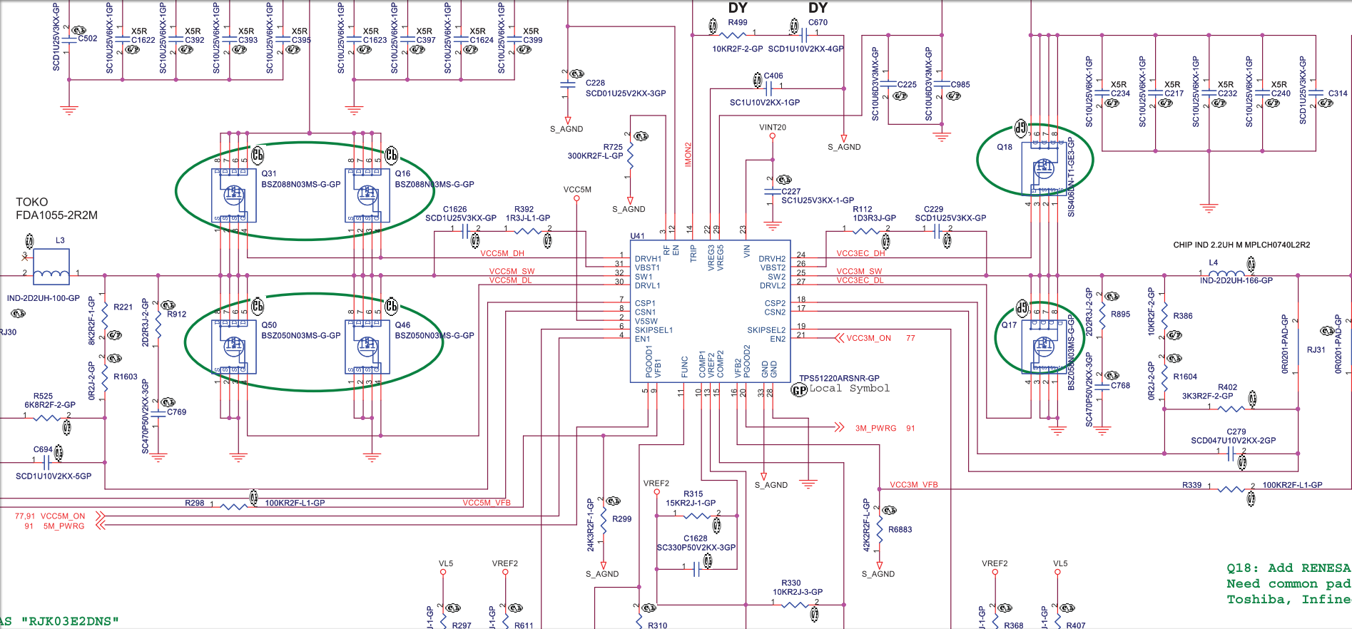

    This laptop does not power on, not charging light.
    Check list:
    Charger - OK
    Fuse F2 - Ok
    Q9 FET - OK
    Q36 FET - Ok
    R380 - Ok
    I am not sure how to check 3.3v and 5v power regulator.
    I have 20v on VIN (PIN 23)
    I have 3.3v on VREG3 (PIN 22)
    I have 5v on VREG5 (PIN 29)
    I have 20v on Q18 (PIN 5,6,7,8), No voltage/signal on gate (PIN4)
    what else do I check? How do I check any 3.3v and 5v power regulator IC?

    No power on coils L4 and L3
    • caspian
      • Oct 2015
      • 1589
      • Laptop
      Re: Lenovo T420S power problem - help needed, thanks
      measure pin 4 and 21.
      • atsio
        • Oct 2013
        • 819
        • Greece
        Measure resistance relative to ground on L3 and L4 without power.
        • iplaypty
          • Aug 2017
          • 47
          • FLORIDA
          0L
          not short.

            do as caspian wrote

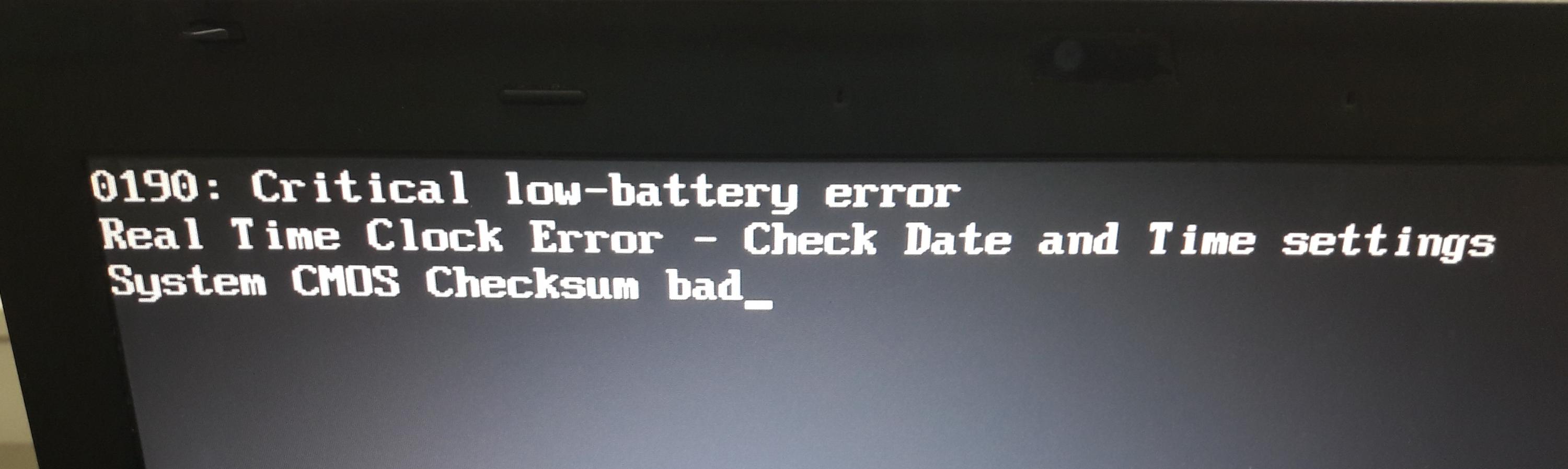

              I put everything together, now it tries to boot but, I get error 0190 (Critical low-battery error) when i try boot.
              Doesn't boot with battery pack. Tries to boot without battery pack but i get error 0190.
              Does not charge (no charging light)

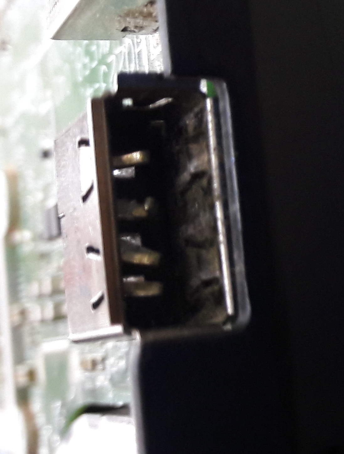

                Found a shorted USB port. Fixed that.
                Now I get 3 errors trying to boot, without battery pack. Attacked photo.
                0190: Critical low-battery error
                Real Time Clock Error - Check date and Time settings
                System CMOS Checksum bad_
                When the battery is in place it won't boot, the power light turns on and off immediately.
