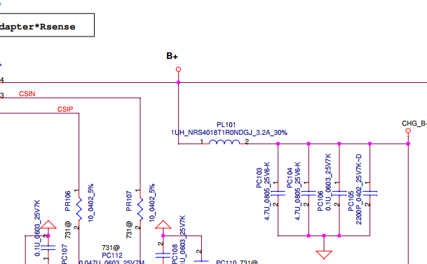

      Found our culprit (or one of them at least!)
      I noticed a small 'nick' in one of the ceramic caps connected to PL101, see pic (it was less obvious without the flash... I swear!), with a bit of debris stuck to the side of it... I thought maybe it was accidental damage from constant testing of the board, so I tried the 9V battery across B+ a final time and touched it... lovely capacitor mark burned into my finger
      I believe it is either PC103 or PC104 shorted as they are the two capacitors in that particular group with the same size and rating...
      1) Should I now acquire a 4.7uF, 25V, 0805 package ceramic cap (have I interpreted that correctly?)
      2) Is it safe to apply power with this damaged capacitor removed?

        Update - pulled the cap and the short is gone, system powers up, fan spins up and down as if it's about to POST... then I get output to an external monitor, but it is just solid black. PCH slowly starts to get very hot. Is this a dead PCH, or can other things be tried? Is this possibly due to not having replaced the capacitor?
        EDIT: I note also that the battery does not charge, although the system appears to fire up fine from both battery and AC.

          that capacitor is a part of some capacitors to filtering voltage from step-down mosfets. so just throw to it any capacitor this size and voltage. what is that regulator for? what it feeds?

            Okay thank you - if I am right in thinking you mean PQ100, it is the first MOSFET that VIN from adapter reaches. It seems to be OK though as the board is firing up.

                no, i mean circuit with that bad capacitor

                  It appears to be something to do with battery charging - connects B+ with CHG_B+ and one of the first BATT+ MOSFETs. Screencap of schematic:

                    Would be better to replace it but this capacitor does not really matter.

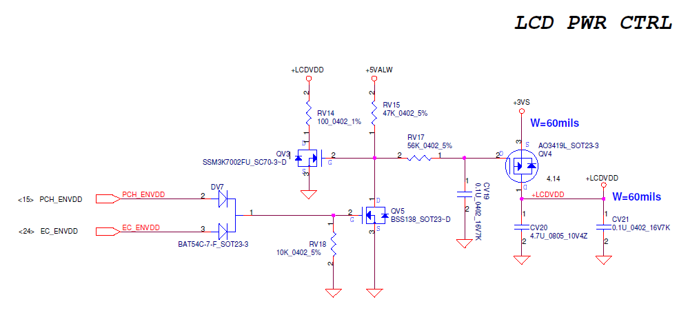

                                Focused my efforts on the backlight circuit, and I believe QV3 is shorted. At QV3, there is 5V on one leg (I believe this is D as it measures 100ohms to QV4, but not 100% sure), ground measures... to ground, but G measures at 4.4ohms to ground unexpectedly and 0V. Injecting 3.3V voltage at QV3 leg G causes QV3 to get scorching hot.
                                However, QV3 does not seem to be heating up particularly when the system is powered on. Is it possible that it is causing the PCH to appear as shorted?
                                Also all legs of DV7 read 0V and <100ohm resistance

                                  What about QV5? Since it seats inbetween QV3 and DV7, if it's OK then QV3 would not have any effect on the PCH. If it's bad then it may explain some things.
                                  Also with the information on this part of the schematics, I understand that LCDVDD should be 3.3V (which sounds reasonable) whereas you're saying that you get 5V there. Am I missing something?

                                    QV5 reads as 5V on one leg, 0 on the others, I will have to wait for my new multimeter probes to get here before I can test further. Injecting voltage into either leg doesn't cause it or the PCH to heat up.
                                    I have a feeling that I have misunderstood the schematic somehow as I think the 5V I am reading on QV3/QV5 is +5VALW and it is actually injection into the +LCDVDD leg that is shorted. I'll have another look at this when my new probes get here.
                                    EDIT: Removed QV3, no change, PCH still heating up when system is switched on (though oddly doesn't heat up quite so much as before when 3.3V is injected across the PCH cap). PCH still does not heat up without CPU installed
