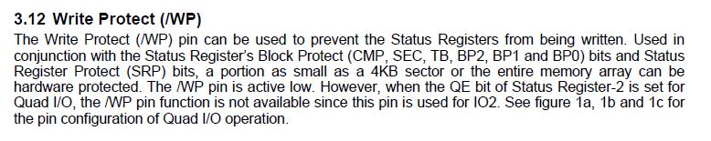

                So, for the poor souls that happened to brick their laptops - the best way is to reprogram the BIOS chip by desoldering it, dumping the file onto the chip and soldering it back on. The chip my laptop has is Winbond's W25Q64FVSIQ, be sure if you're replacing this chip that you get _EXACTLY_ the same chip. I tried flashing a brand new chip which was almost the same (W25Q64FVSIG), but according to https://cdn.badcaps-static.com/pdfs/...d69fd34b31.pdf , page 86 , it didn't have "QE=1 in Status Register-2".

                  It's explained on page 17 but I think this is an option for quad mode ( page 10 ), what programmer you use ?
                  if you be able to program it there are no differences
