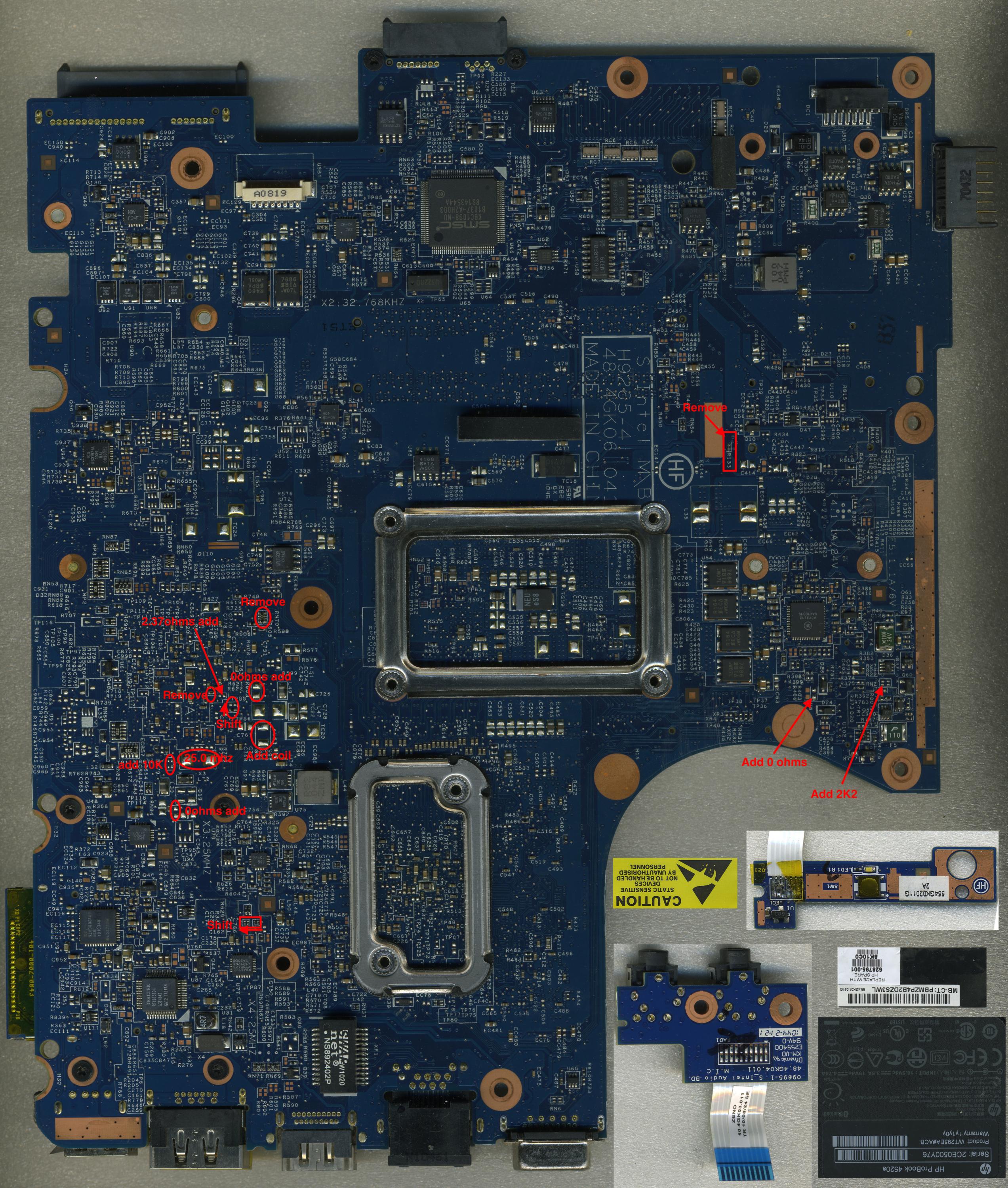

    hello guys
    can you help me
    i have 2x HP4720s with H9265-4 48.4gk06.041
    one spins fan but no image, no reaction to caps lock
    other starts and respods to caps lock or restart with ctrl+alt+del but no backlight and no image on screen
    one has i5 other i3 first gen with uma vga
    i have reballing machine and i know that problem is ati chip but can you help me to convert it to uma, cos it will last longer then reball?
    i tried on page 46 signal GFX_SEL to change resistors from R498 to R497 but it all remains the same
    any help please... at least to push me in right direction

        I think you need to check every part of schematic where DIS to UMA marked bold green. Meaning removing for example RN35 and installing it to RN31, R375 to R374 position and so on. Thats a lot of work to do.

                  I confirm the successful conversion to UMA or HP 4520s (Wistron-S 48.4GK06.041).
                  There are a bunch of components that have to be aded\moved\removed acording to the schematics. Firmware also has to be flashed with the UMA version, ATI and Intel graphics has different BIOS files on HP site. Unless the firmware is correct, there is no picture on LCD after conversion to UMA, only backlight.

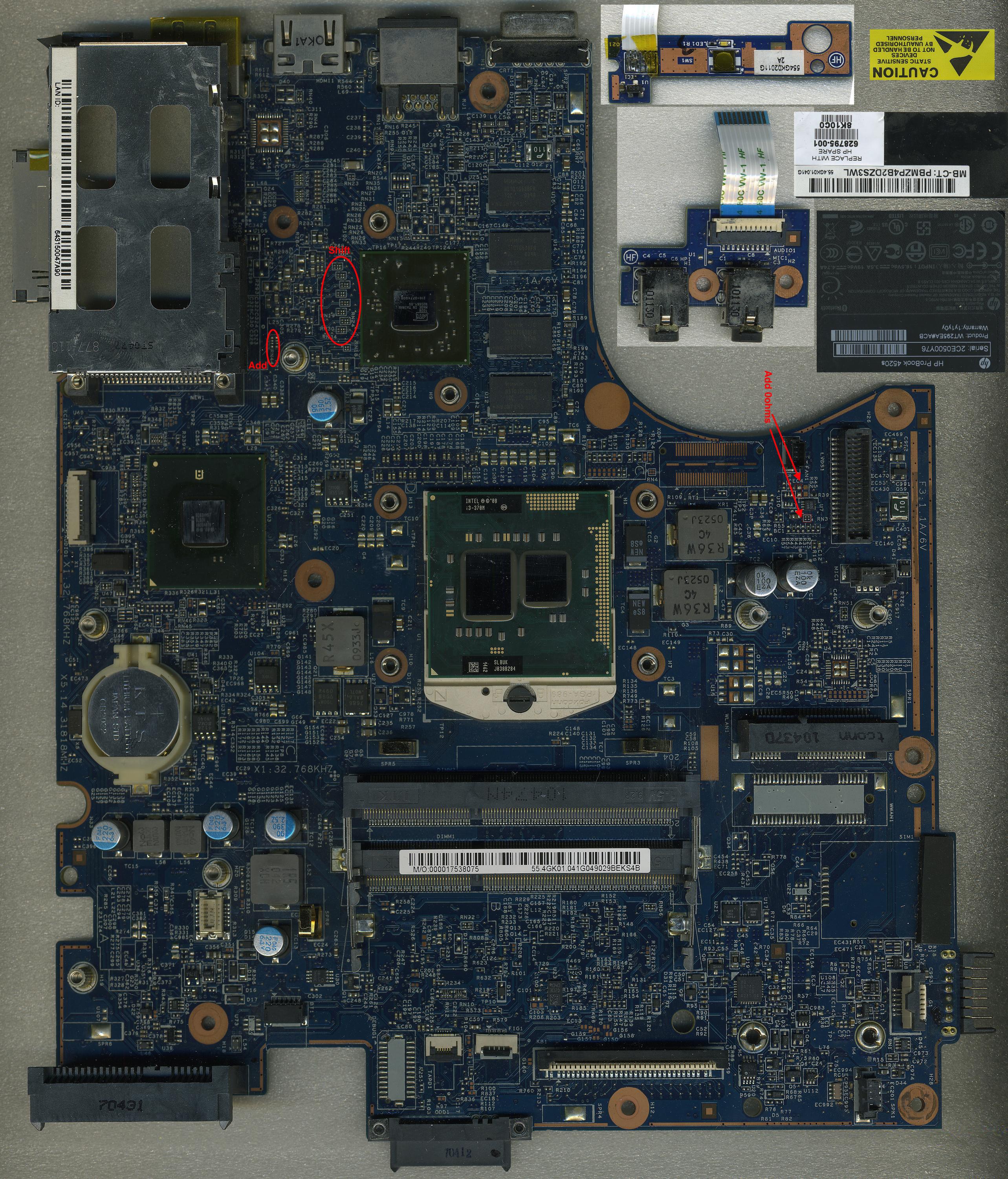

                          Was anybody able to perform the conversion?
                          This is what I found so far but didn't test them.
                          • mci
                            • Nov 2021
                            • 0
                            • Ro
                            Re: help HP 4720s dsc to uma convert
                            +Files

                                  So far no, there are a few instructions that I am unclear of
                                  - Add (what?)
                                  - Shift (where?)
                                  - Add coil (what value?)

                                    Anyone had success with the images posted above?
                                    I've compared them to the schematic and they are missing some parts:
                                    - move RN37 to RN23
                                    - move R375 to R374
                                    - move R498 to R497
                                    The discrete board is also missing U33 (PS8101) so there will be no HDMI output unless this chip is added.
                                    However, the most important missing part is entire VCC_GFXCORE supply on page 55. How is this mod supposed to work without VCC_GFXCORE for CPU?

                                      Connect wire cpuGFXCORE from ati core power supply.
