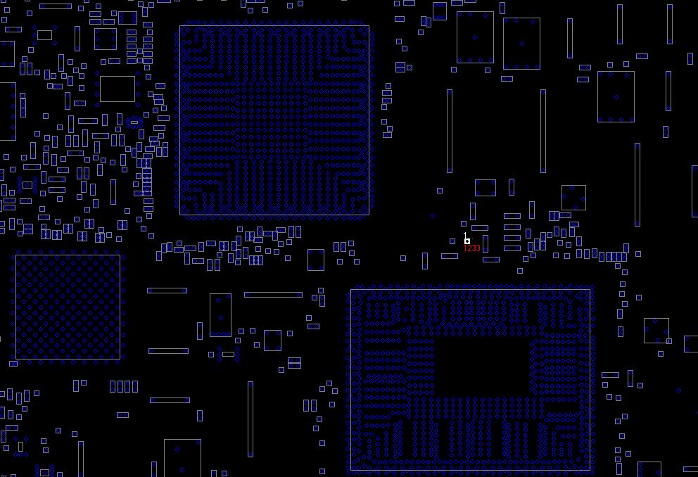

    i have power everywhere except where it says volt...
    should be 3.4 would i have to run a one wire to this cap or run one to the bios thanks

    Re: Macbook pro A1278 green light but no power
    Mother board code 820-........????????????????
    • robertpritchard
      • Dec 2016
      • 61
      sorry its a 820-3115 b
        SMC_RESET_L voltage ?????????
        SMC_PM_G2 voltage ?????????????
          3.4 and 0 and wont boot when shorted
            SMC_PM_G2 voltage
              sorry have no idea cant even find that on the scamadics
                  check boardview
                    Smc_reset_l
                      Smc_pm_g2_en
                        3.47 on pin 2 of u7941 SMC_PM_G2

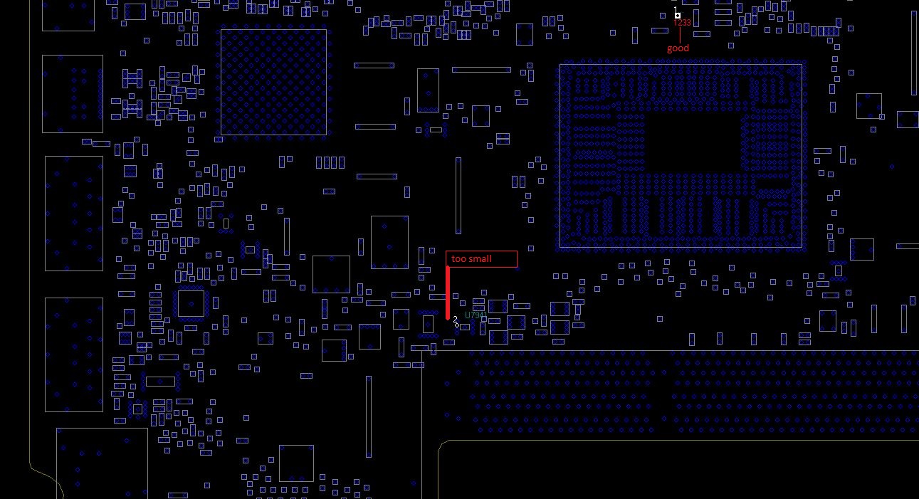

                          Smc_pm_g2_en
                          test 0
                          • robertpritchard
                            • Dec 2016
                            • 61
                            Smc_reset_l
                            test 3.16
                                Smc_pm_g2_en
                                test 0
                                FIRST YOU SAID Smc_pm_g2_en 3.47V AND NOW 0 V ?????????????
                                DO NOT TEST VOLTAGES AT THE PINS SIDE OF COMPONENTS WHEN THEY ARE TOO SMALL , to avoid shorting two pins at the same time. use instead other testpoints.
