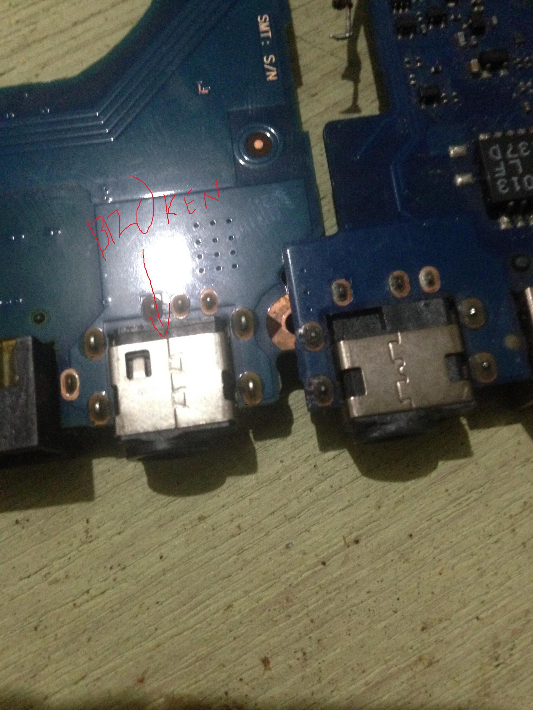

    hi friends i need help on this i have a samsung laptop Rc410 with broken charging port i need to replace but i dont have spare with the same charging port i have here samsung charging port also but it is from netbook different pins can i convert this to replace the rc410 charging port?I have attached the image of the two the upper one is broken on the bottom is available replacement from scrapboard. please help

      thanks for the response jiroy if i order online it takes time to deliver i have spare scrapboard samsung but different model its from notebook sori i forgot to attached the image i need a advise if can i use this to convert the dc jack?

        It look the same , and If the pins placement are the same , it's usually compatible . You can always test with a multimeter , comparing the two , just to be on the safe side .

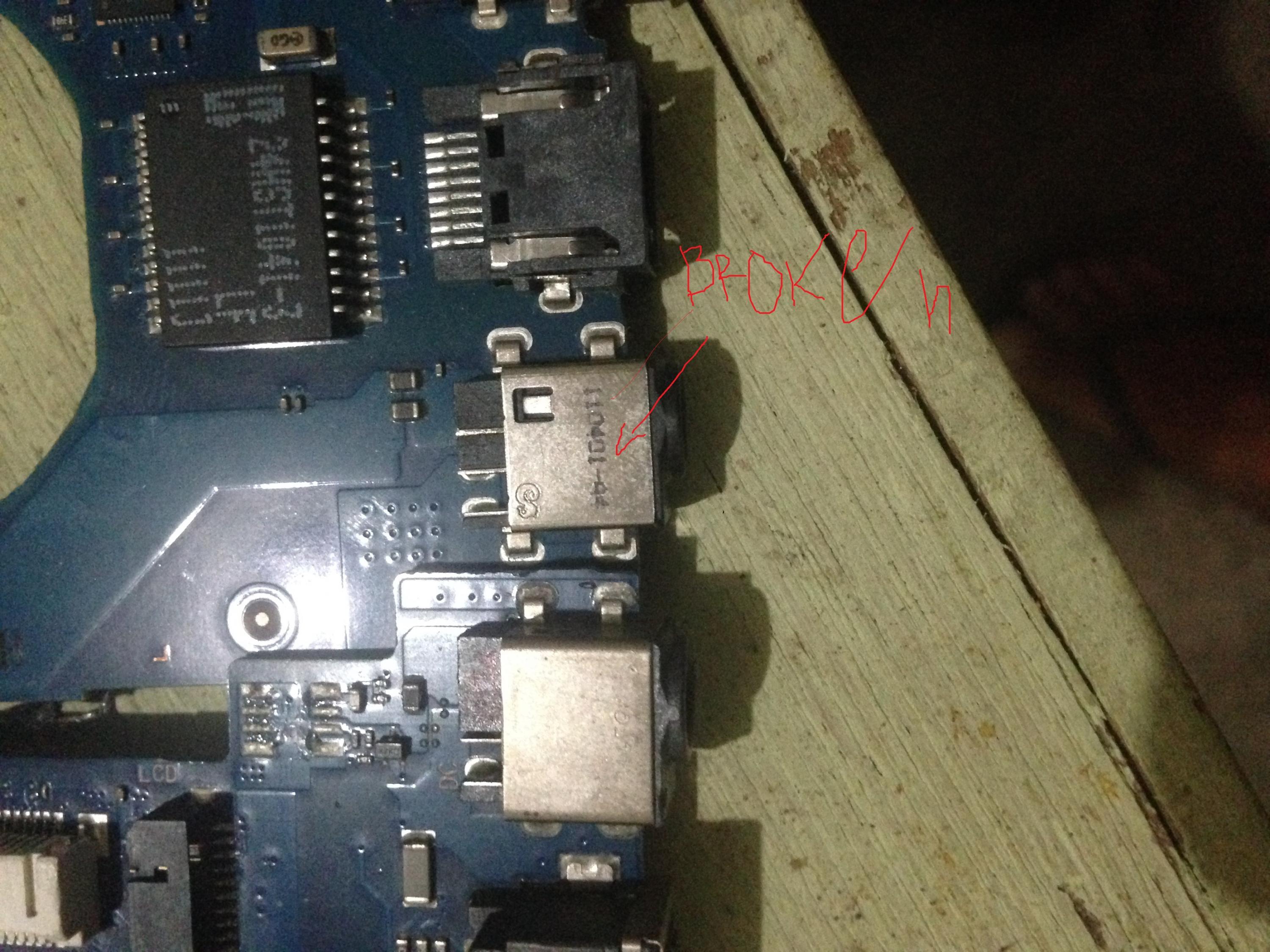

          and here is on the other side. is this possible to replace?

            From this side , it look the same too . If you want a 100% confirmation , put the part number of the used Samsung board ..

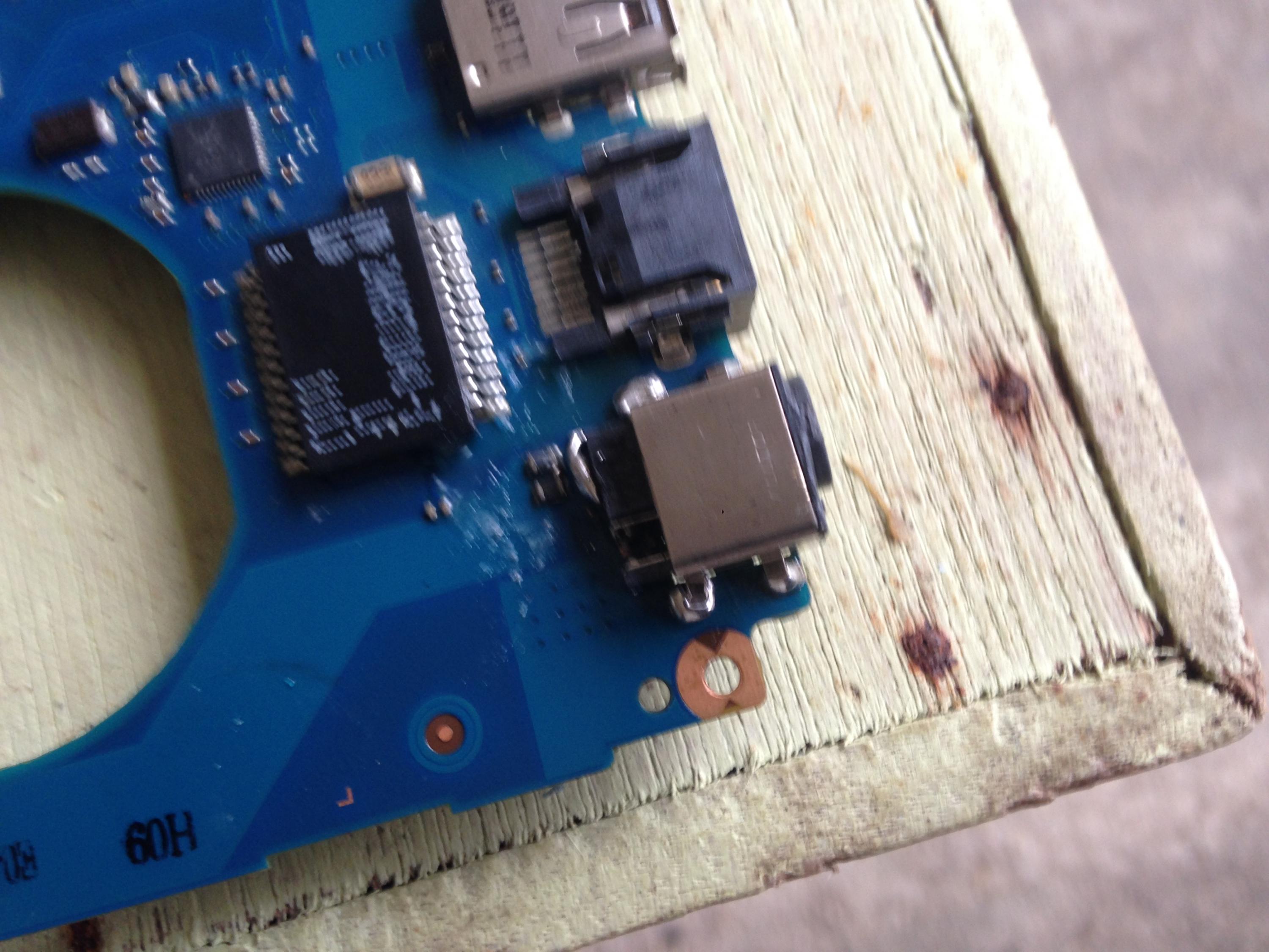

              the board code on the broken dc jack is model:jinmao-L rev 1.0 (101125) and the notebook for possible replacement board code is Eric-ve-r rev 1.0

                It's a match , if my eyes are still good today lol :

                      If you are replacing the jack marked broken then the three pins on the back are not the same spacing as the suggestion in post #8

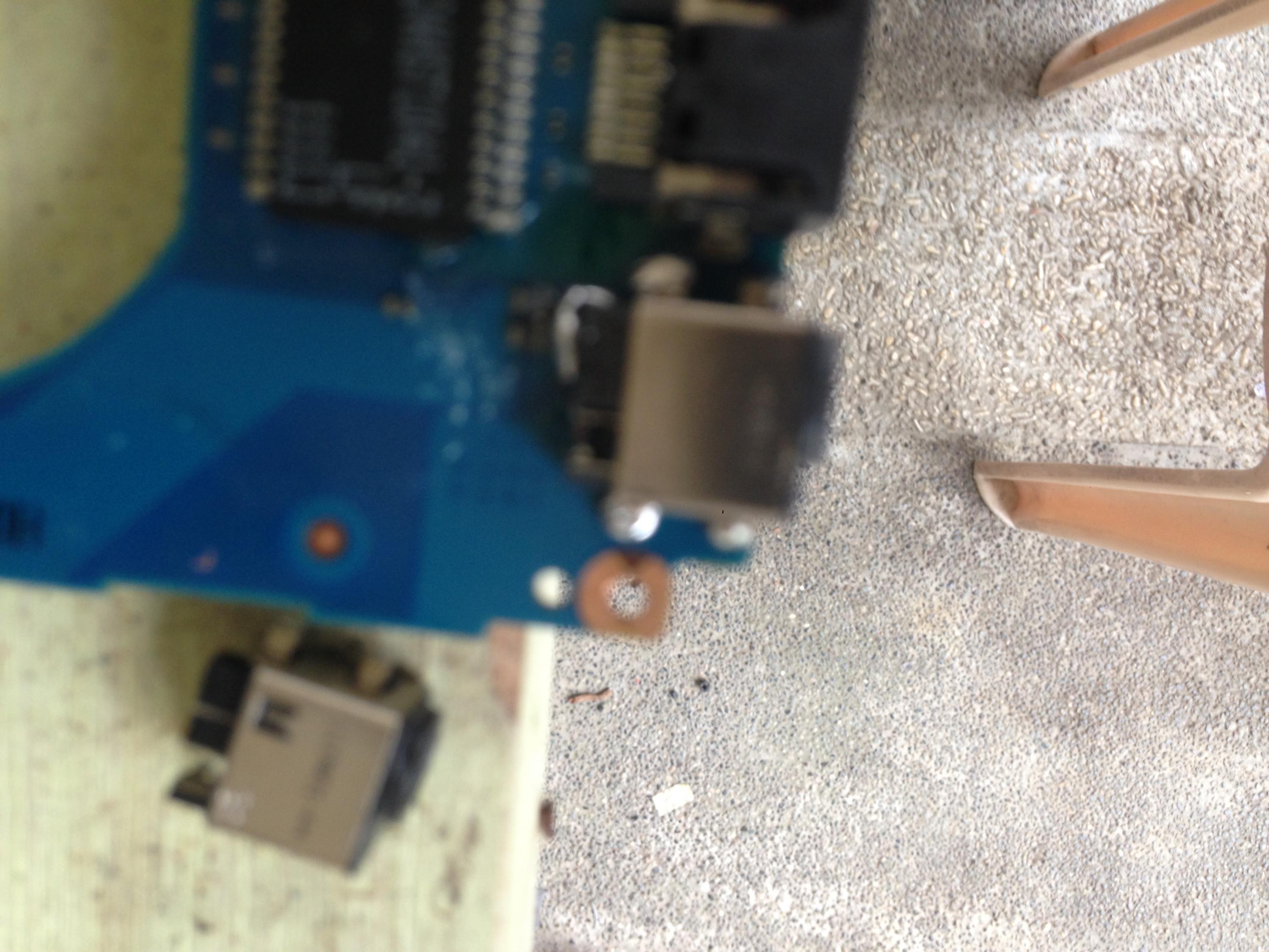

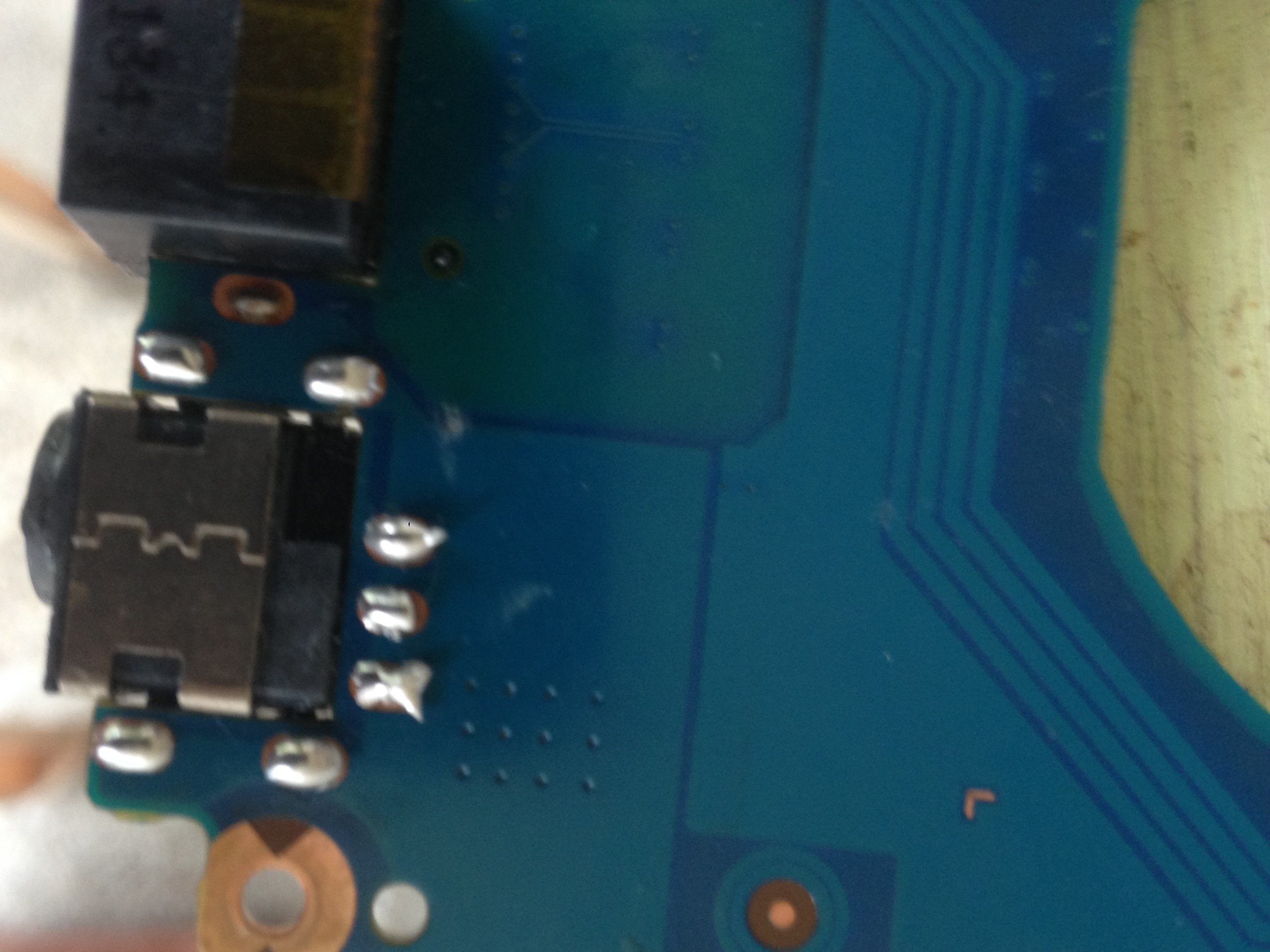

                            you are right diff i tried changing with above post replacement charging port when i plugged in the charger ther is no 19v on dc maybe i need to order the right one charging port i attached the image after i replaced the charging port

                              It's the top pin of the three in your second photo that should have voltage.
                              I can't see the first photo properly as it's blurry but it looks like you might have added a wire ?

                                  yes i put a wire to connet to the third pin because cannot reach the third pin i have no voltages on three sides here is the clear image on the top

                                    Wow fb as a source :p that list is clearly wrong as the photos show.
                                    There are several different types of socket for the Samsung laptops. Similar but different pin spacings. I have one of each in stock.

                                        I'd remove the socket from the motherboard and verify which pin has voltage on it. Perhaps you've put the link wire on the wrong one.
