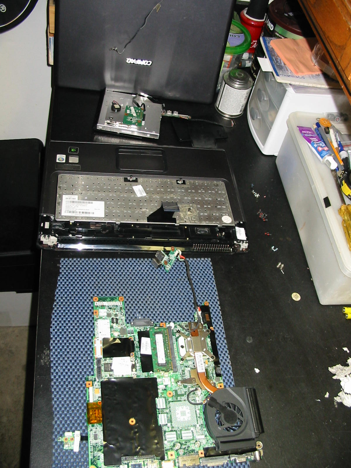

    That time came a month later. We had some good weather (not too cold or too warm), which meant I could do some reflows (on the kitchen stove, mind you ) and easily air out the fumes afterwards by opening the windows. Thus, I decided to reflow the Northbridge/GPU in this laptop, just for fun to see if that would fix it. After all, I had nothing to loose but a bit of time with that.
    I began stripping down the laptop. But after removing the HDD, RAM, wireless card, and a few other small plastics, I quickly got stuck – I just couldn't figure out how to open the damned thing! So I searched online and found the service guide for that laptop. After going through the disassembly steps and finding a few “hidden” screws that I had missed, eventually, I got the laptop fully taken apart. (I suppose for those of you who do laptop repairs for a living, you probably find this amusing. But I've only worked on a few laptops before this, most of them being Dell Latitudes, which are a piece of cake to take apart and put back together).
    Then finally I got it all disassembled:
    https://www.badcaps.net/forum/attach...1&d=1504815472
    Upon seeing the motherboard's cooling, it was obvious why the NB/GPU had failed: it was thermally “coupled” to the CPU heatsink with a thick thermal pad. The thermal pad was at least 2 mm thick . Moreover, the CPU heatsink had a copper pad soldered to it for the NB/GPU, but why didn't they make it just a small bit thicker to deal away with the thick thermal pad?

    So then I did the reflow, as I usually do: place a grille above one of the stove's gas burners, put the board on top of the grille, place a type-K thermocouple near the GPU, and turn the gas burner on LOW. Wait until the board temperature reaches about 110°C and keep it around that temperature for a few minutes to “soak” the board with heat. This also allows any moisture to escape before reflowing, so that I don't get “popcorn” at high temperatures.
    After soaking the board, I usually turn up the heat just a slight bit so that the temperature raises about 1-2°C per second. When the area around the GPU hits 150°C, I turn on my heat gun to its high setting (about 1400 Watts) and point it up in the air for a few seconds until it heats up (the heating elements inside starts to glow orange). Then point at the GPU, keeping it about 2.5-3 cm away. This is where it gets tricky, as my thermocouple starts to show the temperature of the hot air from the heat gun, which varies between 250-300°C, depending on where the thermocouple is placed. So to avoid overheating or under-heating the board, I periodically move the heat gun away from the board and let the thermocouple read the temperature of the board. As I continue to heat with the heat gun, I also crank the bottom heat a bit. When the temperature is 210-215°C, I heat for about 10-15 more seconds, then turn off all heat and let the board cool on its own. (Unfortunately, I don't have a picture of the setup)
