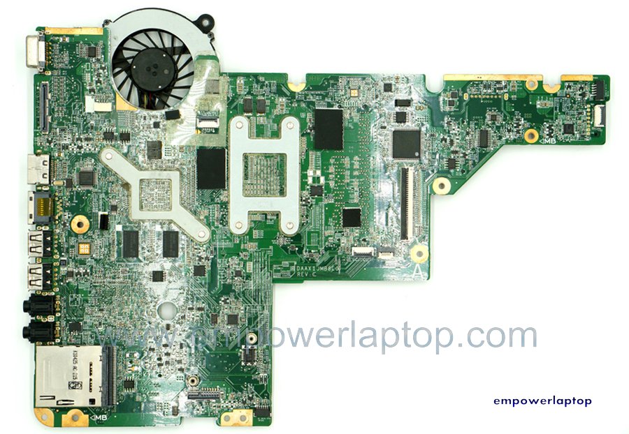

    Hi, i have DAAX1JMB8C0 with the processor on board. Will it work? I tried except the seventh picture. But its not powers up.
    In 7th stage cant figure out the position of the capacitors.
    I have one difference in picture 2. I had 75 ohm resistors instead of 70 ohm in r497 , r498, r499
    Hi memoslar, Here is your answers:
    1) 7th stage pic-you need to put 470uF capacitor at PC132 and then make a jumper from PC132 positive to Q9 mosfet on pin1
    2) 75 or 70 ohm resistor hardly matters. You can use anything between 60-80 ohm. It will work.
    Boardview was already uploaded by me. Use that to locate components.

        It works dear as long as you do it correctly. 100% tested by me.

          Thank you very much ! it worked good!! God bless you

                    Here is the conversion details+Boardview(without which its very difficult to locate components
                    Enjoy
                    i tried.it is working but no video on vga port and hdmi.my vga problem solved with schema.

                      The DAAX1JMB8C0 with the processor on board has another simplier convertion.
