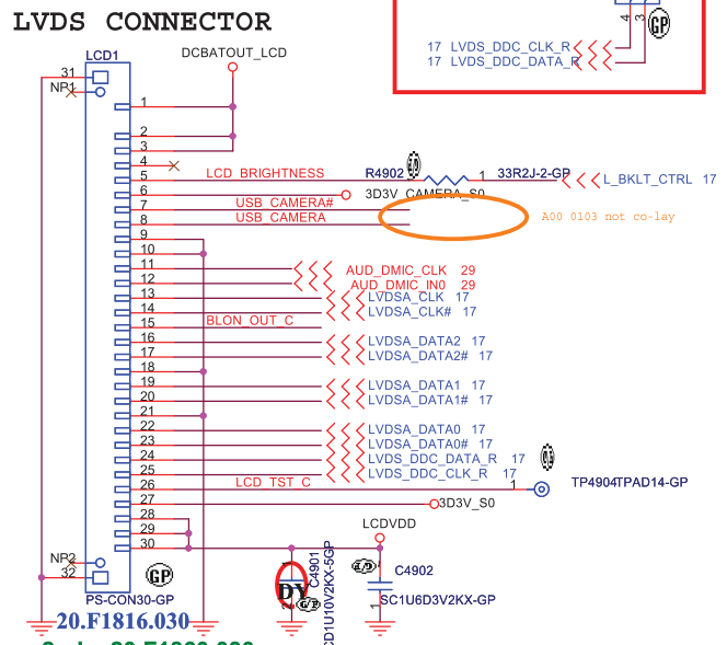

    Check LVDS connector for LCD_EN, BLON, LCD_VCC

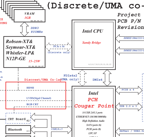

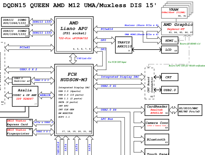

          There are two versions of this laptop
          On INTEL and AMD platform, Motherboards on INTEL come with NVIDIA and ATI graphics card and without discrete video - UMA
          What is your motherboard ?
          LVDS connector is the same in all versions, measure the voltage as you advised raajkumar

            Mine is Intel without discrete graphics

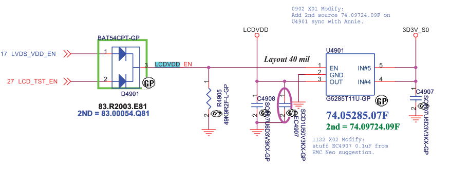

                  What about LCDVDD is Pin 28,29,30. LCDVDD should be 3.3V. If not available the screen will not show anything.
                    Re: Dell Inspiron 5110 No display on led but getting external display
                    No voltage at pin 28.29.30

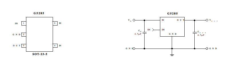

                      So i think there was a chip with 5 pins near to LVDS connector on motherboard. It is looking 2 pins one side 3 pins other side. You can put a jumper between pin no. 3 to pin no 4. then you can switch on and check it. you can see pinout of that chip on my attached picture.

                        Friend Thank you Man.
                        Done it. i got display. I have old same board can i replace it or can i make jumpler

                            For quick checking connect 27 pin and 28

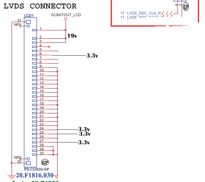

                              I have dell 5110 with discrete which is converted into the uma. The issue is deam display. In LVDS cable 1, 2, 3 has 19v which is ok for blow for LED that I think. HALL 1 connector pin no 2 and 4 has also 3.2v. So help me for solution, Please.

                                check for 3.3V - BK_ON signal and 3.3V BL_PWM signal
