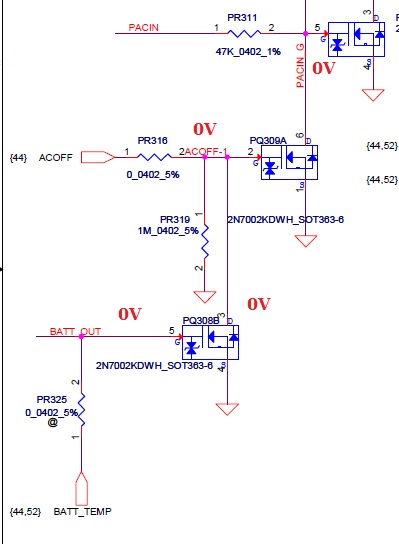

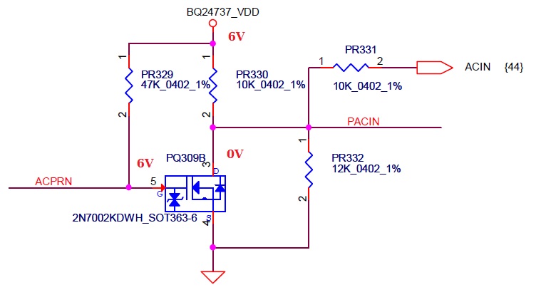

                  maybe u have right. after changing BQxxxx i have ACOK and ACPRN. but afteer jumping second mosfet, the short come out
                  im going to inject to vin line

                    Re: lenovo, no EC_ON signal
                    ok, i replace the short in PQ312
                    but no change. i make some measures
                    dont have PACIN

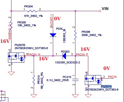

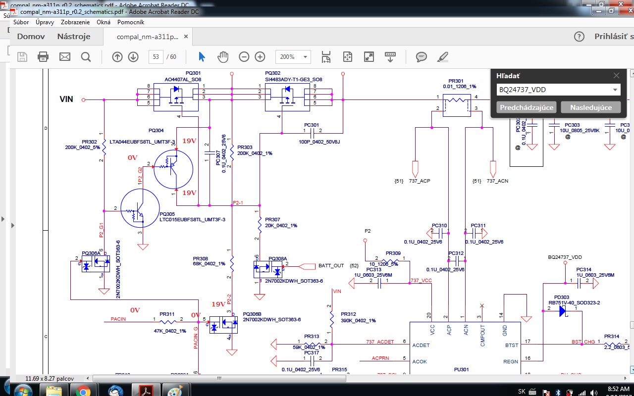

                      inject direct to 3V alw line,if ok,then try 5V alw line,i dont understand so complex cirquit with all signals like this one :-) on my board i spend maybe 3 hours tracing and meassuring and i gave up because everythig was ok imho...
                      btw ACPRN != PACIN as it goes over PQ309B so you cannot have booth at one time
                        so know anybody which signals must have, so second mosfet switch on
                        as it is P channel, i must have BATT_OUT or PACIN to have negative voltage on secong mosfet gate

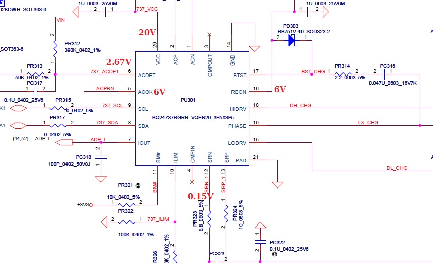

                          Check voltage on pin ACOK, VCC, SRN, ACDET, REGN of charger IC.
                          ACOK must be low on bq247x7 for PACIN to be high.

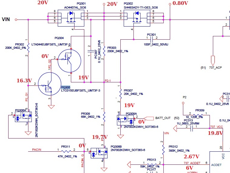

                            6V at acoff-1 is bad, where it is coming from?
                            it will bring the pacin_g to gnd and you will have 19V at P2-2
                            Adapter is smart and ok?
                            I believe ~380K to gnd from id pin was the value for lenovo.
                              but acok is signal from BQxxx that AC is detected and is ok
                                ACOK is active low on bq24737 (see datasheet for bq24707, it's pretty similar) so if you have a voltage on this pin, something is wrong. You should have 0V.
                                You can also check the bq24707 datasheet for the conditions which leads to ACOK activation (involving the pins I listed).

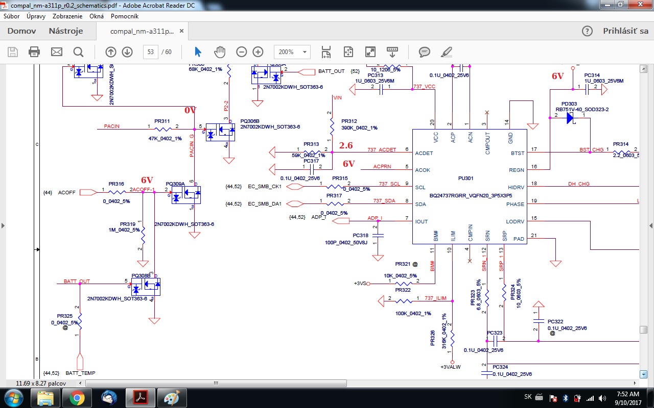

                                    i can not find datasheet for 737.
                                    from datasheet of 707 i must have SRN high like VCC, but i have 0,15V and no short to ground on that signal. acok is 6V and from datasheet it is fault.
                                    Is my BQ bad? /it a new one/
                                    i make some better measurement so chceck it out
                                      According to the datasheet, the conditions are as following:
                                      • voltage on the ACDET pin is above 2.4 V
                                      • voltage on the VCC pin is above UVLO
                                      • voltage on the VCC pin is 245 mV above the voltage on the SRN pin
                                      Voltage on the SRN pin has to be at least 245mV lower than VCC. There is no lower threshold, so I guess 0V is OK too. SRN is connected to the battery line so I think it is never around 19V.
                                      Check the voltage on ACDET, and make sure VCC is around 19V. If they are ok and ACOK is still high, maybe the IC is bad and you can try putting a new one.
