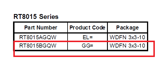

    Hello.
    I'm trying to find the component as shown on the attached picture.
    It's from a ASUS K55VD rev 3.0 board.
    I'm guessing at something like, GG-DV D0U
    Shared via dropbox.
    https://www.dropbox.com/s/w02z0n1ovf...%2017.jpg?dl=0

    Re: Help identifying component
    RT8015BGQW, according to https://cdn.badcaps-static.com/pdfs/...0c114d947f.pdf and boardview component PU8400 (attached).
      https://cdn.badcaps-static.com/pdfs/...97675d353f.pdf
        Thank you
        My component is measuring 3V and 5V on a 1.8V line.
