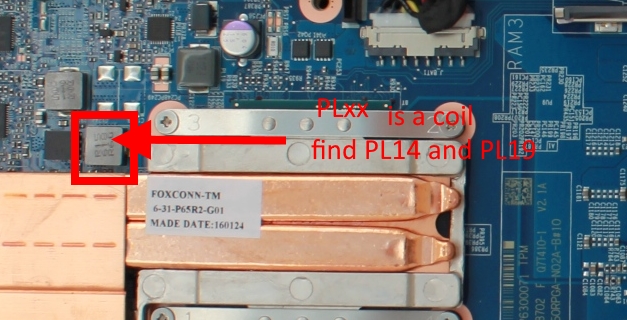

                        probably a bios issue, but (no power on notebook) find PL14 -> 3.3V and PL19 -> 5v

                              I'm sorry, I indicate PLxx to example for what type of component you must search, find and check PL14 and PL19 . I haven't a hight resolution board image

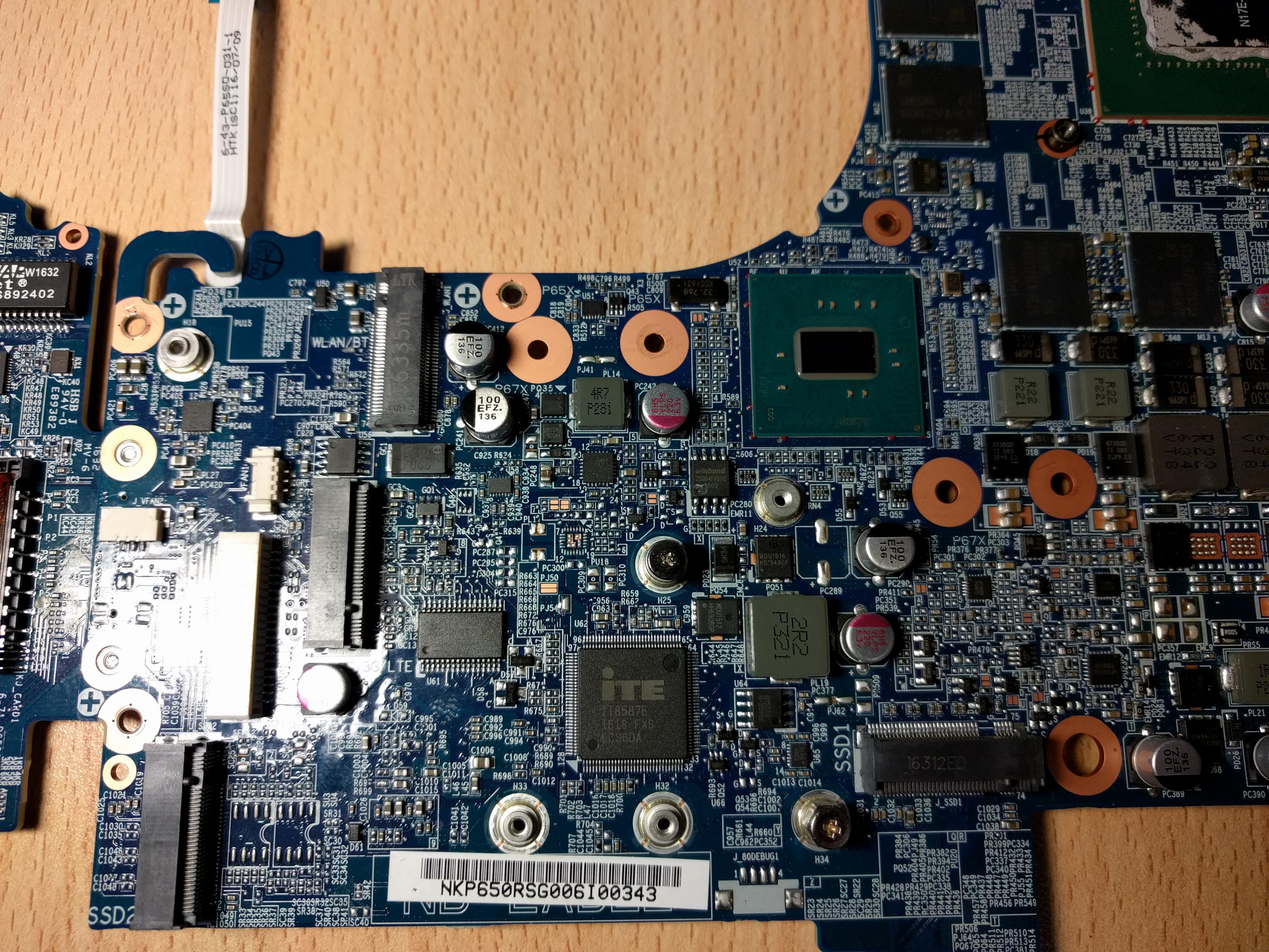

                                  In this model all main component are soldered, so you can't try to replace cpu or gpu. With an oscilloscope is possible to see if bios work correctly but in this case only a reprogramm can help you to exclude a bios U57 issue.
                                  Other tests are possible on U62 KBC IT8587 but require a lot of time.

                                        I have another question! In the photo in red did I measure Volt there? If The Notebook is on ?!
                                        On the CPU I measure 1.2 Volt - 1.0 Volt on the South or Northbridge likewise only not on the GPU !?
                                        Is there someone here the vllt the Mainboard against payment repaired?
