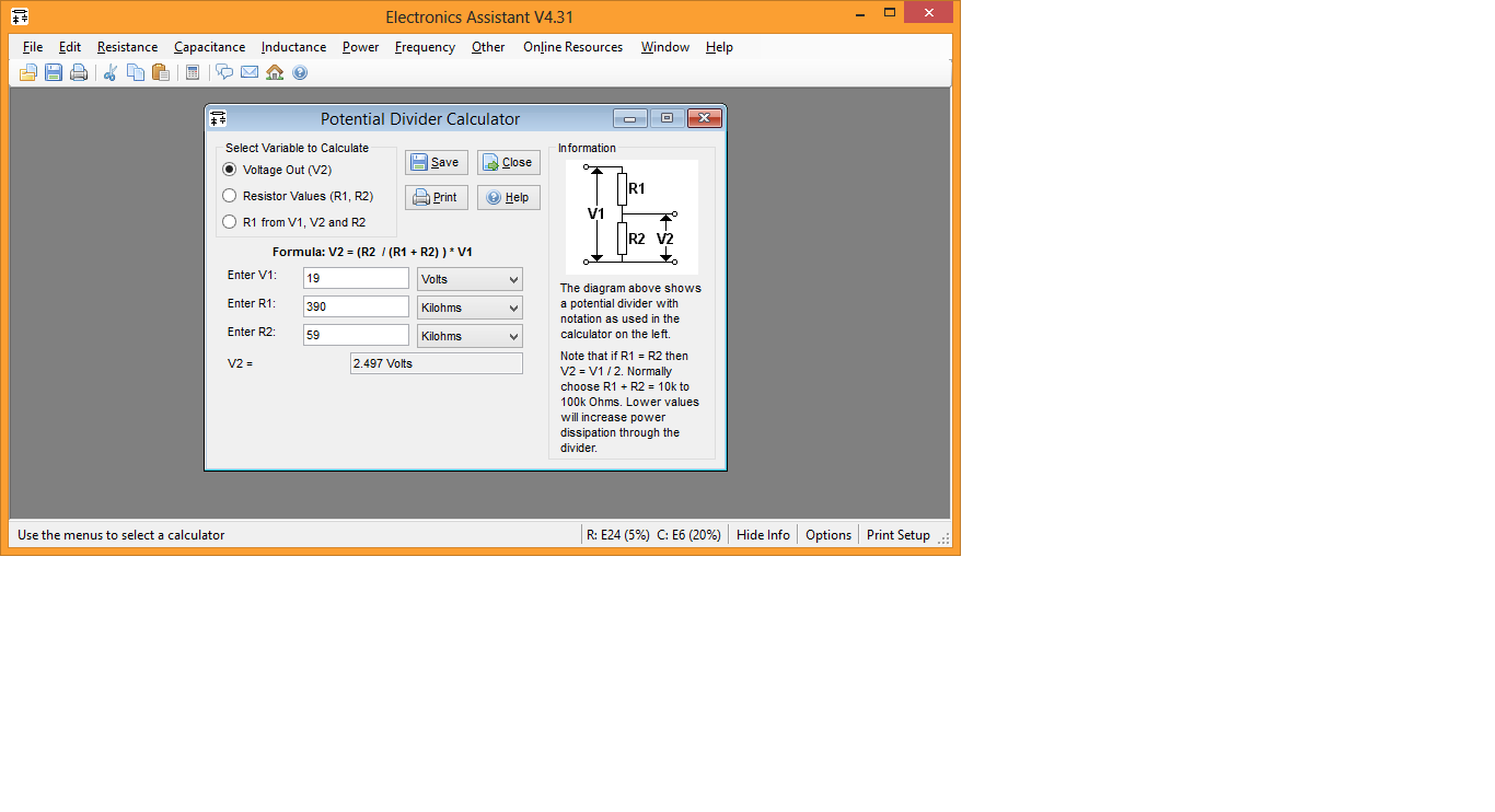

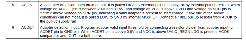

              Re: lenovo g50-70 motherboard ACLU1 / ACLU2 NM-A271 Rev 1.0 does not charge the batte
              Originally posted by rafsad ck
              pin 6 19v
              Check value of resistor PR311 maybe have been open circuit.
              ACDET pin voltage between 2.4V and 3.15V, maybe arround 2.6V
