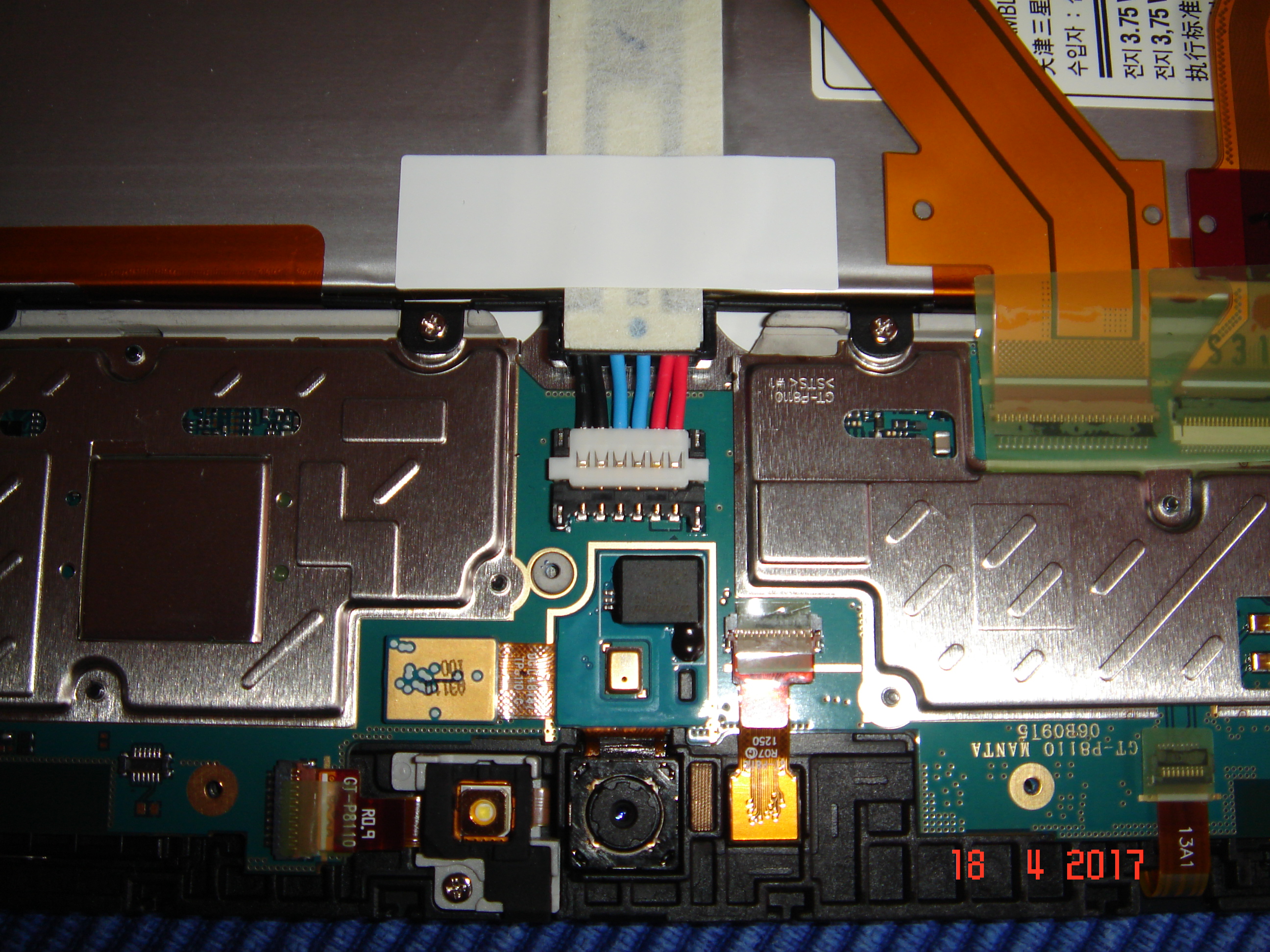

        I have now diassembled the rear cover and disconnected the battery.
        Reconnected battery and now i see the animation of the battery charging, but after 30 minutes, no change, still a reboot loop.
        Yes, i've tried "holding down volume up and the power button", no change.
        Must i assume a dead battery ?

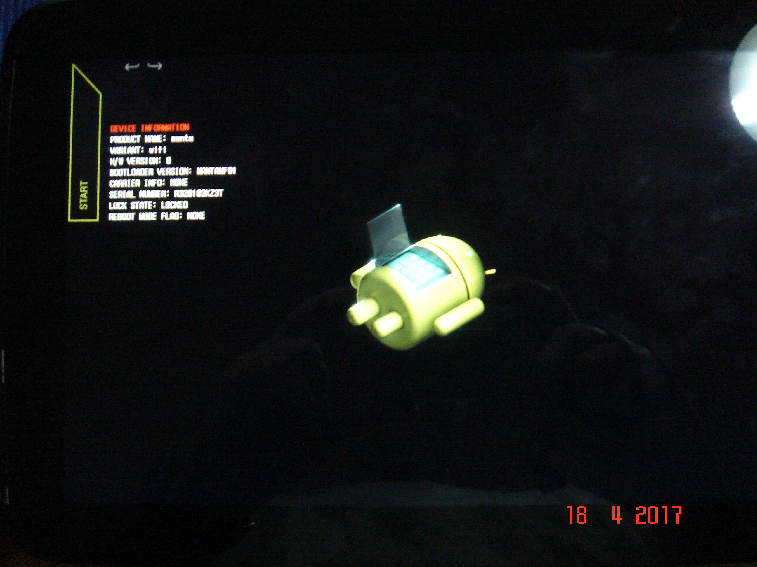

              Re: Samsung Nexus 10 Reboot Loop
              This is what i get with my ignorance :
              PS: power Botums doesn't validate recovery mode
              PS2 : Battery still not charged
                Hi Pasette, try the following:
                Important: If your device is running Android 6.0 and up, you'll need a Google username and password already associated with the device. If you don't have the username and password, you won't be able to use the device at all after reset.
                After following all the "Get ready" steps above:
                If your device is on, turn it off.
                Press and hold the Volume down button. While holding Volume down, press and hold the Power button until the phone turns on. You'll see the word "Start" with an arrow around it.
                Press the Volume down button until you highlight "Recovery mode."
                Press the Power button to start recovery mode. You'll see an image of an Android robot with an exclamation mark (you may also see "No command").
                Press and hold the Power button. While holding Power, press the Volume up button once. Then release the Power button.
                If "Wipe data/factory reset" isn't highlighted, press the Volume down button until it is. Then press the Power button to select it.
                Press the Volume down button until you highlight "Yes" (or "Yes - delete all user data"). Then press the Power button to select it.
                After the reset is complete, press the Power button to select "Reboot system now."
                When you're done, restore your data. Learn how to restore your data on a Pixel phone or on a Nexus device.
                Tip: If your device becomes unresponsive, you can restart it by holding down the Power button for several seconds.
                Let us know the outcome, tanx
                  Please, read the post's above, cause nothing of what you wrote works.
                  Now it's worst, cause i can't even turn off the Sh***
                  It's on a real Loop of "ON and OFF" every 5 seconds

                            It will probably not turn on without a battery. Try removing the battery and injecting 3.7V directly on the battery connector. (without attaching the charger)
                              Can you tell me which of the connectors should i inject the 3.7V ?
                              I have measured the pins of the battery connected, 2 red and 1 blue are reading 4.1V.
                              Thanks Guys
                                The Red wires are the positive Passete, the Blue wires i suspect would be a sense wires for charging but would need someone to confirm that, the battery is rated at 3.7v so if you're getting 4.1v there may obviously be something amiss, as i stated in one of my earlier posts i'm not too familar with the internals of Android Tablets so maybe Piernov or someone else can comment further.

                                  Same here, no experience with that kind of stuff (messed with a few Samsung phones/tablets which wouldn't power on, I wasn't able to fix them).
                                  If the charger is plugged in and the battery is charging, I think reading 4.1V is fine. If the charger is disconnected you should be reading around 3.7V (the voltage is written on the battery sticker).
                                  The red ones are tied together and they are the positive side, black ones are ground, and blue are (I think) data lines.

                                    I use Li-Ion 18650 Batterys (the same ones used on laptops) with my Ecigarette, and they are rated for 3.7V, but when fully charged they read 4.2V.
                                    I will try injecting 3.7V on the red connectors.
                                    PS: i was able to get the hide menu, but when i "hit" the recovery mode, the "approid" start with the crazy loop.
