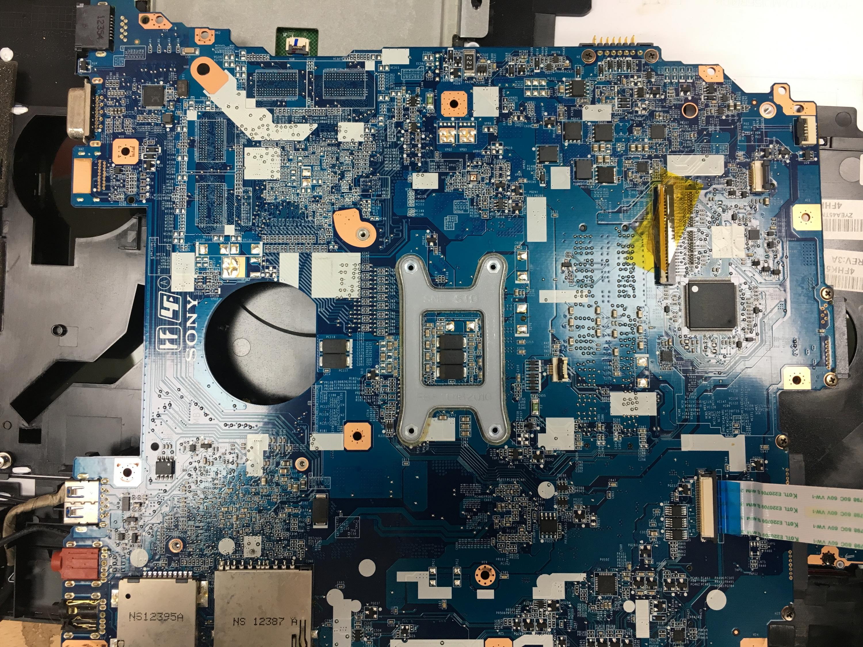

Sony Vaio - Doesnt work with battery
  • speedypro
    • Feb 2013
    • 561
    • United Kingdom
    Sony Vaio - Doesnt work with battery
    I have this laptop with board number daohk5mb6fo, it works great, yes it down. If I use a battery, it wont power no nor charge. If battery is removed and laptop is powered on then put battery is, it cuts out.
    Bios? I would not think that. Could it be? Here are some attached pictures
    Full-time computer repair tech (10am - 6pm) and full-time, (8am - 11pm), Ruby on Rails Developer
  • ktmmotocross
    Boardkiller
    • Feb 2014
    • 3610
    • slovakia
    Re: Sony Vaio - Doesnt work with battery
    "Full-time computer repair tech "
    and u cannot check this? dude r u kidding me?
    • petehall347
      • Jan 2015
      • 4428
      • United Kingdom
      Re: Sony Vaio - Doesnt work with battery
      try another battery or set up a test rig for the battery you do have .
      • HarryPK
        • Mar 2014
        • 210
        • barabai
        Re: Sony Vaio - Doesnt work with battery
        it s fet faulty, check all fet around charger ic...
        • speedypro
          • Feb 2013
          • 561
          • United Kingdom
          Re: Sony Vaio - Doesnt work with battery
          Originally posted by ktmmotocross
          "Full-time computer repair tech "
          and u cannot check this? dude r u kidding me?
          No. I kid you not. I need to change that footer. The repair shop I work at few days has limited of test tools. It's a crap place.
          Originally posted by HarryPK
          it s fet faulty, check all fet around charger ic...
          Will do.
          Last edited by speedypro; 03-31-2017, 03:58 AM.
          Full-time computer repair tech (10am - 6pm) and full-time, (8am - 11pm), Ruby on Rails Developer
          • cyberhack
            • Feb 2013
            • 466
            • Uk
            Re: Sony Vaio - Doesnt work with battery
            Don't let them get you down,get them to get some new tools spend spend
            • ktmmotocross
              Boardkiller
              • Feb 2014
              • 3610
              • slovakia
              Re: Sony Vaio - Doesnt work with battery
              for this repair u need multimeter for 5euro and solder iron.
              u r shame for all Full-time computer repair tech
              Last edited by ktmmotocross; 03-31-2017, 10:20 AM.
                Sony VAIO VGN-FZ31J FZ Specification for Upgrade or Repair
                This specification for the Sony VAIO VGN-FZ31J can be useful for upgrading or repairing a laptop that is not working. As a community we are working through our specifications to add valuable data like the VGN-FZ31J boardview and VGN-FZ31J schematic. Our users have donated over 1 million documents which are being added to the site. This page will be updated soon with additional information. Alternatively you can request additional help from our users directly on the relevant badcaps forum. Please note that we offer no warranties that any specification, datasheet, or download for Sony VAIO VGN-FZ31J...
                09-06-2024, 05:27 AM
              • dhs6512
                Lenovo Legion 5 15ARH05H, NM-D281 Rev: 1.0 not work with the battery
                by dhs6512
                Hello. Lenovo Legion 5 15ARH05H, NM-D281 Rev: 1.0 board
                Initially dead. Inspection: the board was not touched, on EC IT8227E-192 2101-CXA there is a mini-burnout.
                Replaced with the same one, flashed the EC with the official firmware (had to solder to the pins), left the main firmware (Gigadevice 25LB128DSIG) original.
                When connecting the charger, the device started, gave picture and works, checked all the functions - ok.
                Connected the original battery. Only on the battery the device starts for a second, lights up the keyboard backlight and turns off.
                When connecting...
                10-29-2024, 11:04 AM
              • mkdj
                ASUS X571 no power : battery issue?
                by mkdj
                Mark and model: ASUS X571
                Symptoms: not turning on. There is only the LED battery indicator working. The owner of the laptop told me this problem arrived one week after having changed the battery. He then managed to power on the laptop only once, and then it never powered on again.
                Tests already made:
                - Battery is charging when laptop is plugged in. The LED battery indicator turns white after a couple of hours of charge, indicating that battery is fully charged. However, laptop won't turn on anyway, with or without AC plug.
                - I have removed...
                07-14-2025, 09:16 AM
              • pabloroggeri
                Lenovo V310-15ISK - It doesn't work after changing the battery
                by pabloroggeri
                Good guys. I changed the battery to a Lenovo V310-15ISK.
                The laptop worked perfectly, I changed the L15C4A02 battery because it didn't last very long.
                When I connected the new battery, the charging LED stopped lighting up and the one next to the charging pin also did not react when I pressed the power button. Minutes before changing the battery it worked perfectly and stopped working after putting the new one in. Even if you put the oroginal battery in or connect it without the battery, no LED lights up when you press the power button nor does it give an image, nor does the...
                08-23-2024, 12:01 PM
              • techfreak9356
                Vostro 3400 (LA-K033P) won't charge battery, everything else ok
                by techfreak9356
                I bought a Vostro 3400 motherboard (LA-K033P) to upgrade over my damaged Inspiron 5593 (LA-J091P) board. Everything else is ok except for the battery. This battery I am using now is already a replacement one since I disposed of the bloated original one. Back in the Inspiron 5593 motherboard, the battery charges fine and is identified just fine. However, with the upgraded motherboard, suddenly the replacement battery is labeled as "Not a dell battery". When I borrow a similar battery from my colleague (which did not have replacements yet), it is identified and charges just fine.
                09-14-2023, 11:10 PM
