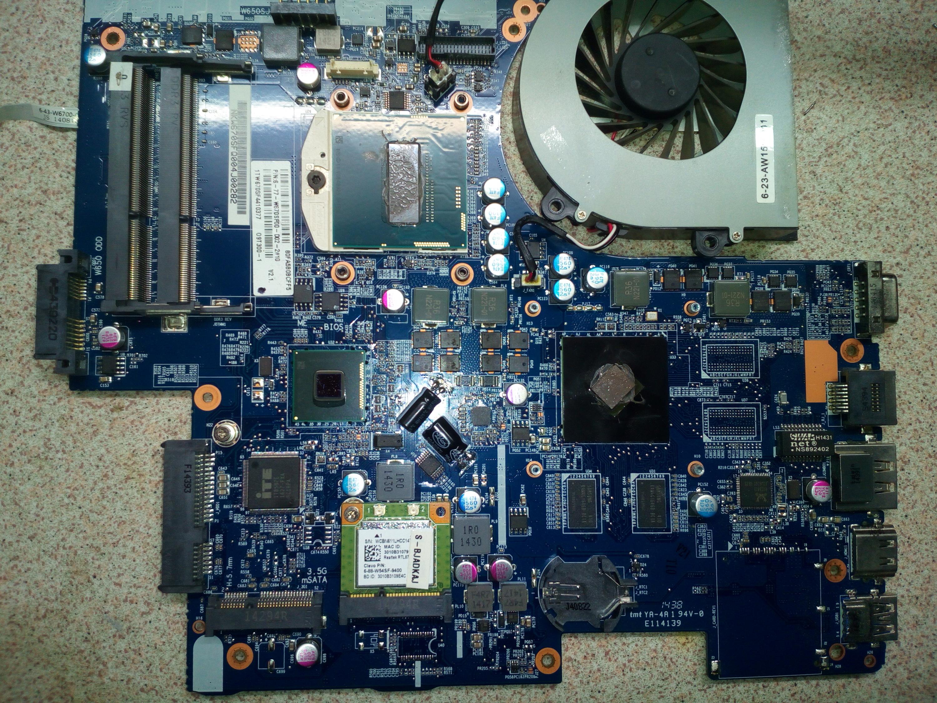

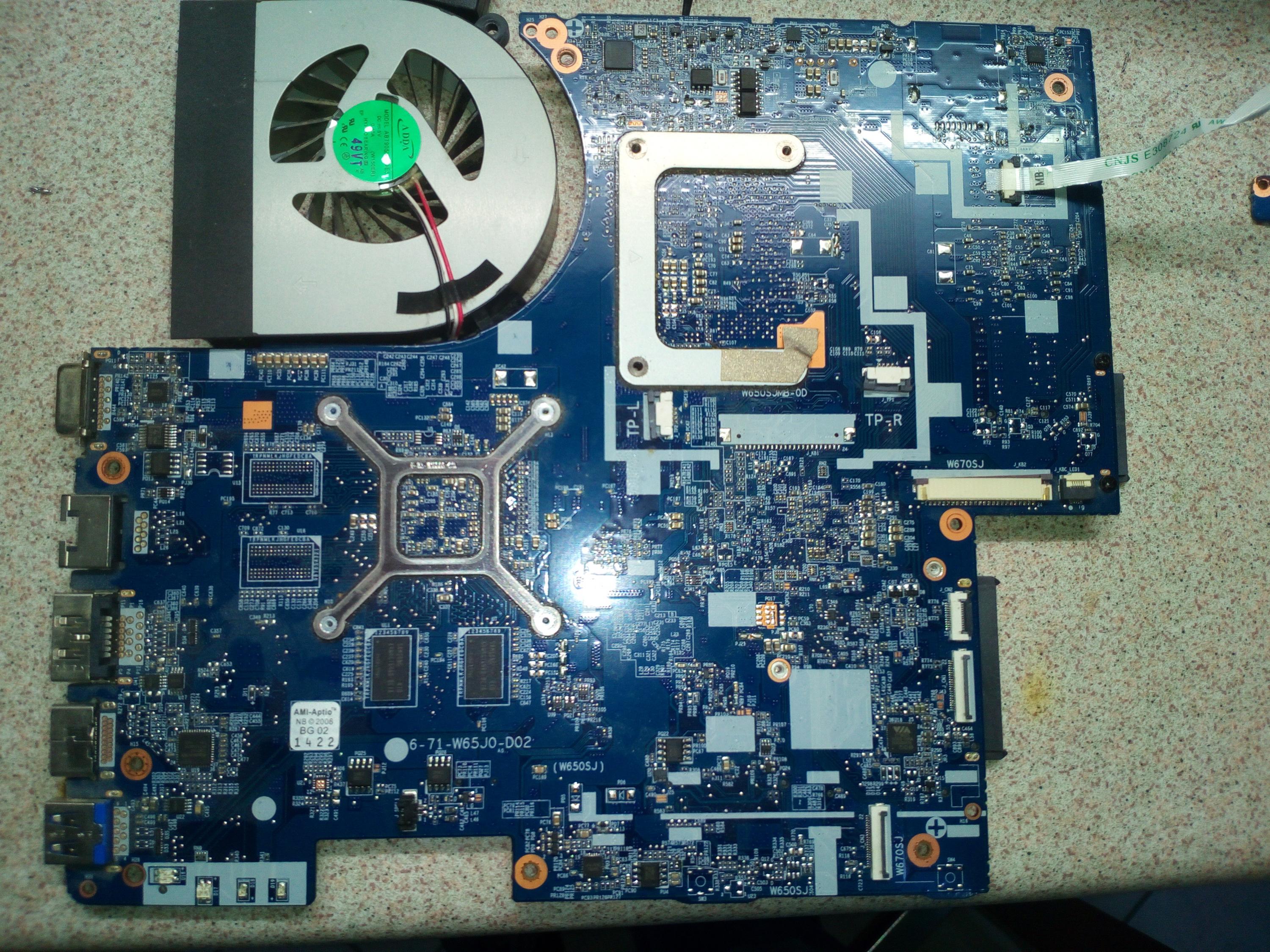

    I have a laptop with clevo w650sj motherboard and no power,no lights nothing.
    When I connect it with my bench power it seems that it draws 0,7A for a moment and then goes to 0 A.
    I have 19V in PQ 33 and PQ 8 mosfet in all pins except pin 5 on both mosfet which give me 2,5V
    I try to reset the bios, still the same problem. In all electrolytic capacitors (6,3V 2,5V) I have no voltage.
    What else can I check?

    Re: clevo w650sj no power
    Check VDD3(3.3v) and VDD5(5v). Check for short circuit on all the coils (use diode mode on multimeter put one prob on ground and second on coil 0.00 means short).
