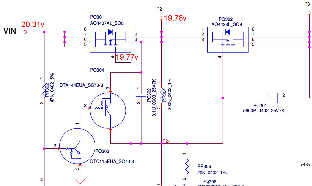

    Hi everybody,
    I have a Lenovo G500 with LA-9631P mobo that doesn't turn on. If I connect the laptop to AC power I get no lights or anything that shows that its on a power outlet. Same thing happens if I press the power button.
    I have found some information and schematics on the internet about the laptop and I started measuring Voltages with a multimeter. I have power (20.31V) getting in the mobo but no 3.3V or 5V.
    From the info I have found this laptops has problem with the FETs on the charging circuit. So I measured the voltages on the first FET after the VIN which is PQ301 (A04407AL) and the measurements are:
    • Drain(5,6,7,8): 20.31V
    • Source(1,2,3): 19.78V
    • Gate(4): 19.77V
    Is this normal? Shouldn't the gate has a lower voltage? Shouldn't the voltages between drain and source be almost the same?
    Do you think this is the problem of my laptop or do you have a suggestion for anything else that could be the problem?

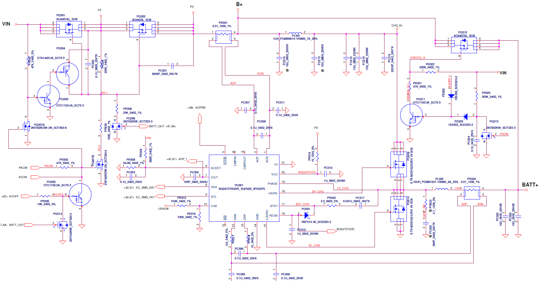

    I am attaching some schematics images
    Thanks for your time

    Re: Lenovo G500 - No power or charging
    I think PQ301 or PQ302 is damaged. Check resistance between Source and Gate. There is should not be a short circuit
      Unfortunately there is no short circuit between source and gate and that's why I have opened this thread. I am measuring about 200 Kohm which is the resistance of PR304
        PQ301 P CH is damaged change it.
          I will try to replace PQ301 and report back. Thank you very much
            if you have to point B + 19v is ok ... if you did not, change pq 301, pq302, pu301, check pr301, power button.
