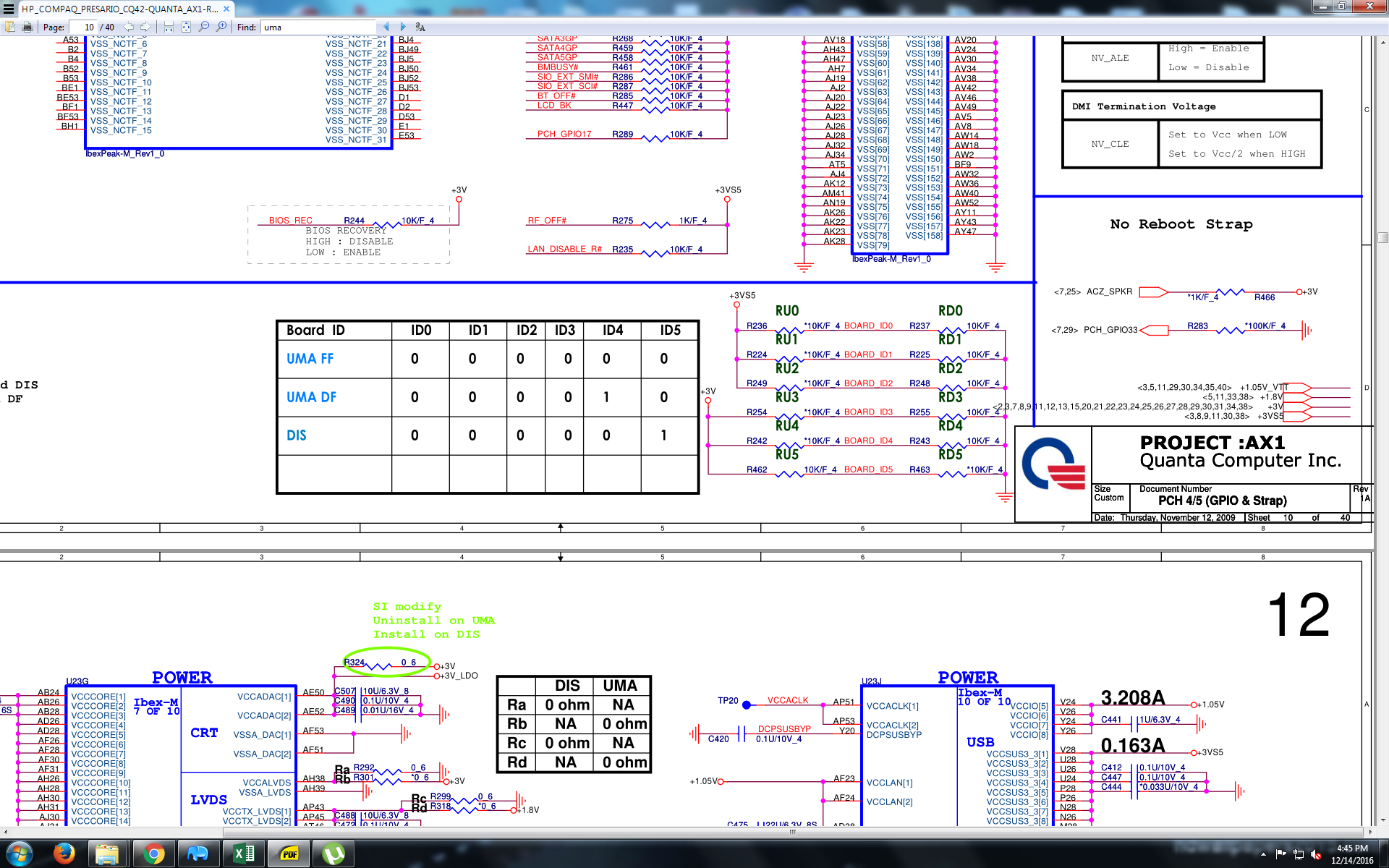

    Hi this is a machine that i reballed Gpu after 1year and now its come again with black screen .
    i need some help to disable gpu and to enable UMA but i dont know what resistor to replace ?
    need to remove R463 and to replace on R242 , and to remove coil of gpu exact? any suggestion please ?

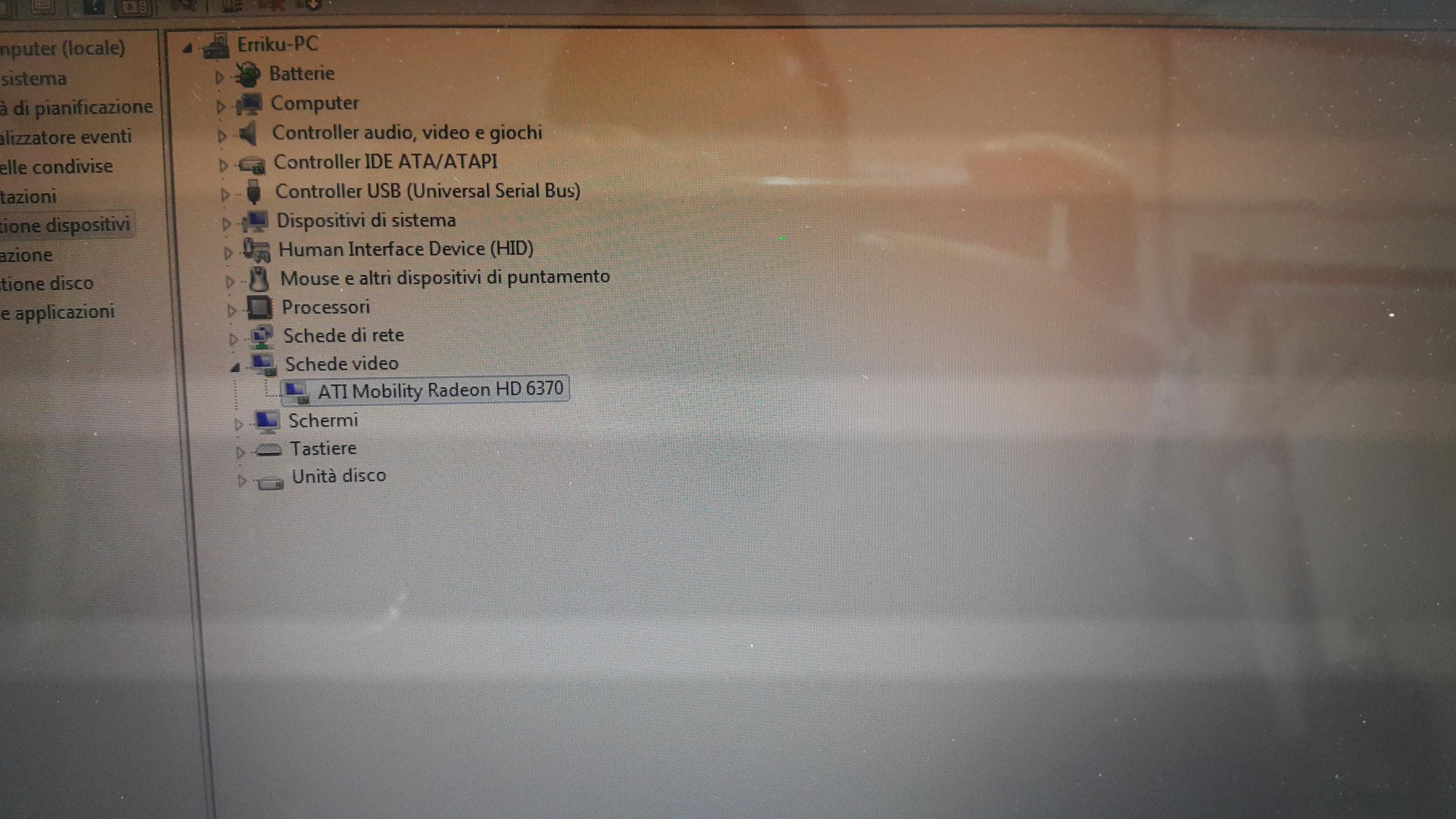

    i make i little reflow and this is only ATI HD 6370 . so this model can be UMA or not because i dont see intel graphic on device manager

        Re: UMA enable AX1J Hp
        do you know what is
        Board ID5: For idenify UMA and DIS
        Board ID4: For idenify FF and DF
        there are two tables page 10 and page 11
        can you make pictures of that area

          These are the pictures for some resistor like R242,R243,R464,R463 .
          Also i make some experiments :
          removed PU11 but again coil of gpu have 1.1v.

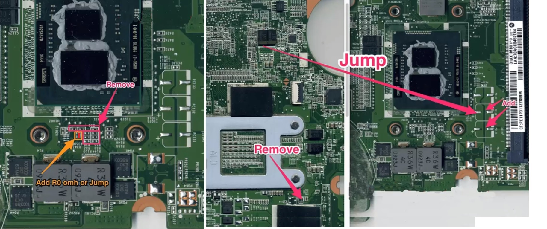

            found this and this, use google translate
            Code:
            http://kythuatphancung.vn/forum/index.php?/topic/36964-tài-liệu-hướng-dẫn-chuyển-share-cq42-cq62-g42-g62-quanta-ax1/?hl=cq42
            and this
            Code:
            http://wenku.baidu.com/view/cdf5ab5beff9aef8951e061a.html
            Main share transfer instructions CQ42 HM55
            The supplies needed:
            Schematics: Quanta AX1
            Boardview: Quanta AX1
            Tool view boardview kinds :
            Remove R350, R351
            R343 bypass (dual resistor)
            Remove R383 (= 0 In Socket CPU)
            Add capacitors C641, C642, C643, C644 (In Socket CPU)
            R426 = 4k7
            R724 = 0
            R196 = 0
            R195 (Ko any)
            R290 (LVDS_IBG) = 2K37 (OBTAINED 2K2)
            R305 (CRT's) = 10K
            R315 (CRT's) = 10K
            R317 = 1K
            C731 = C732 = 18p (XTAL)
            R462 to R463 Switch position
            Remove R510 = 0 hug
            R492 = 1M (XTAL)
            R497 = R498 = R499 = 150 Slim (CRT's)
            R500, R501 (HDMI)
            Add quartz Y2 = 25M
            RP8 -> RP9
            RP2 -> RP3
            RP4 -> RP5
            RP6 -> RP7
            RP14 -> RP16
            RP10 -> RP11
            RP12 -> RP13
            RP15 -> RP17
            RP0 -> RP1
            R80 = R125 = Remove R79 = 0 hug
            Add R309 = R310 = R311 = 0 hug
            R292 to R301 Switch position
            R299 to R318 Switch position
            RP18, RP19, RP20, RP21, RP22 (HDMI)
            R18 = R20 = Remove R22 = R25 = R28 = R31 = R34 = 0 Slim (CRT's)
            R19 = R21 = R23 Add = R26 = R29 = R32 = R35 = 0 Slim (CRT's)
            Add convergence PC130, PC131, PC132, PC133 (from VGA sources on)
            Question the power cord from the PC113, PC123 to PC131, PC132, PC133 (for enough wire to one bit line)
            Remove R324 (quartz Edge 25M)
            Add U14 (5v -> 3V_LDO) next to quartz 25M
            Remove the R52, R53, R54, R55, R56
            Remove the chip VGA and VGA RAM. Remove IC PU11
            i did not try this, only found on web
            good luck

                • vannix
                  • Mar 2018
                  • 74
                  • Italy
                  Originally posted by malangg
                  Best guide is...TESTED
                  not working.. the o.s. only recognize the amd radeon, and not the intel hd..
                        Checked recently, everything is working
                        This chinese triptich contains information which can not be found on on schematics and boardview, because both available only for socked CPU type. The rest is the same for both boards. So, simplified instruction to get image on integrated LCD, excepting CPU-side signals which are on "triptich" already:
                        0) Remove ATI
                        1) add R290, R305, R315 (for nominals refer to schematics)
                        2) add Y2 (25MHz), add C731, C732, R492 (these four can be easily found around any South Bridge on old dead AMD boards), remove R510.
                        3) move R462 to R463; R292 to R301; R299 to R318
                        4) move group of doubled resistors RP2,4,6,8, to RP3,5,7,9; RP10,12,14,15 to RP11,13,16,17; RP0 to RP1
                        5) move three single 0R resistors R79,80,125 to R309, 310, 311
                        6) Points between 2-nd and 3-rd pictures (where written JUMP) must be connected with thick copper wire.
                        CRT and HDMI function needs further rearrangements according to schematics and boardview program.
                        Good luck and peace to all!
