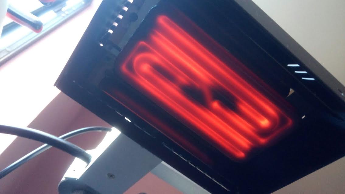

    Think I found what's causing the issue. Part of the top ceramic heater is not working.
    Anyone has a Jovy RE-8500 so that we can compare this?

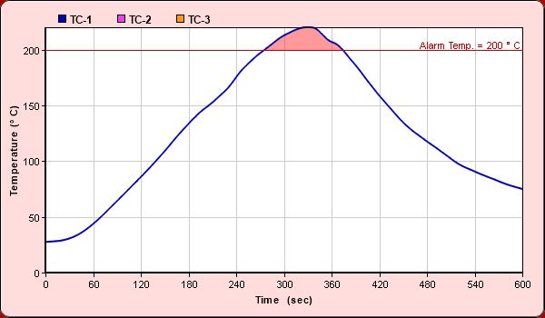

        I have attached photos of actual profile being used and the top heater with 'cold' spots.
        I think the heater is faulty.

          Re: Jovy RE-8500 issue
          Since the heater seems faulty, the machine's profile is not trusted.
          you have to measure chip's temperature using a thermocouple to see if the profile is applied correctly by the machine.
          also, measure how long the machine keeps a chip above 200'C.
                u made that picture? if so top heater is too hot and is going to kill and burn every chip.
                      Hello dellxps15, are you from Italy? We're neighbours then
                      Yes, I took the picture of that heater which is the upper element of the Jovy RE-8500. I put it in full power on purpose to that I can take a picture and show the 'fault'.
                      When the machine is operated, a reflector with a square hole would be be fitted over the ceramic heater so that the infra-red beam would be focused on the device under rework only.
                      By the way, the curve shows the whole process which is 10 minutes long and Do you think that in terms of maximum temperature values,temp rising and falling speeds, I am on the right track?

                        i have infrared too and with a 40 seconds of preheat at 120° whole process for desolder a lad free bga is around 6minutes and 50 seconds.
                        ofcourse it depend on the pcb. some pcb desolder exactly at 217° while others at 228-230° celsius.
                        my top height from bga is about 4-5 cm and power is around 70% max.
                        heaters have not to become that red, otherwise ull damage pcb.
                        good thing is put always good flux (not fake) under bga to make whole area temperature more stable.
                        edit: yes im from italy.
                        ps: dont use reflector. cover around bga with kapton and alluminium.

                                So your profile takes about 7 minutes to desolder a chip. Well, mine takes around 4 to 5 minutes to do that. Maybe this is too fast.
                                How about soldering a new chip? How long does it take to reach the peak?
                                I am using original Amtech NC-559-V2 flux (€20/10cc).
                                BTW, What is the brand and model of your machine?

                                  This is my profile for lead free.
