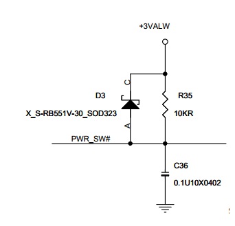

    hi guys
    i have another weird problem again
    when i plud ac,board turned on immediately,everything is true,even show display,but just for 2sec
    and then it dies
    just +3/5VALW is on
    not respond to power key
    when i press PWR_SW nothing happen on PM_PWR_BTN#
    but when i manually connect PM_PWR_BTN# to GND it turned on for secends and die again
    i program Bios&EC
    i replace KBC but no change
    there is no diffrence with or without cpu
    i hope someone help me
    tnx all

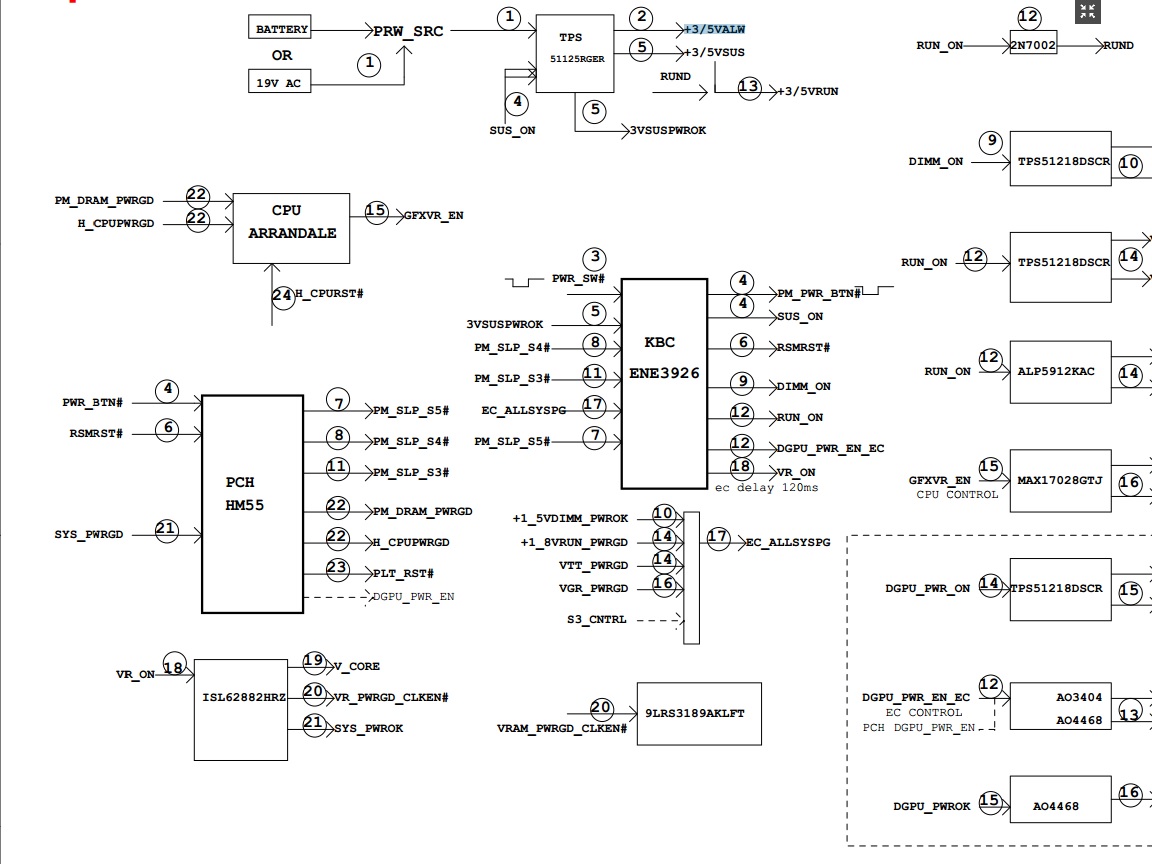

    Re: CR620 (MS-16881) turn on once for 2sec and then die
    The laptop turns off probably because a RUN voltage is not present after power-on.
    you have to check if all the powergood signals are OK after power-on.
    Specifically, pin17 of KBC.
    However, you have about 2 seconds to check these signals and voltages.
      problem was here
      PWR_SW# was 0.3V
      i replace R35
      nowPWR_SW#=3.3V and it works
        can you please share the block diagram and boardview for this model please
        • r ez a
          • Sep 2014
          • 39
          • iran
          i use MS-168A schematic
          its almost same
