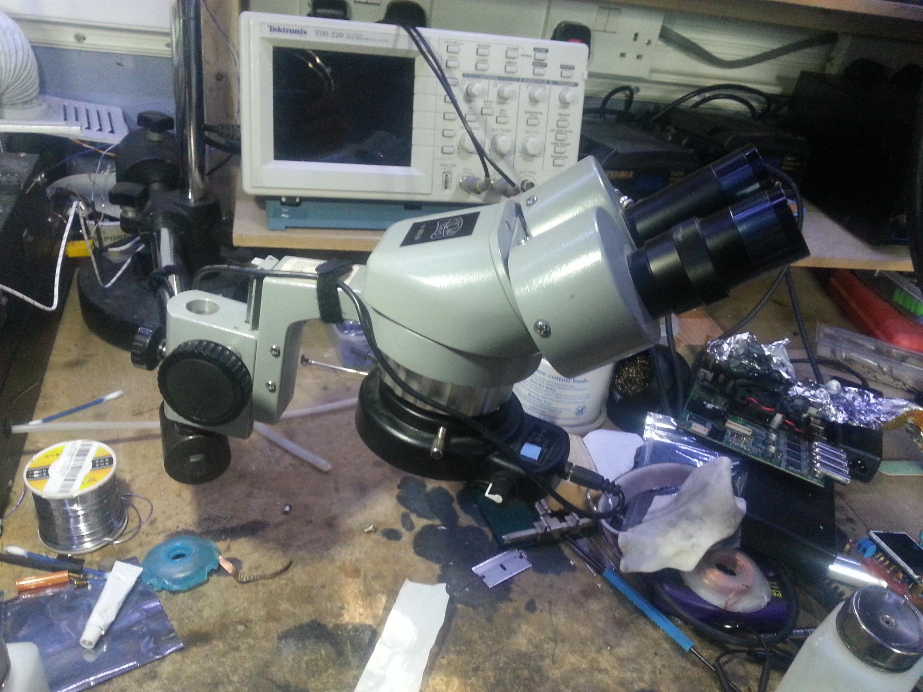

    Which from these 2 is best for smd rework, with plenty of space for the hot air station.
    Amscope SE402Y :
    http://www.ebay.fr/itm/400429192250?...%3AMEBIDX%3AIT
    Or the Amscope SW-3B24 (will add a 0.5X Barlow lens later) :
    http://www.ebay.fr/itm/140927800784?...%3AMEBIDX%3AIT
    If you have a sugestion for another (same price), feel free to post.
    Thanks guys

    The second one will give you more room to work under the scope due to the boom.
    I don't have an amscope but I pull mine over the workbench sometimes and then I can look vertically at boards and check the bga under chips.

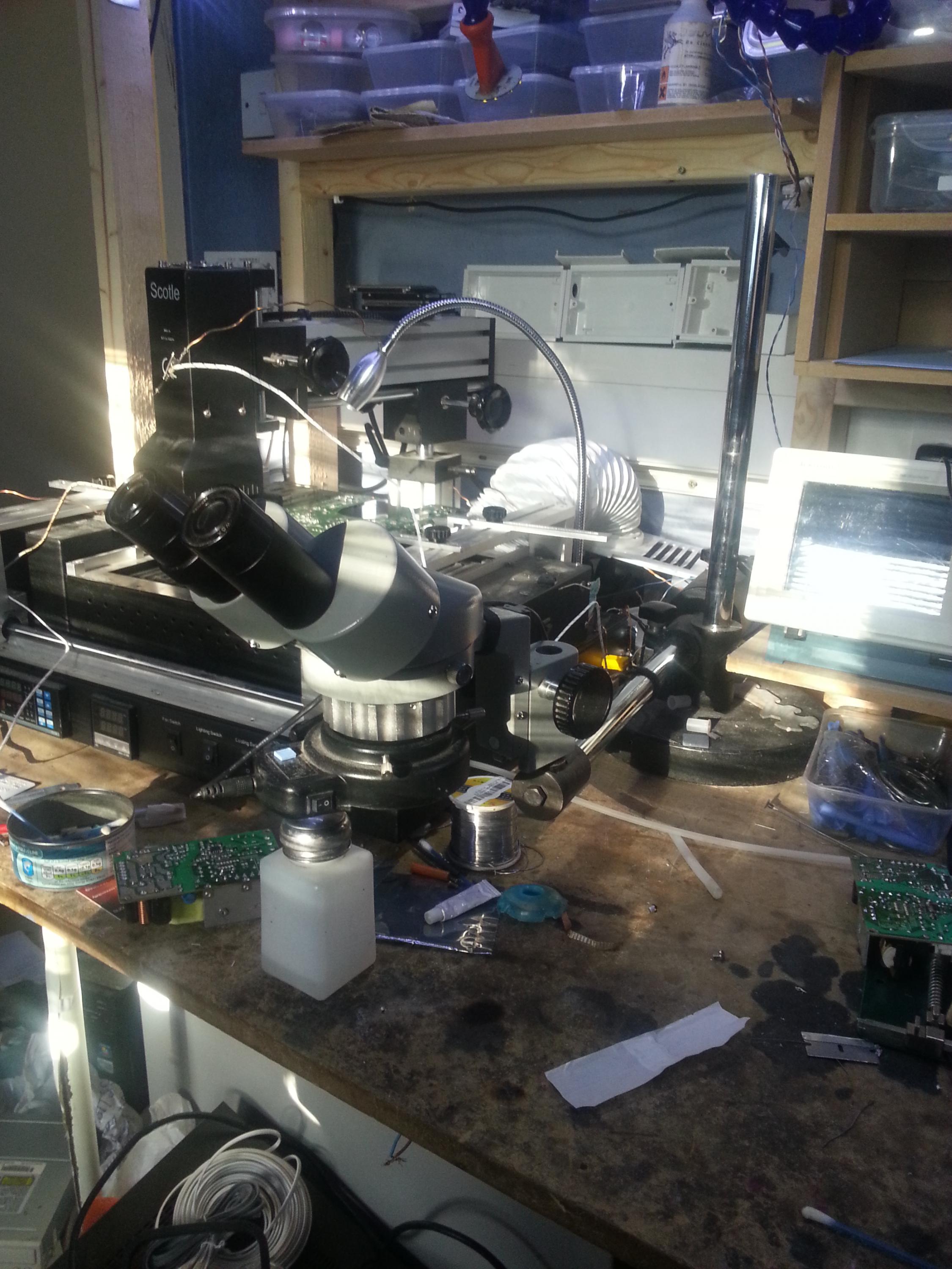

        Personally I use an old but very professional Wild M3Z with 1X lens and 10X ocular (only because is a present, it's a very expensive equipment) .
        AmScope Sw-3B24 has Both Ocular-Tubes with Adjustable Diopter I don't read if SE402Y has it, this type of adjustment is very important.
        probably you have to make changes if you use it with laptop's motherboards, because you need a plan where to put the card and center the area without difficult.
        Another aspect is the central lens, I can solder with hot air under it (my lens is made with glass) but if it's made in plastic you can damage it, you can modify it with a sheet of glass.
        the camera should be positioned inside the lens and not outside so the image is better.
        A magnification of 10x and 1x is enough unless you do not rebuild a damaged pad on a cell phone card or something like this

                I don't know the names of the lenses but my bottom one is 1x or 2x and the eyepieces are 5x. I do have some 10x for really checking things close but rarely use them. I mainly view at 5x.
                The LED ring light I bought from ebay which was where the scope came after lots of watching and waiting.
                dellxps15 - I would say any scope is better than no scope. Sure there is a bit of dust in mine and it doesn't really have decent height adjustment but would I pay a few hundred £ or $ for a new pro scope ? No, not needed.
