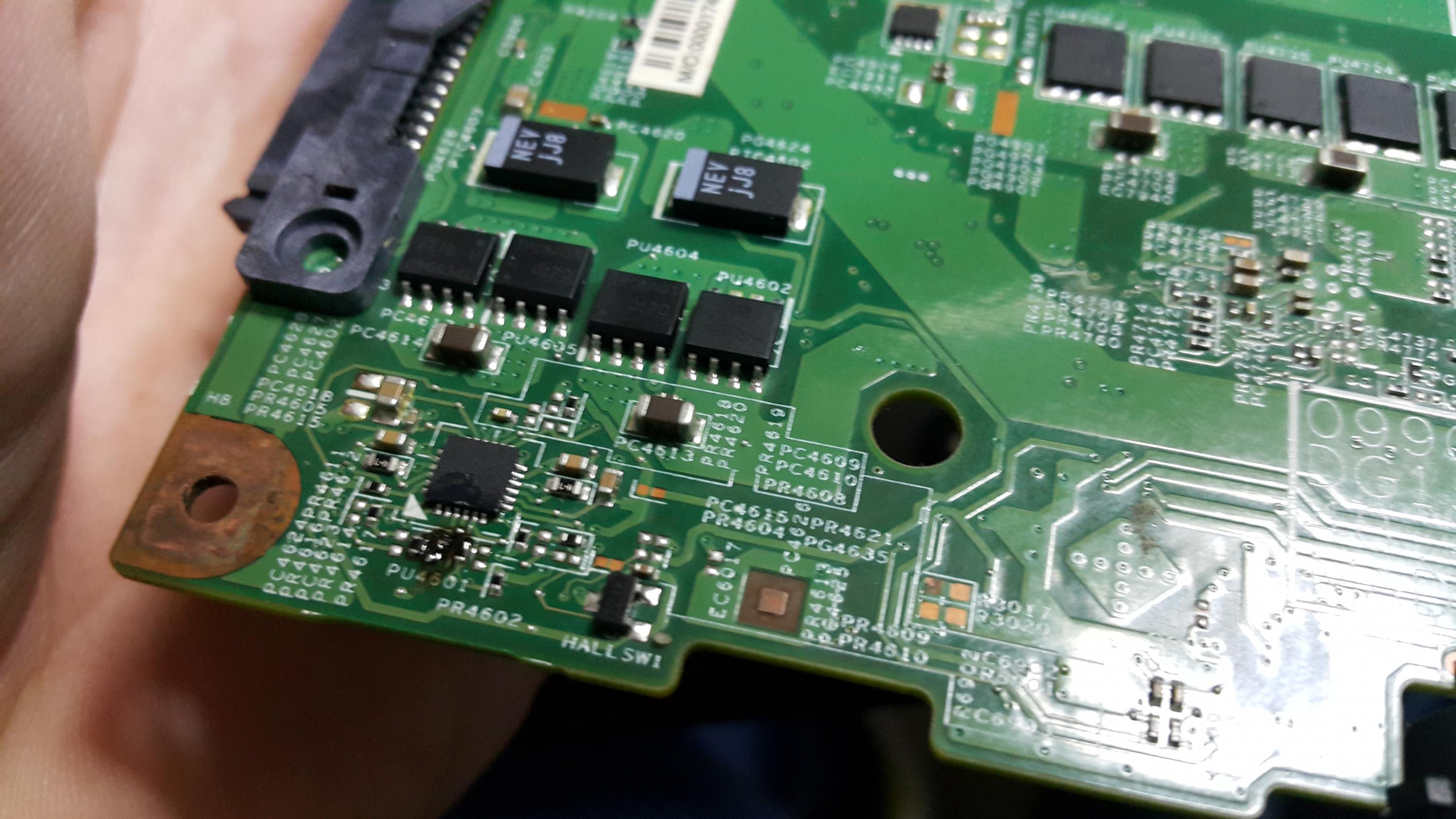

    Hi im working with this DG15 .
    the client has given a handful.
    i checked :
    PU4601 to hot , replaced with TPS51125 also to hot again , after i checked 2 mosfet low side PU4605 - PU4604 Shorted with Gnd . removed these and measured and are OK ,the short is on coil (PL4601 pin 1 -PL4602 pin 2) so
    3,3V_ALW and 5V_ALW are shotrted with gnd ,
    apply 3.3v 3a on shorted side of coil PL4601 And heat up Igp HM57
    apply 5v 3a on shorted side of coil PL4602 And heat up Igp HM57
    so HM57 is to replace or any other suggestion?

      Re: N5010 DG15 shorted Mosfet 3.3-5v Low side
      Yes, PCH is going to be replaced.
        hi today i m working with another DG15 identical problem , but on this not heat up anything no 3,3-5v and these coils are shorted with ground no 3,3v_pwr and 5v_pwr.
        when i apply voltage with PSU nothing heats up . any advice please
        • gcomputers
          • Apr 2013
          • 509
          • Albania
          solved ,i find on pin 3 REF of PU4601 pc4623 burned
