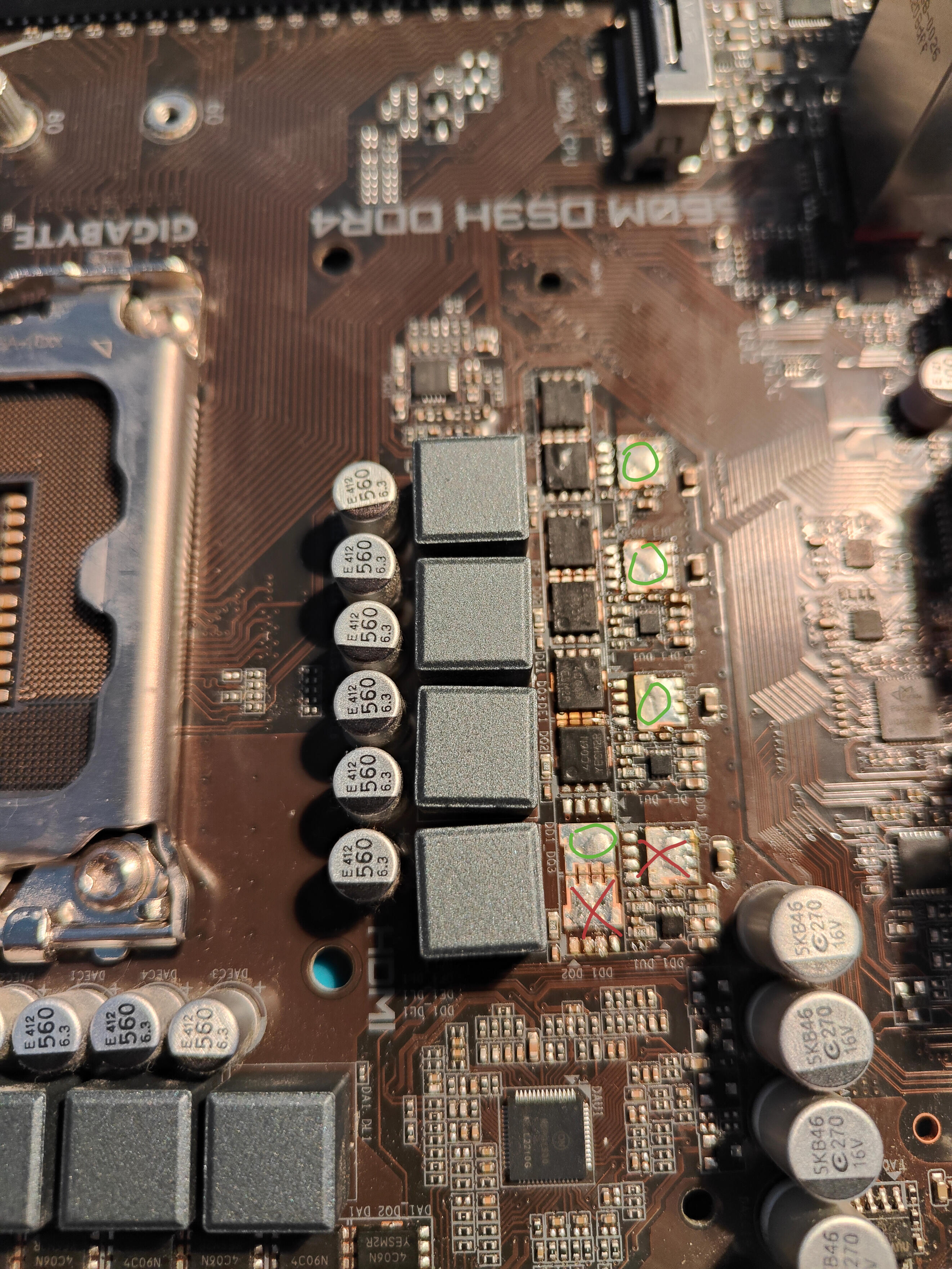

    my motherboard, a Gigabyte b660m-DS3H, broke last night, and I'm trying to fix it.
    The symptoms are as follows:
    - The PC doesn't boot when the CPU power supply is connected (without CPU).
    - When voltage is applied to the CPU connection, the three phase 2 MOSFETs start to heat up. The other MOSFETs do not heat up.
    The phases are made up of one high-side and two low-side MOSFETs.
    My hypothesis is that if the two Low MOSFETs are hot, they must be permanently ON, even when the High is ON, causing a short-circuit.
    Do you know how I can test the driver? Do you have any advice for a case like mine?

          I found two mosfets short-circuited.
          The others are OK.
          However, when I measure directly on the motherboard, without the mosfets, between the gate and the source, I find 15k ohm (the value rises slowly).

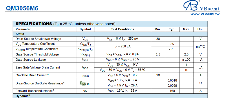

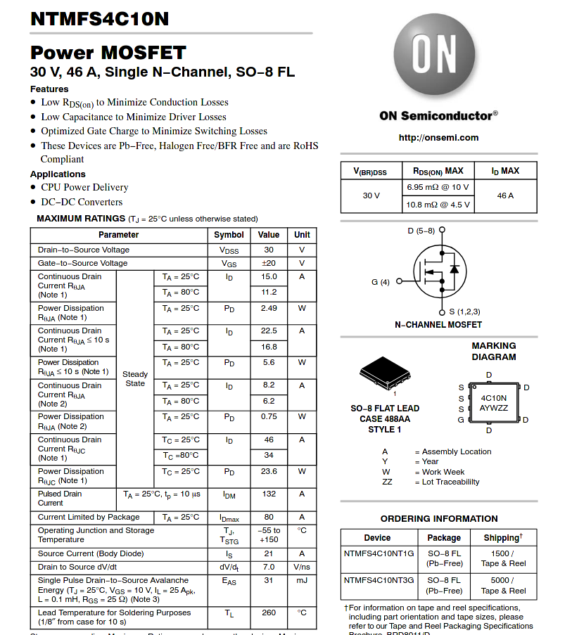

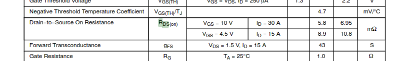

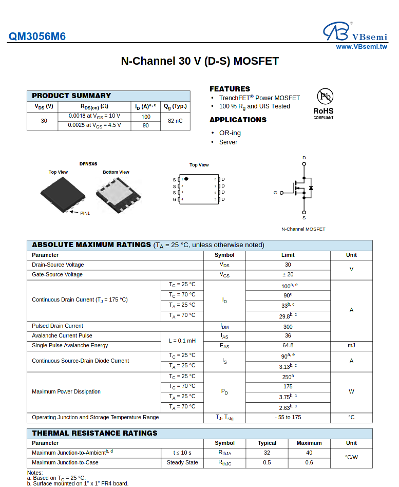

              Can i use this QM3056M in replacement for NTMFS4C10N ?
              (QM3056M have lower Rds(on), same Vdss, Vgs and bigger Idmax)

                  No. All phases should use the same MOSFETs so that they stay as balanced as possible. Also, QM3056M has much worse switching characteristics, much harder to drive and much slower to switch on/off which can make it less efficient.
                  Also as always the MOSFET driver has to be replaced at the same time as the MOSFETs.
