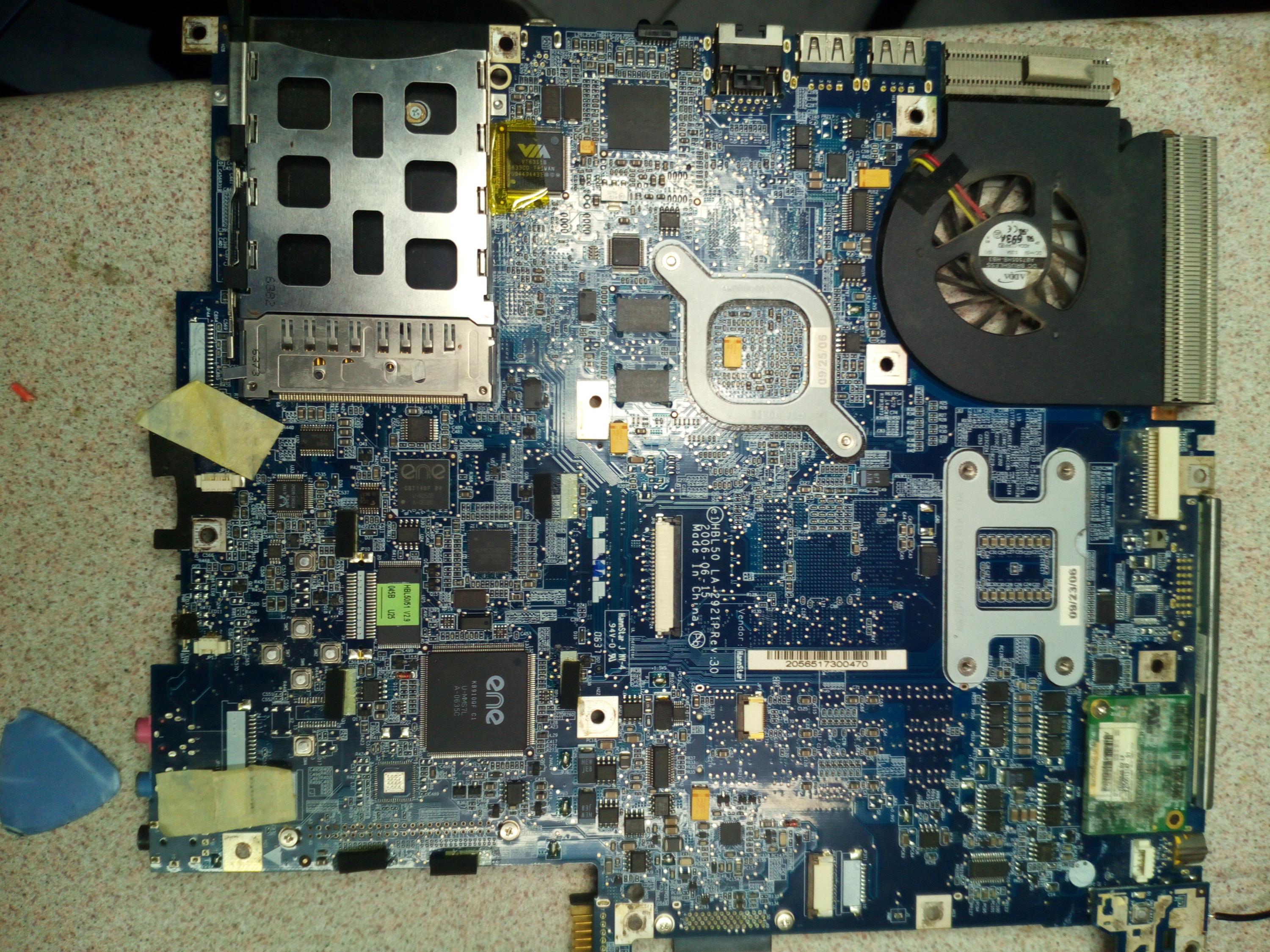

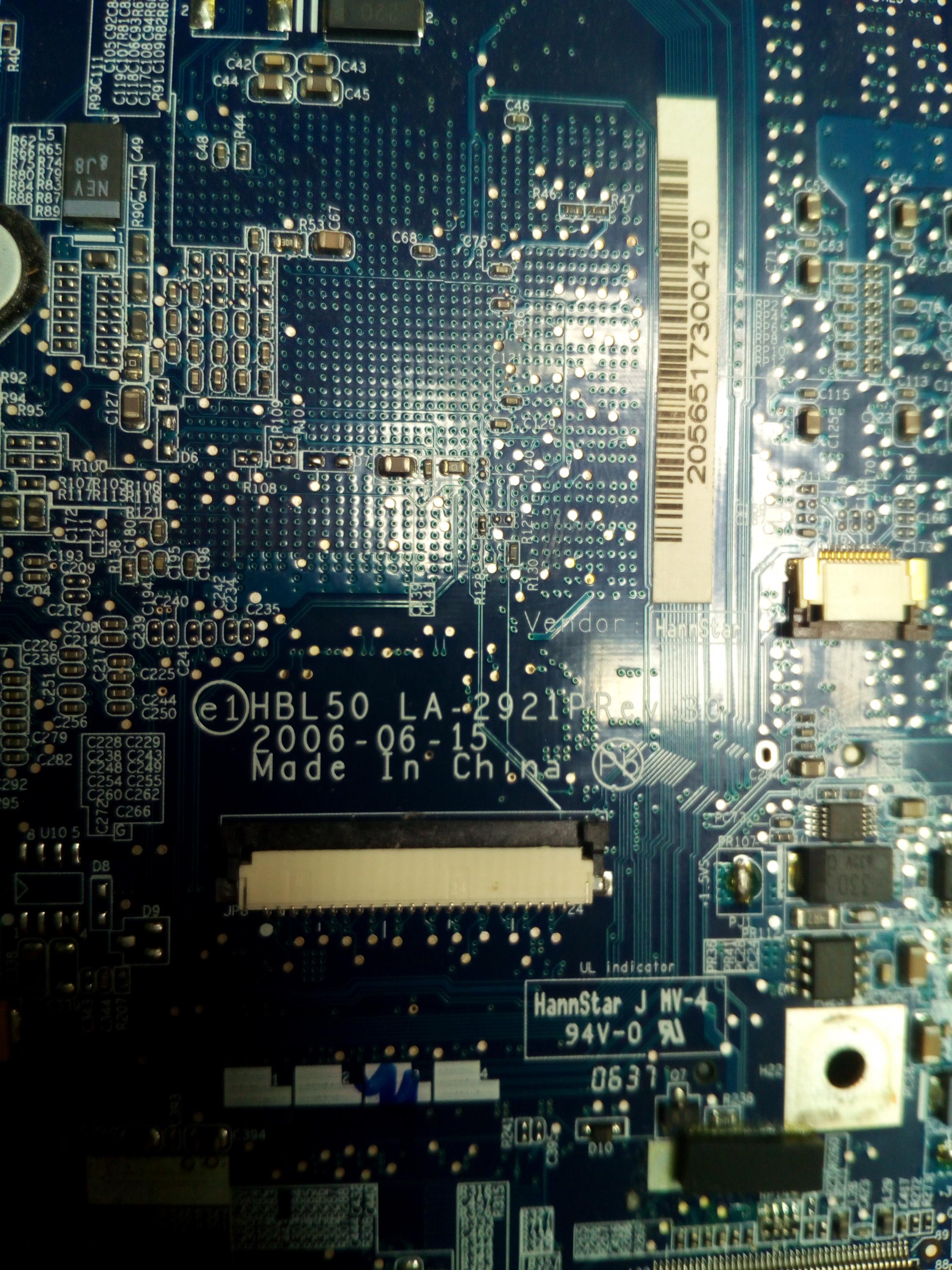

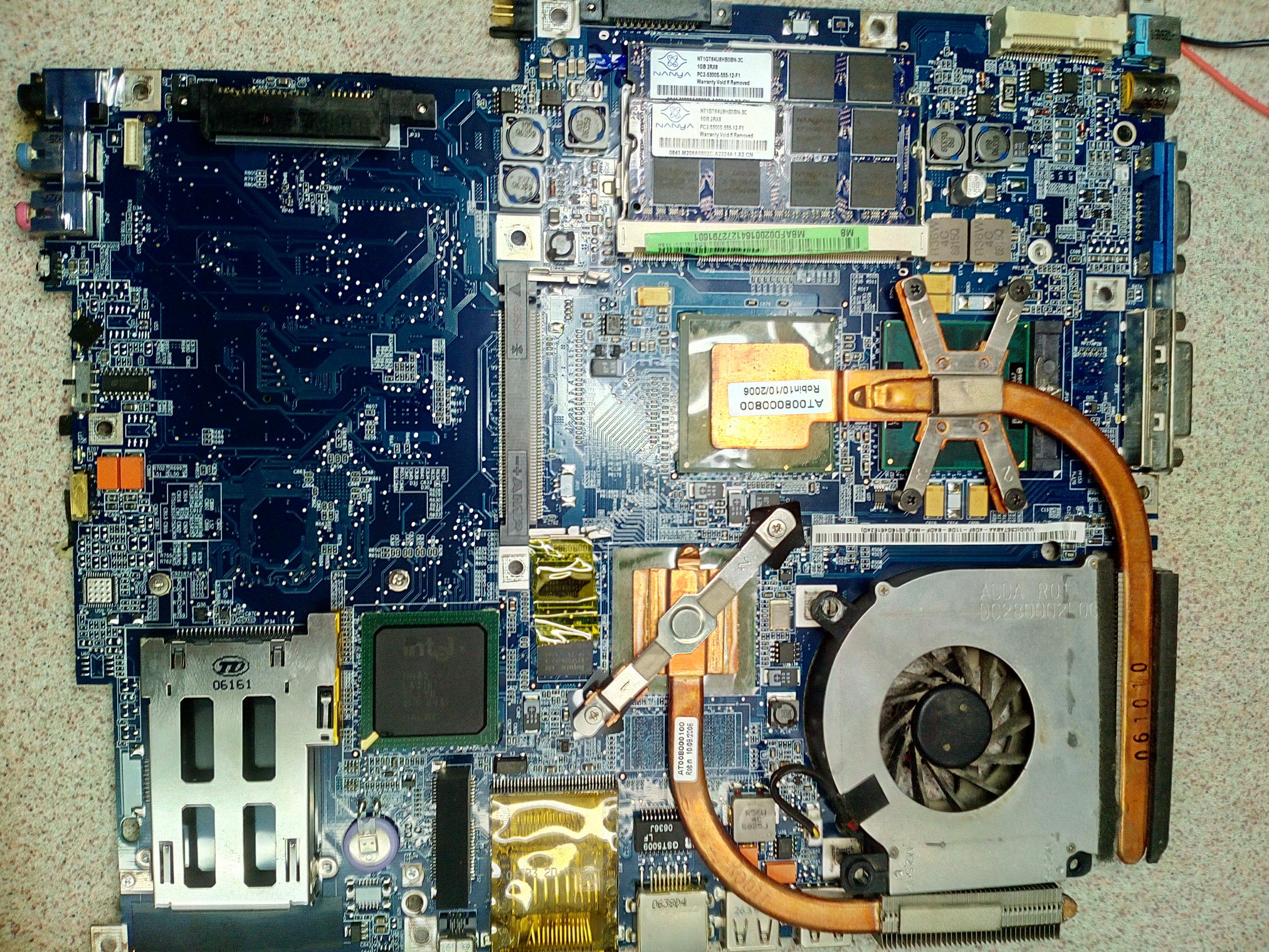

    I have an acer aspire 5680 BL50 which doesnt power on at all. No led,no fan spining, nothing.
    I checked power adaptor (I connect it with bench power) DC jack all ok.
    I have 19V in PU4 MAX1908ETI_QFN28 1pin DCIN but I dont know what pin is the output or what to check next.
    There is no damaged component with visual checking.
    I upload pictures from both sides of the board and the schematics.

    Anyone, a little help.
