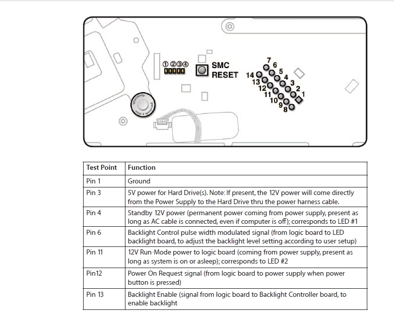

    When i plug ac cable fan seem turn on but after 2 seconds turn off and start again. Screen remain black.
    Any help?
    LED1 is ON, LED2 is blinking

        Here is where i would start go to page 1 i would look at PP12V_G3H
        LED #2
        • Indicates that logic board has detected power from power supply when computer is
        turned on. This LED will be ON when computer is turned on and power supply and voltage
        regulators are working correctly.
        got that from the manuel.

          Have 12 volt on pin 1 of J600 and incostant voltages on pin 2 and 3 of J600 about 2 volts

              Yes removed all,just power supply and logicboard. I have checked all, no short, reflashed bios and removed GPU card. Seem want turn on,fan start for 1 second and then go off

                ok then inject 12 volts on pin 2

                      on pin2 i dont have 12v but 0,7 to 2V variable

                        ok then when you inject 12volts on pin 2 what happens does thte voltage stay up or go down ie we are looking to see if there is a short on that rail.

                          When i put 12volt on pin 2 turn on and fan go to max

                            Looks like power supply,have a look at this see if it helps

                              UPDATE: i have replaced logic board and work, then also if can see a power block issue the problem is logic board. (i dont know what).
