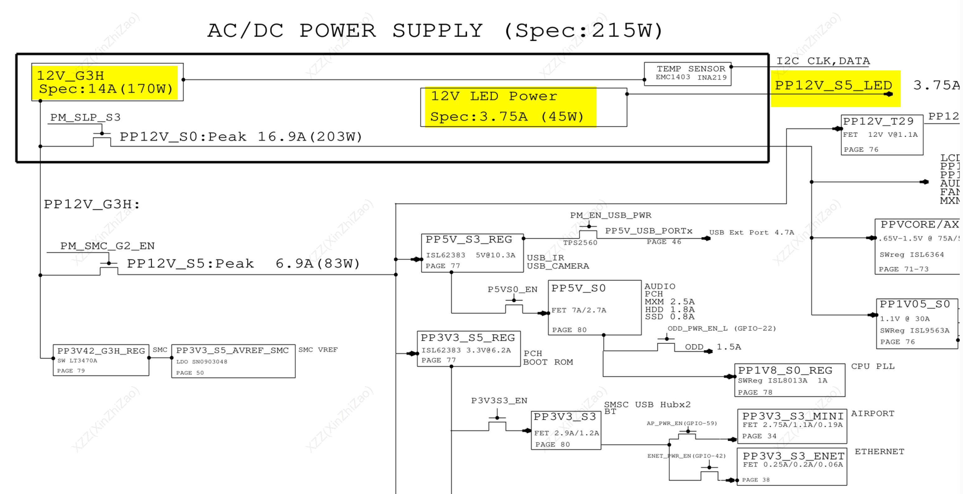

              Review sheet #3 of the schematics which offers the 'power block'. Start with the root voltage from the external power supply. Be very careful here due to the open frame power supply design. A shock can be lethal. With no power to the unit, apply a cardboard protector onto the power supply connections to insulate this shock hazard.
              Then confirm that you have a stable 12v each and everytime you power on.

                Hi mon2, I followed your advice and connected the power supply safely (see the picture). When I connected the power plug, the first of the four LEDs lit up. I measured at this time the PP12V_G3H on C8111 and it was stable at 12V. I then turned on the iMac through the switch pins and, as often happened, the first LED went out. I measured PP12V_G3H on C8111 again and 12V was still present. I checked the mainboard and nothing seems to be overheating at this stage
                Thank you again for your very kind help

                  The LED that is turning off is LED501 ('It is plugged in') and is driven by PP3V3_S5.
                  Remove all power. Meter in resistance mode. Measure the resistance to ground (not diode mode) of PP3V3_S5_REG @ L7710 (pin 1 but either side should be ok). Post the measurement.
                  We are checking if there is a shorted cap on this power rail which is being sensed as an excessive current draw by U7700.
