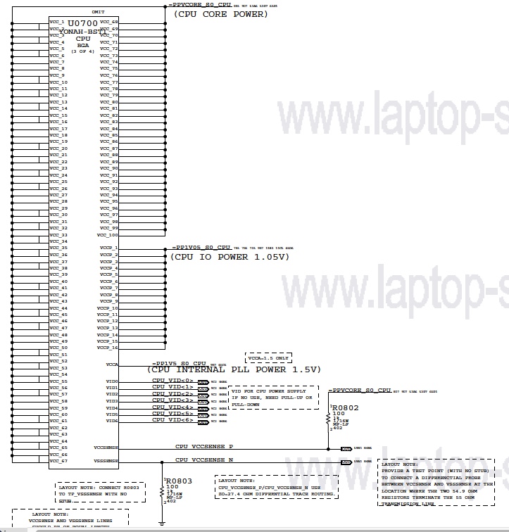

    I first thought that the U0700 CPU might not be getting power. U0700 requires three sources of voltage - CPU CORE POWER (PPVCORE_S0_CPU), CPU IO POWER 1.05V (PP1V05_S0_CPU), and CPU INTERNAL PLL POWER 1.5V (PP1V5_S0_CPU).
    On the top side of the logic board, I detect ~1V at PPVCORE_S0_CPU and correct voltages at PP1V05_S0_CPU and PP1V5_S0_CPU. I have not yet flipped the board to verify that these voltages reach U0700. However, after powering the computer on with the power button, the fans eventually run at full speed speed presumably due to CPU heating.
    I'm hoping that members here can suggest some logical troubleshooting to help me diagnose this problem.
    I have the 820-2054-B schematic and boardview, if additional information would be helpful.

    The diagram below shows the three power inputs for the CPU.
    Also attached are the 820-2054-B schematic and boardview.

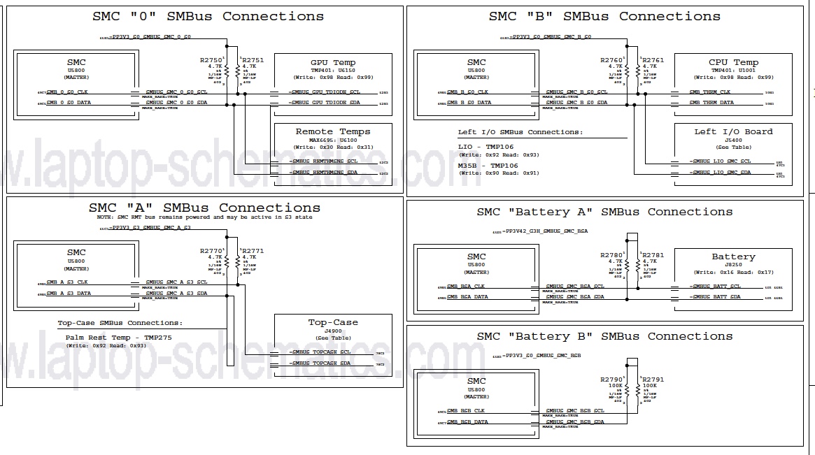

      Also, does the fact that, after connecting power, the fans initially run at low speed but in less than 30 seconds run at high speed suggest an issue with the CPU thermal sensor circuit?
      Any thoughts?

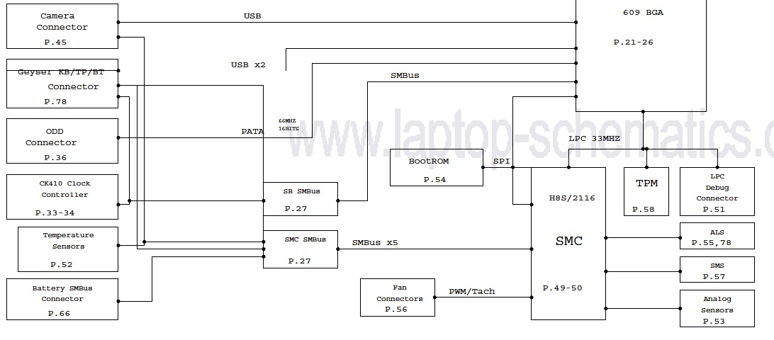

          Looking for a connection between symptoms of high fan speed and the computer starting itself without a power button signal, I see that both functions are processed by the U5800 SMC chip (see attachments).
          Thoughts? Diagnostic tests?

            I re-measured the three sources of voltage for the U0700 CPU:
            1) PPVCORE_S0_CPU should read 1.1V. At R6220 and R7507 in this circuit, I read 0.93V. **Is this reading too low and potentially the cause of the problem?**
            2) PP1V05_S0_CPU should read 1.05V. At R0720 and R0721 in this circuit, I read 1.042V.
            3) PP1V5_S0_CPU should read 1.5V. At C0980 and C0981 in this circuit, I read 1.49V.

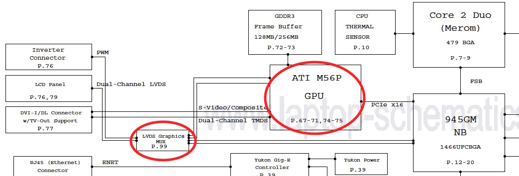

                Do you know which graphic chip? Would a problem with said chip, if bad, cause all of these issues:
                *Computer immediately powers up and fans run without shorting power button pads on logic board.
                *On power up, chime is not heard, and CD/DVD drive does not activate, though white light on screen latch turns on.
                *Both fans initially run on slow speed, but ramp to full speed in about 30 seconds.
                *Display does not illuminate.

                  Re: Apple MacBook A1211 (820-2054-B) - no chime
                  its normally ati or nvidia
                  • boofoo
                    • Jul 2016
                    • 14
                    • U.S.
                    One of these chips (see attached)?

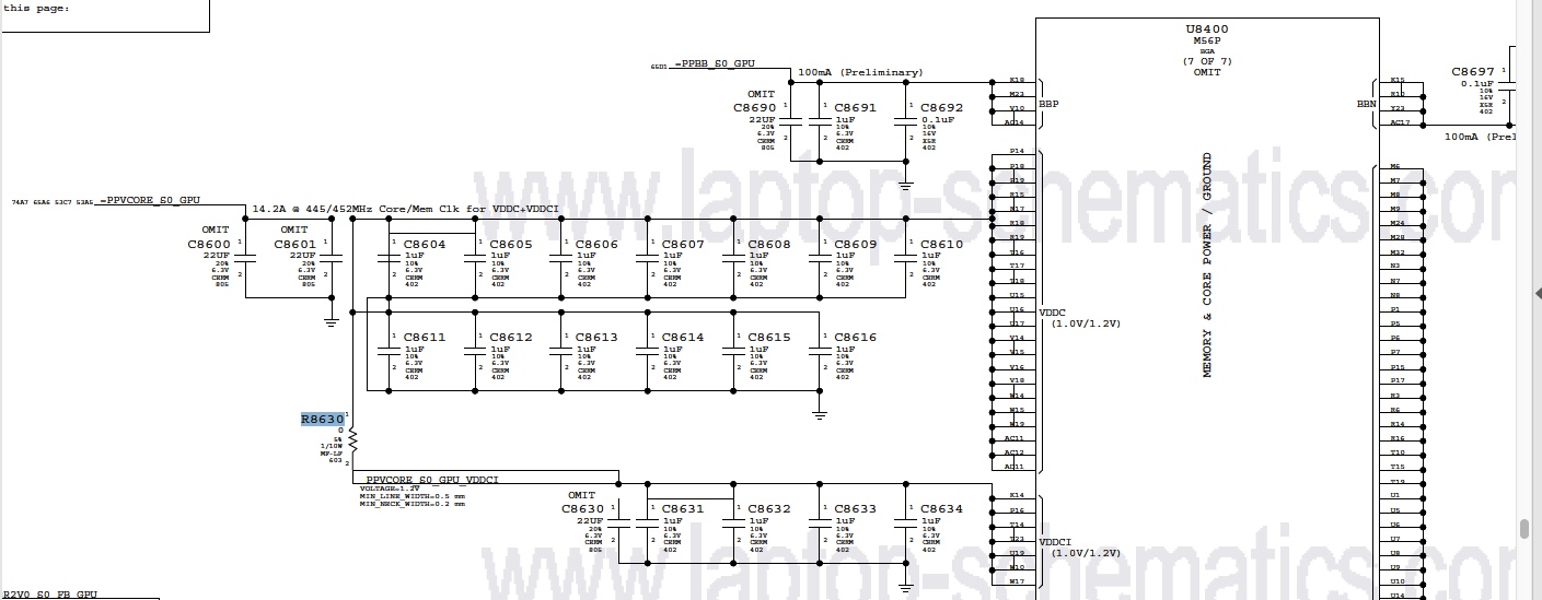

                      Thanks. Based on your tip, I made some voltage measurements on the PPVCORE_S0_GPU that supplies 1.1 volts to U8400 ATI M56P GPU. I immediately found two problems:
                      1) R8630 (0 Ohm) = 1k Ohms, 1.047; In addition, both pins are grounded. This resistor connects to VDDCI pins of U8400 ATI M56P GPU.
                      2) L9140: Both pins are grounded, and the component looks blown. This inductor connects to MPVDD pin of U8400 ATI M56P GPU.
                      Looks like I'm chasing a short to ground in the VCORE GPU circuit.
                      Thoughts? Suggestions?

                        R8630 is definitely blown, but bypassing the resistor with a jumper wire had no effect on the problem.
                        L9140 turns out to be fine.
                        So...the problem still remains a mystery.
                        Where should I look next?
