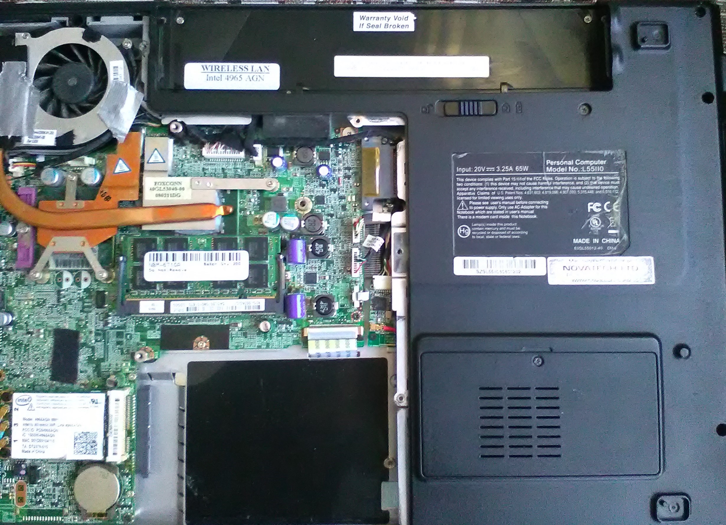

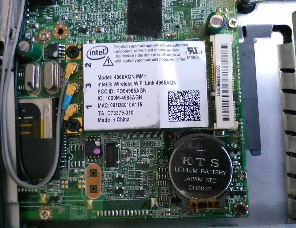

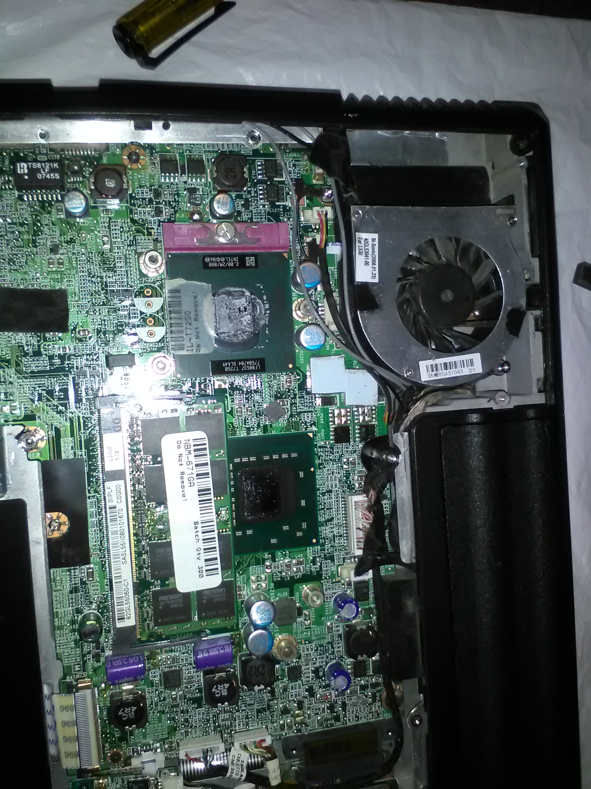

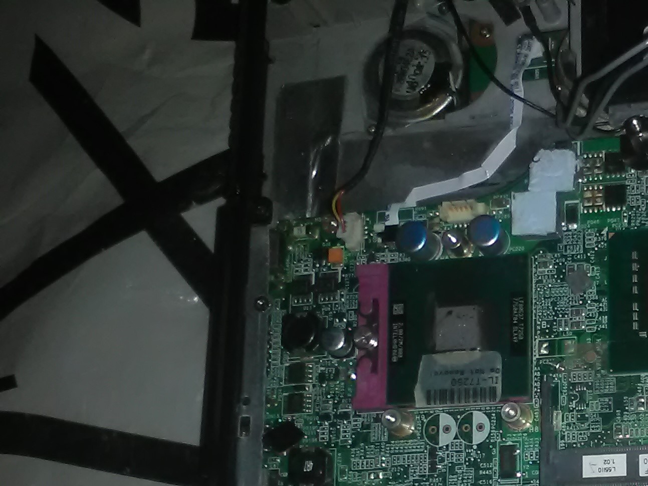

    I got this Laptop made by Novatech.
    Rasor Pro Uniwill L55II0.
    The LCD screen is broken needs to be replaced. I know how to do it, where is good place to buy new or used?
    The battery power plug is broke, I have pictures of the motherboard.
    Let's look at he caps folks.
    What soldering station irons in the UK do you lot buy and from where?
    Any help is appreciated.

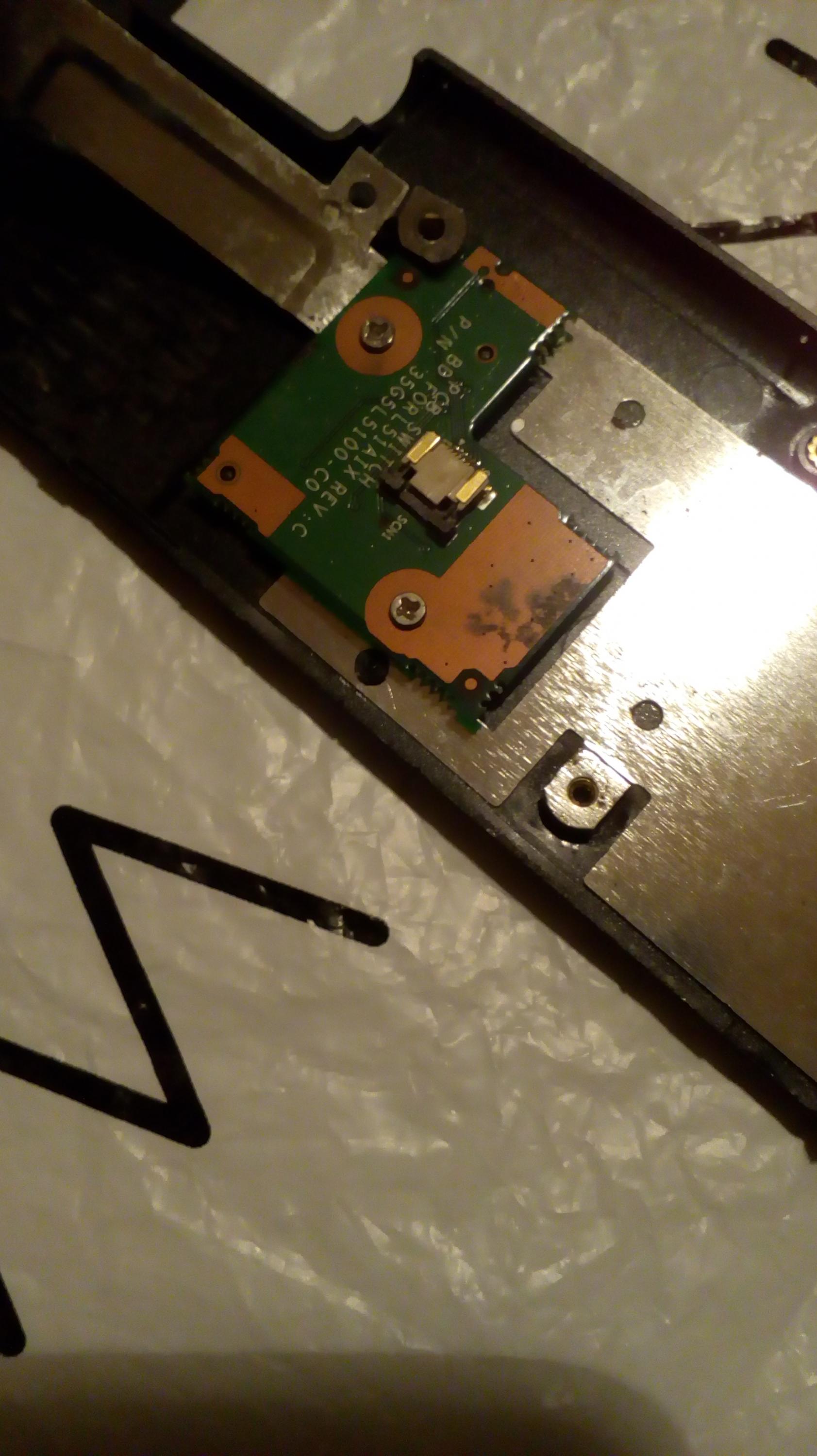

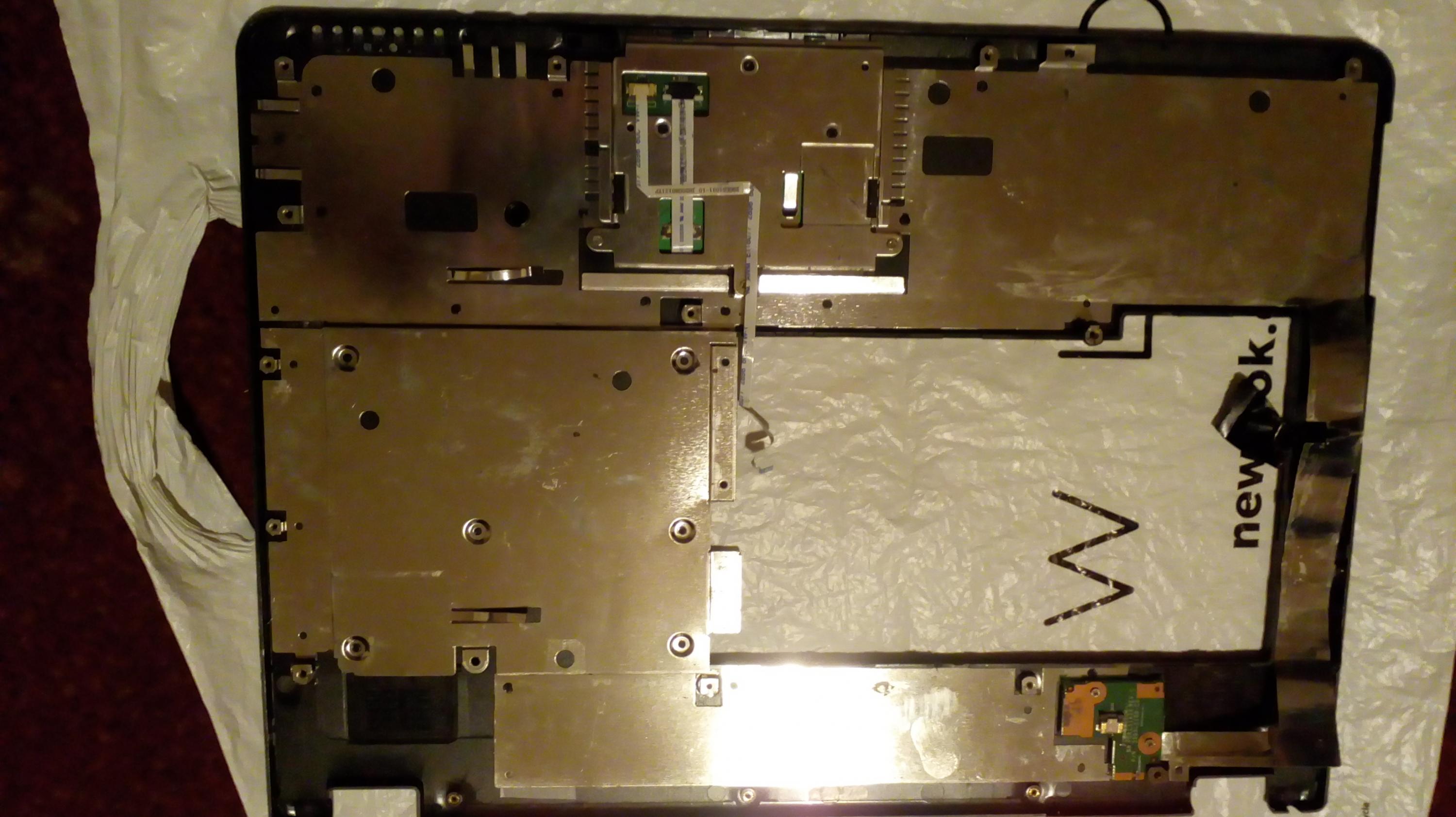

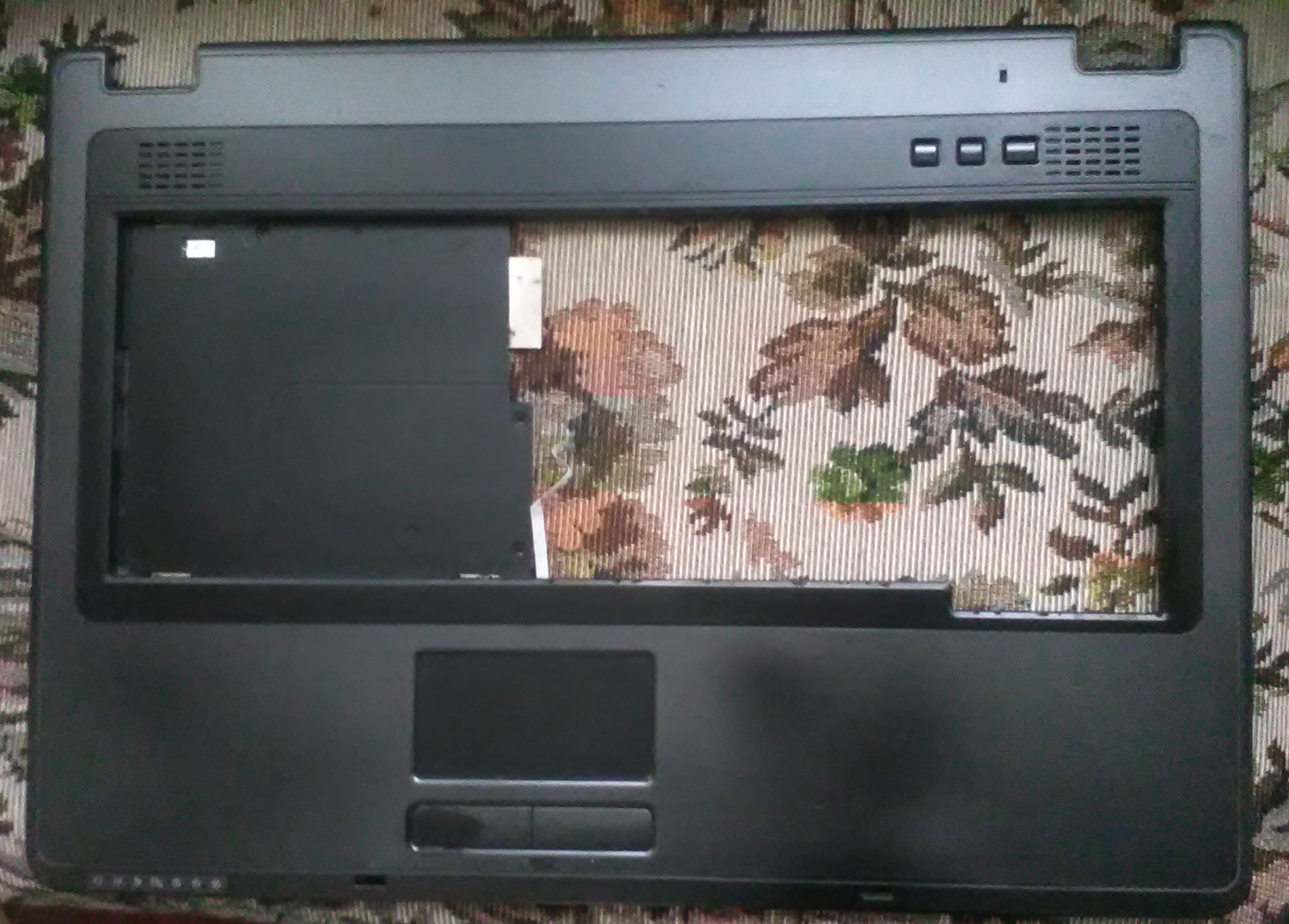

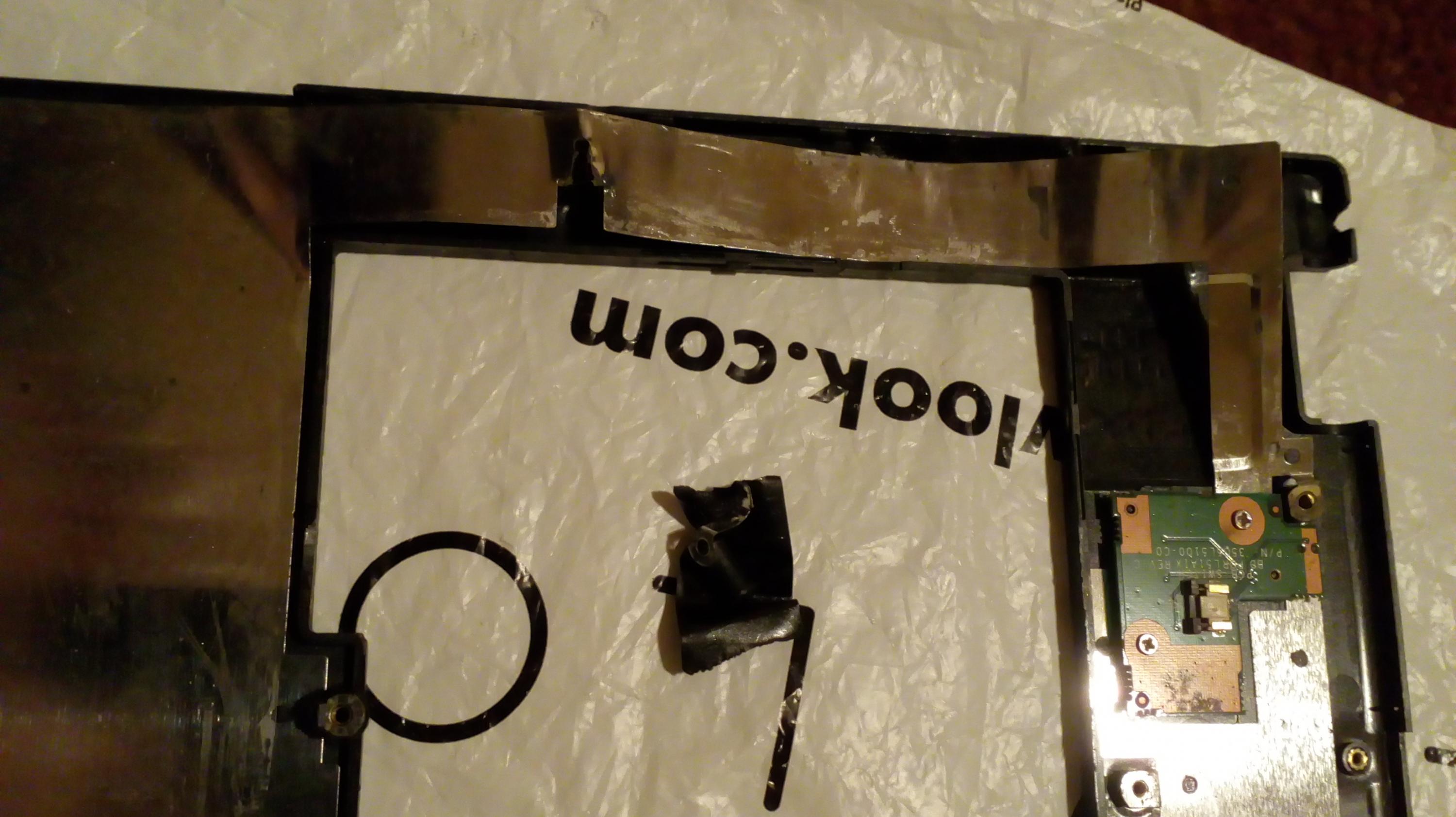

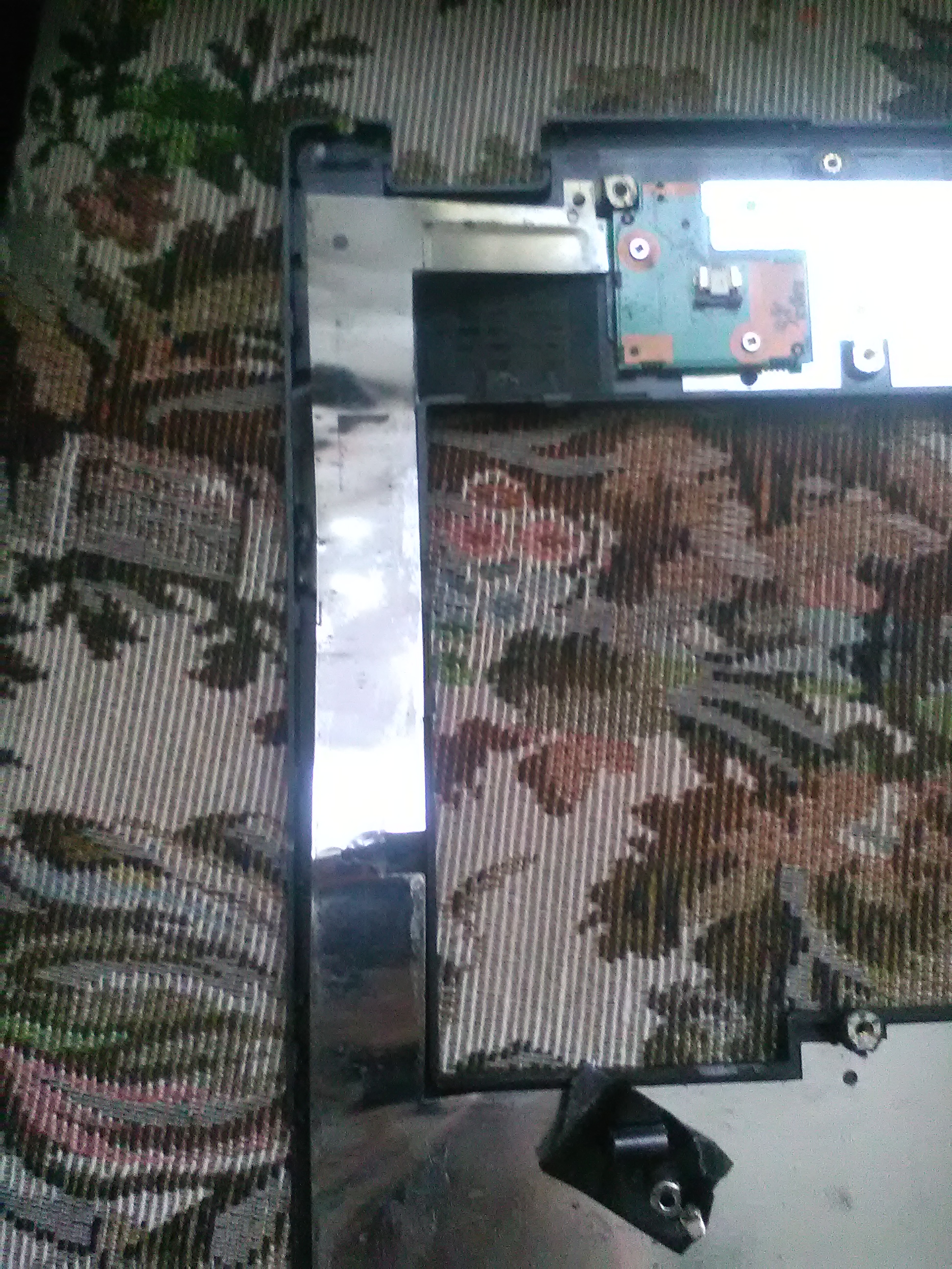

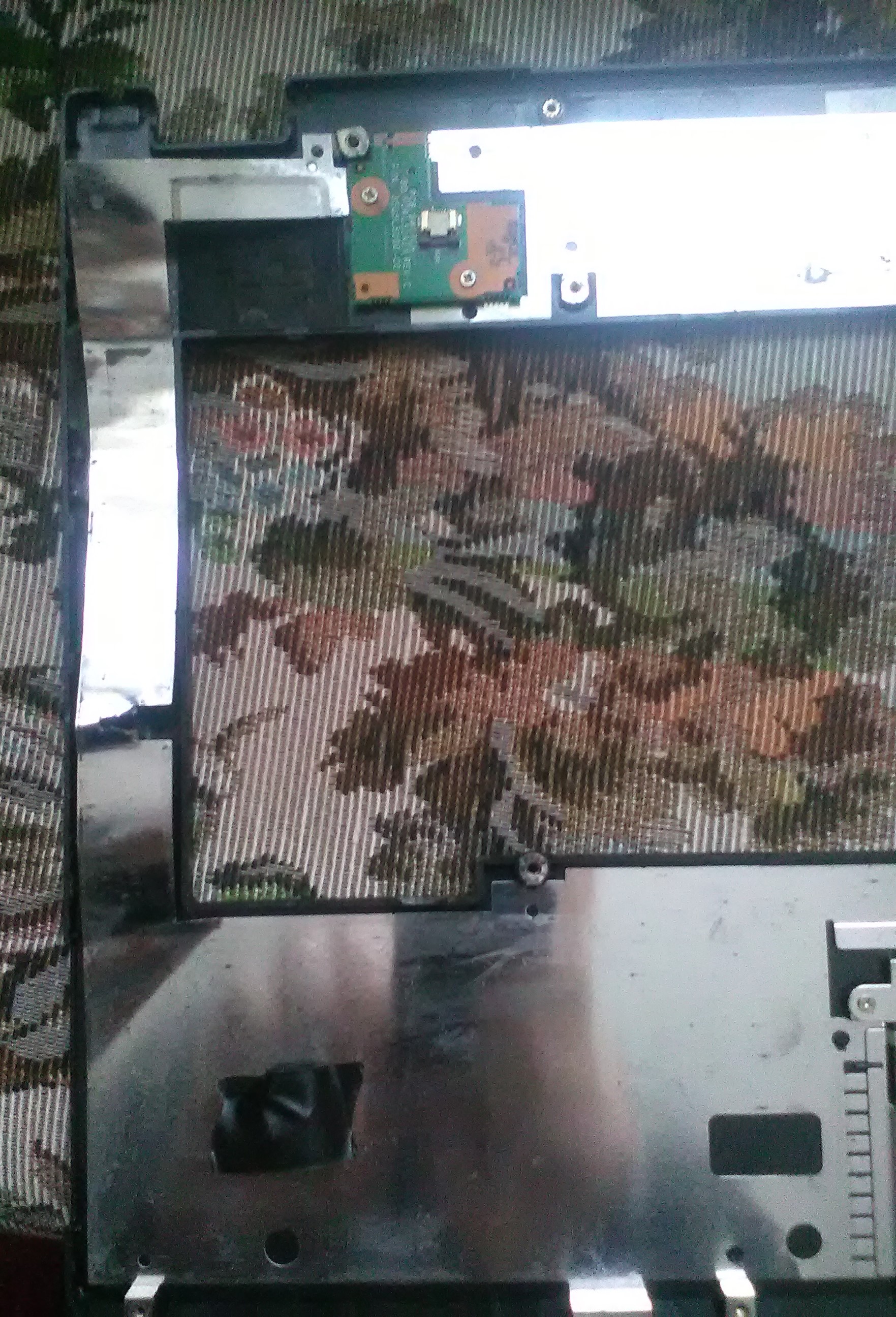

            Re: Novatech Rasor Pro NOVATECH L55II0
            I took off the palmrest of the laptop, then I accidently took off a screw part. Then the silver metal came off, I need to stick it back down, it looked like sellotape underneath.
            I don't know how to put it back on, it was really difficult.

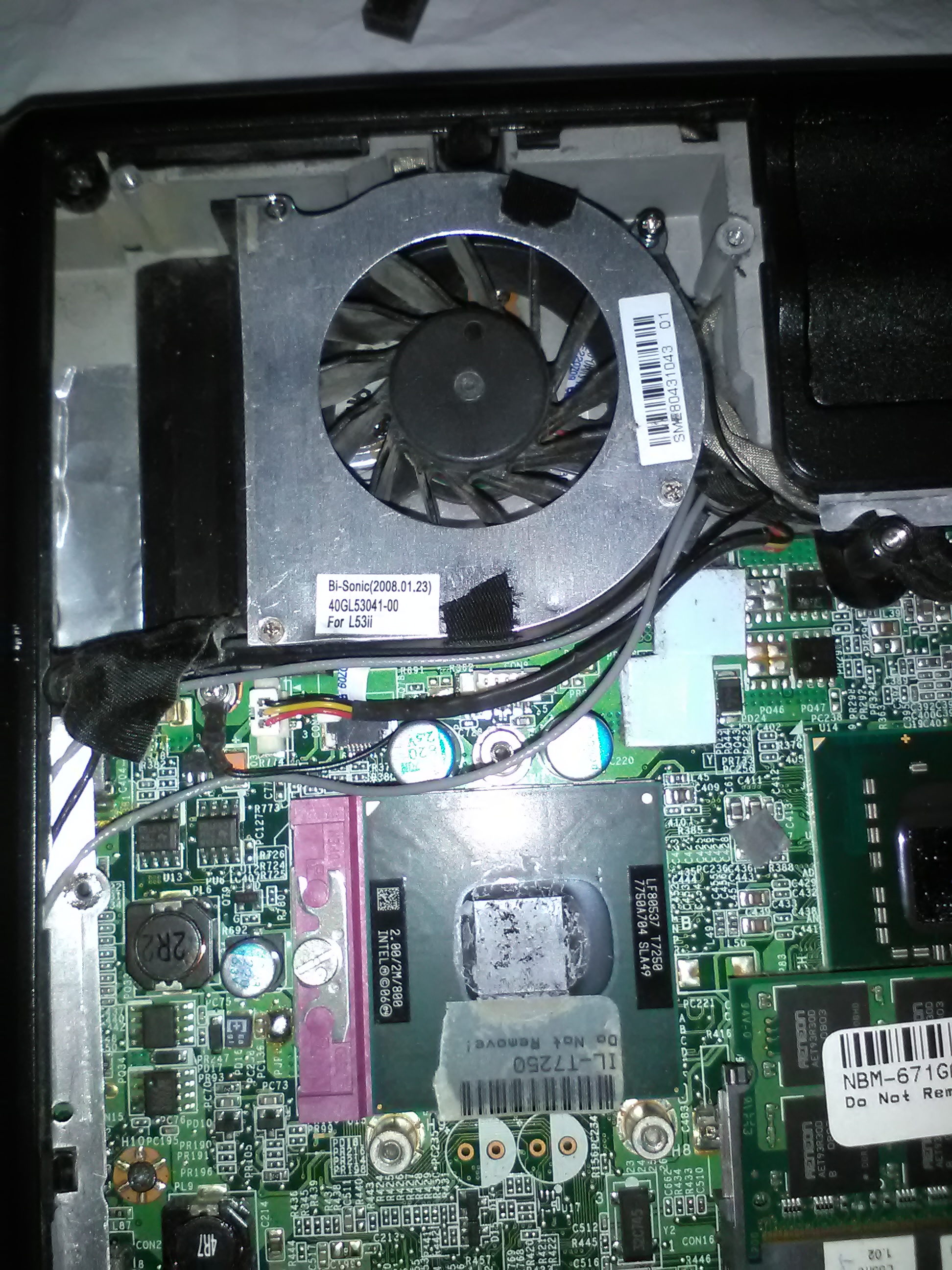

                Got the laptop to power on, but now theres a loud grinding sound?
                  Something catching in the fan ?

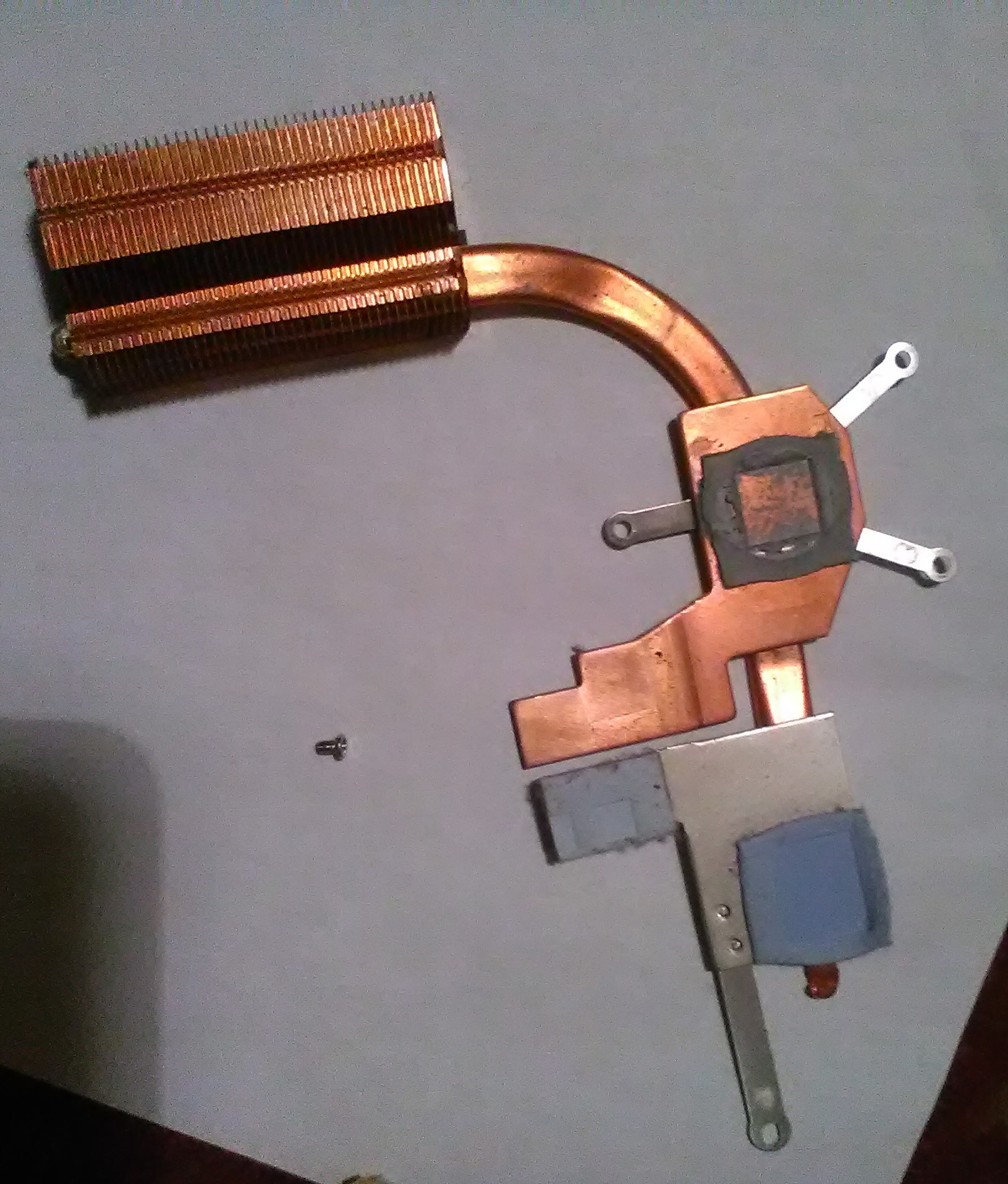

                    When I looked at the fan I pulled a bit on it, so there was no touching it. It looked like the out part was touching it when I spun it.
                    Also when I had the Laptop on it side there noise went away.
                    I put the cpu fan under a tap, there was a lot of dust on the blades.
                    So I will let it dry out over night.

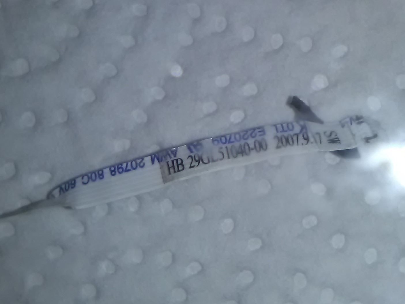

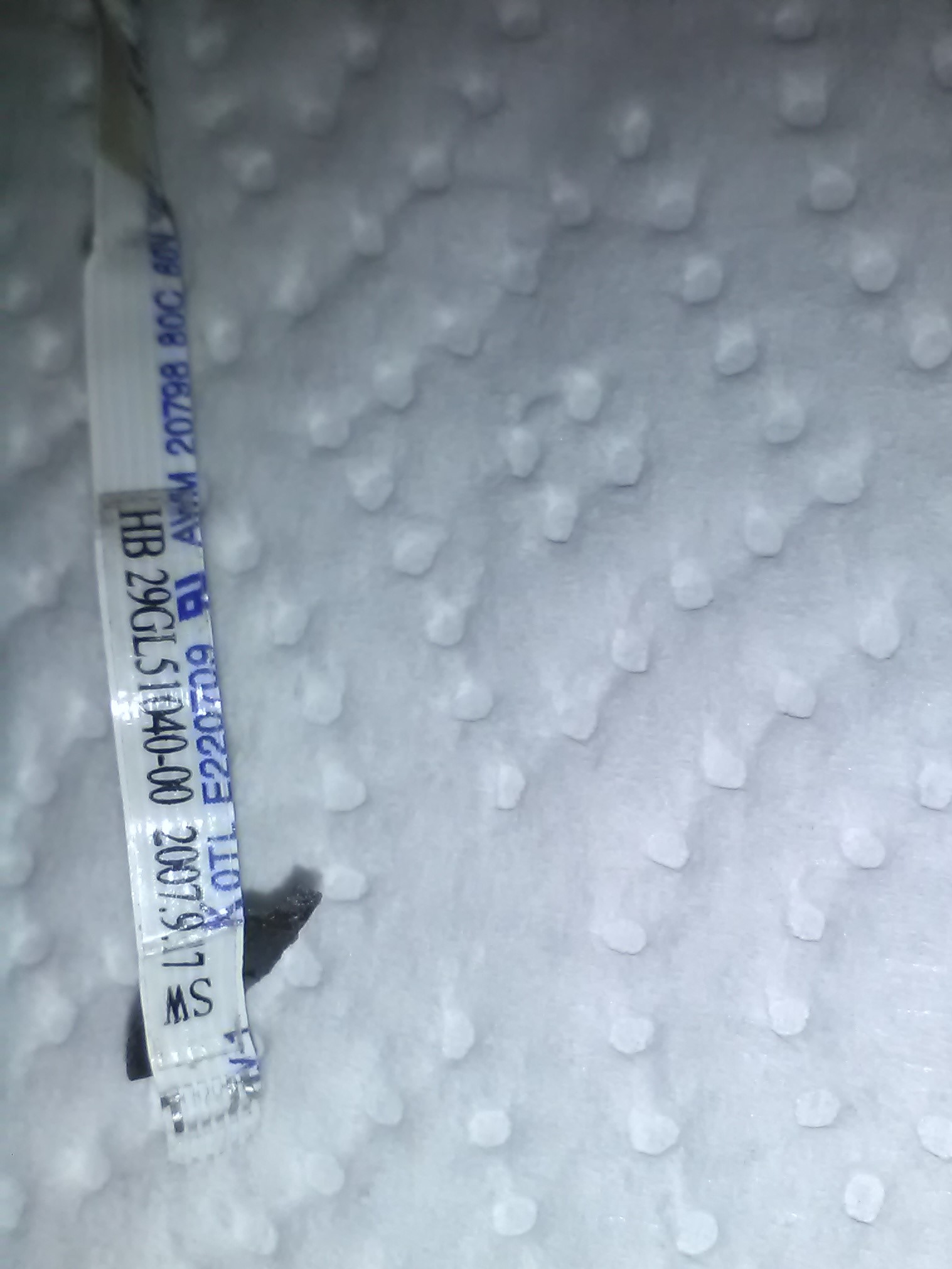

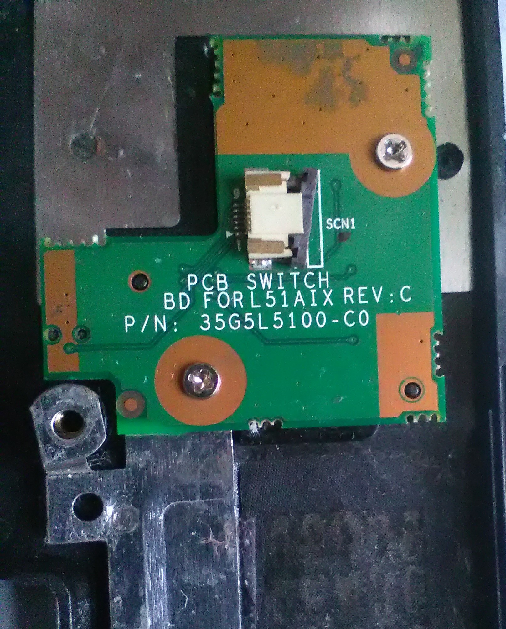

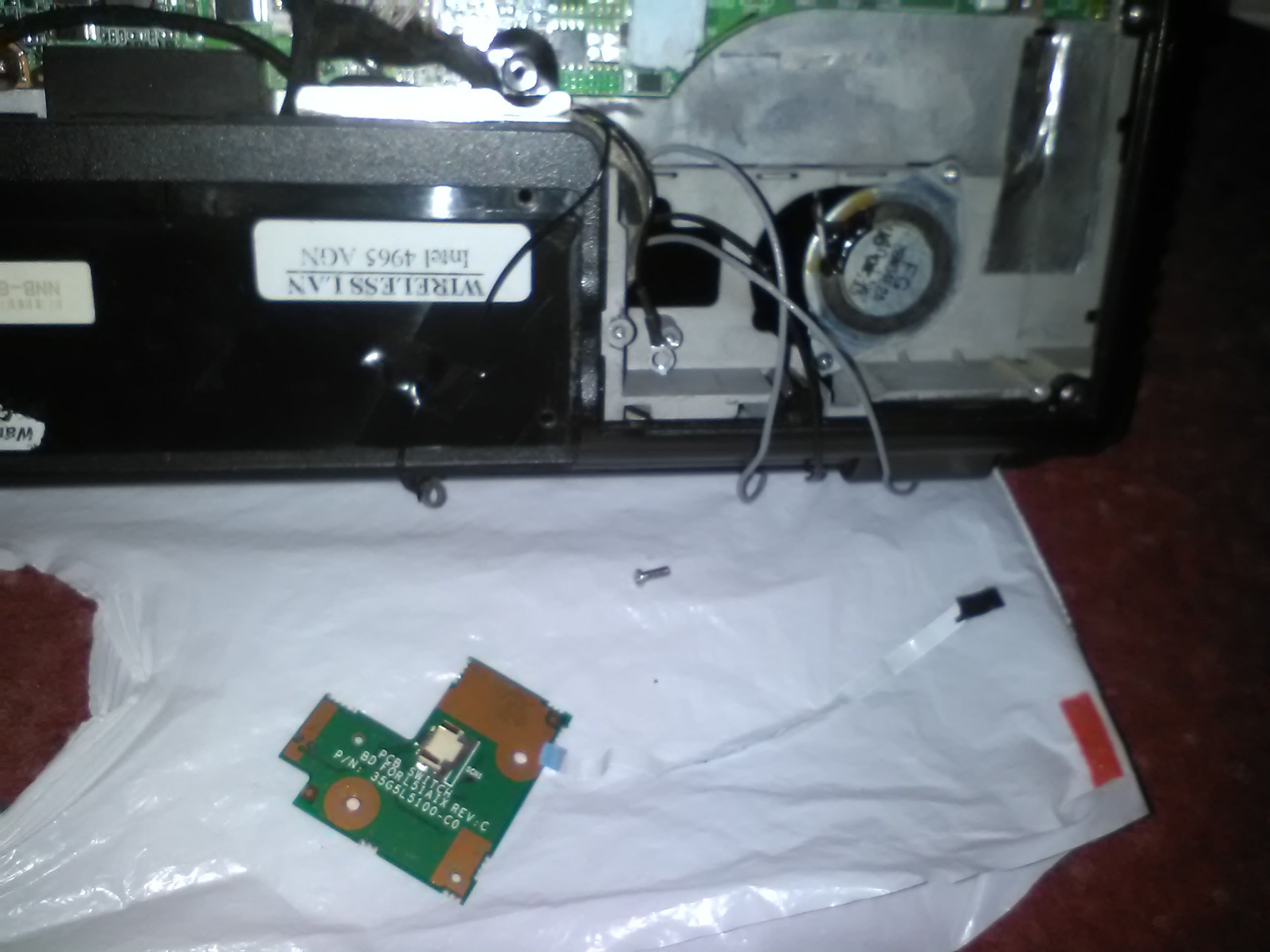

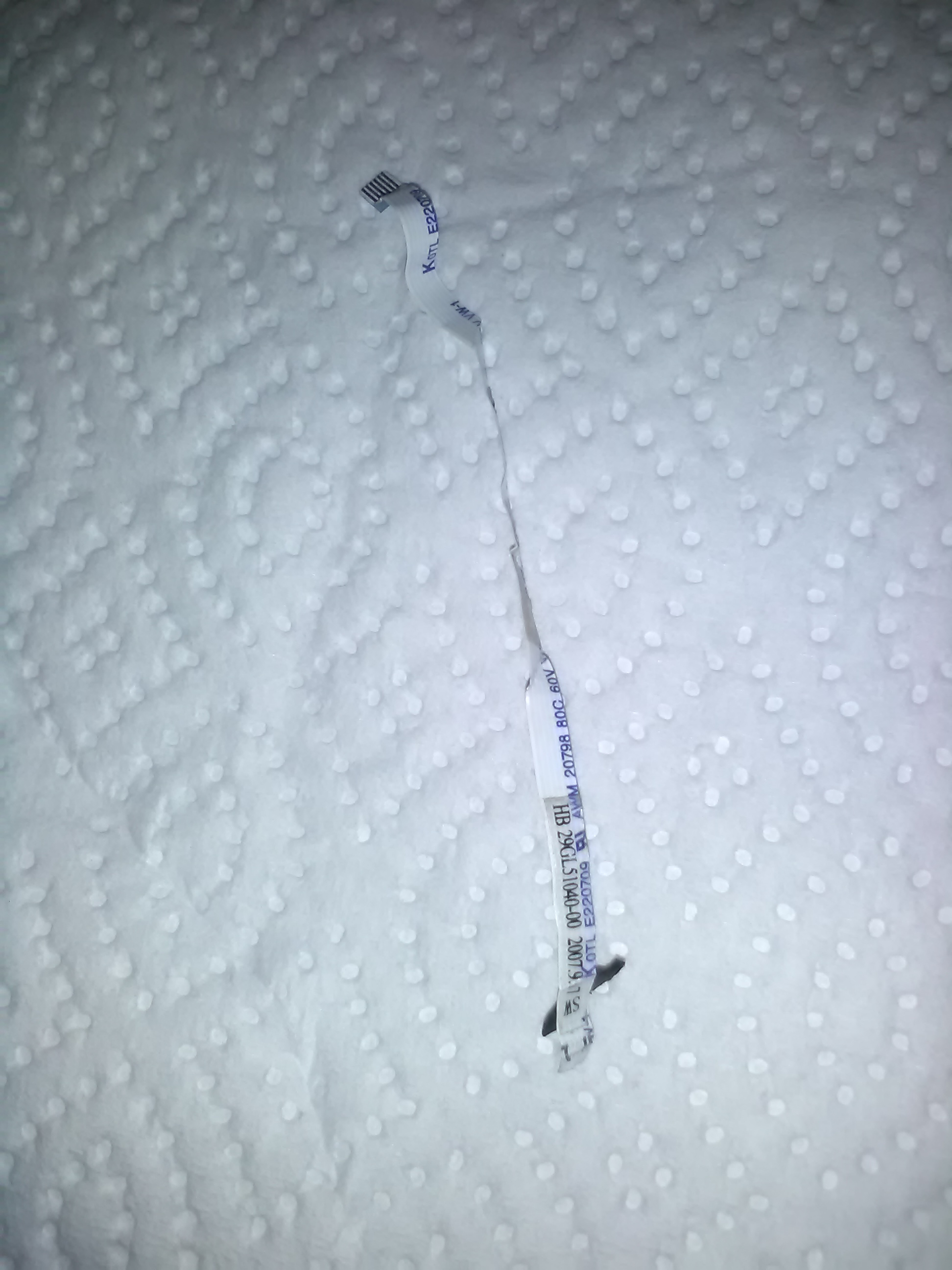

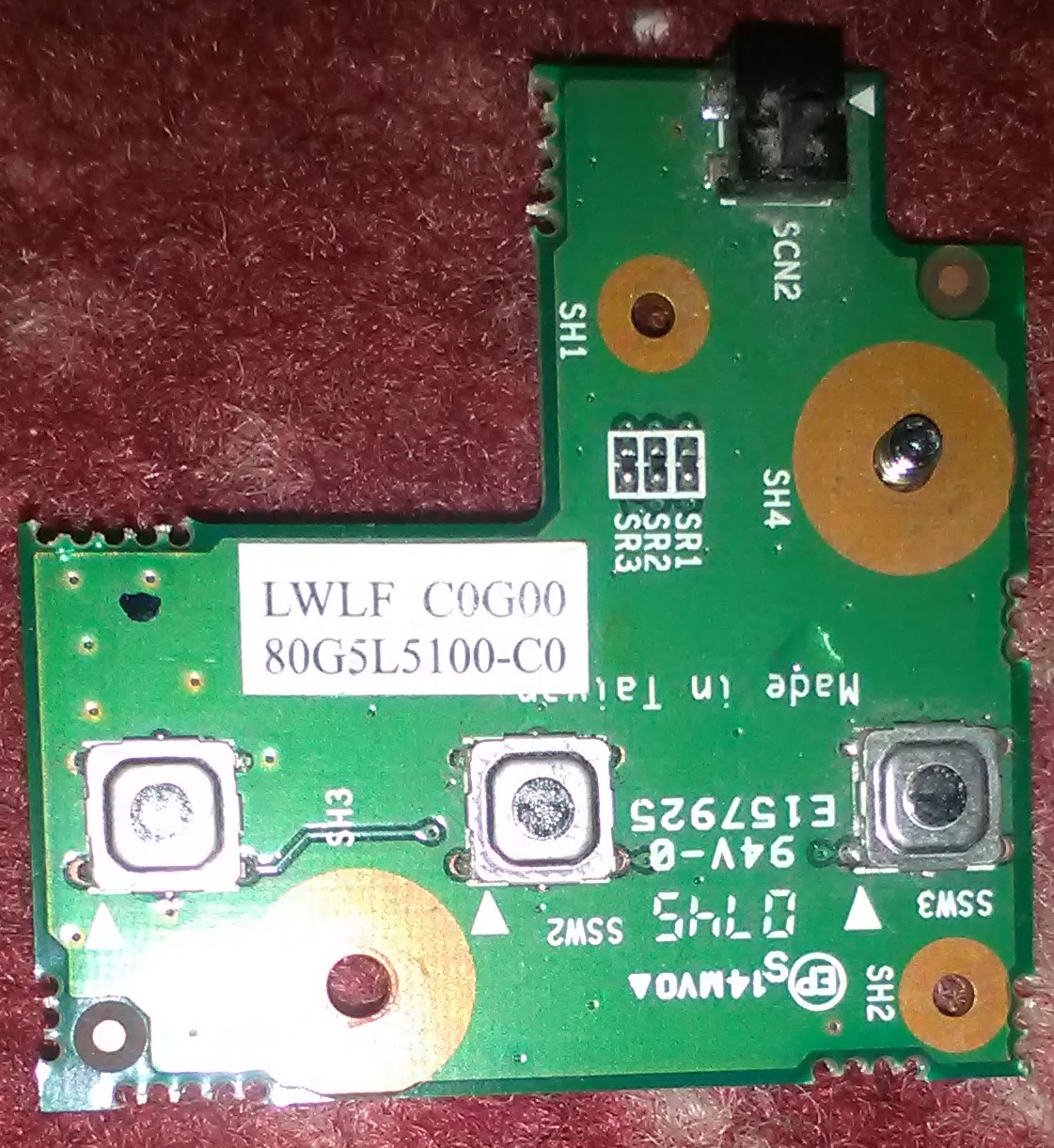

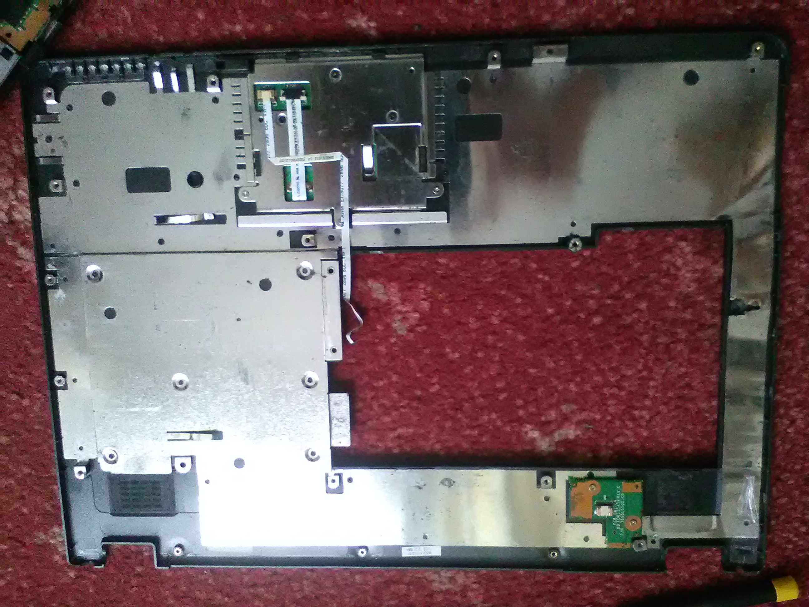

                      Now folks if anyone will reply. I broke the power button ribbon cable to the motherboard.
                      How do I get a replacement cable??
                      It is a little cable with blue plastic bits on either ends.
                      http://www.hse.gov.uk/pubns/indg305.pdf
                      • diif
                        • Feb 2014
                        • 6978
                        • England
                        What's the pitch, length and how many contacts ?

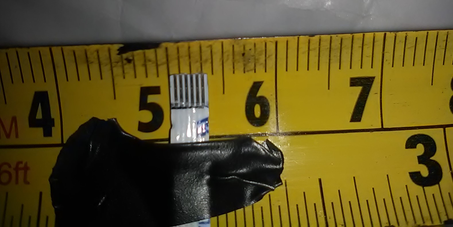

                          I also tugged on the other bit this.
                          How do I measure the cable and give you the correct information?

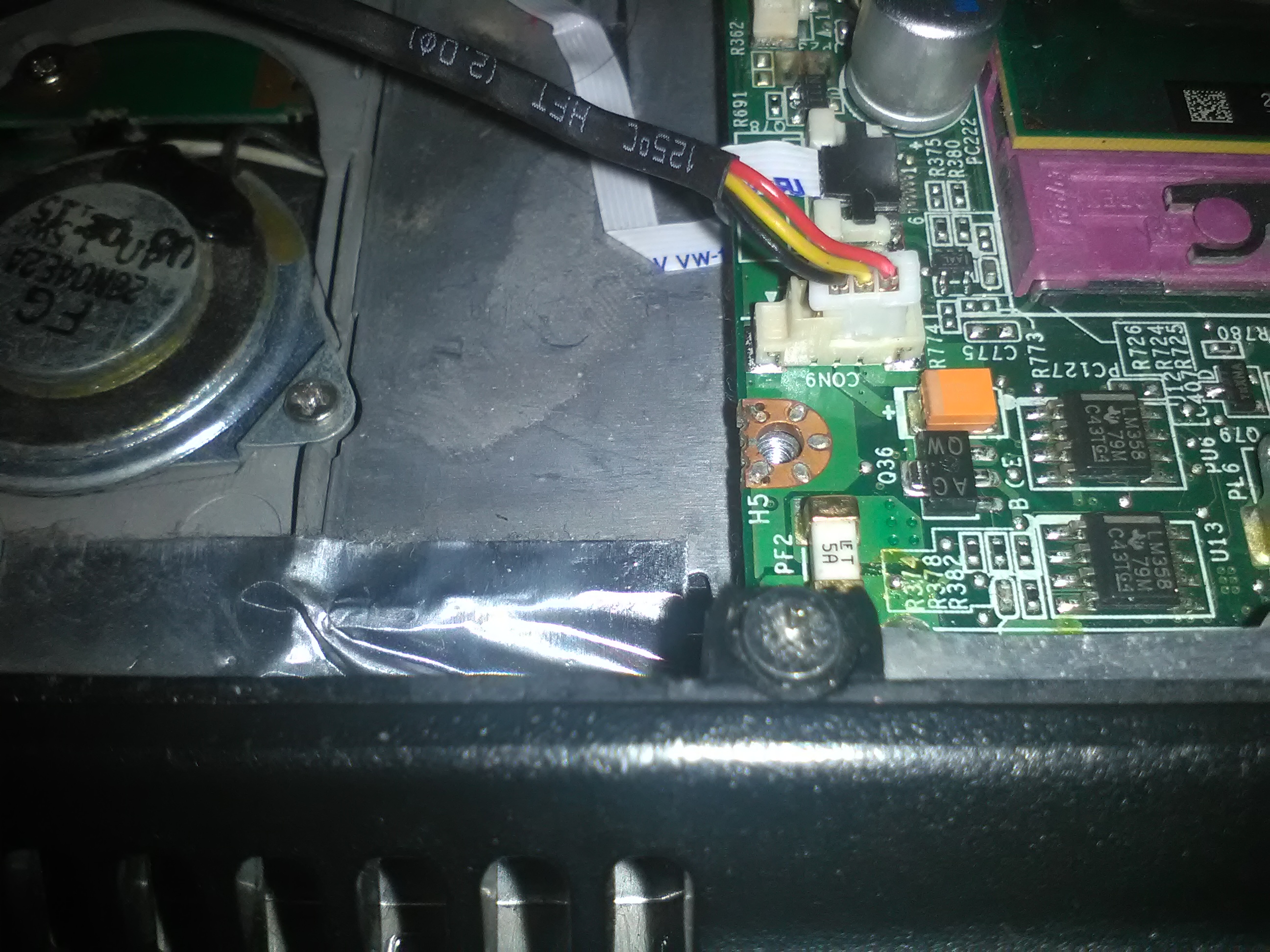

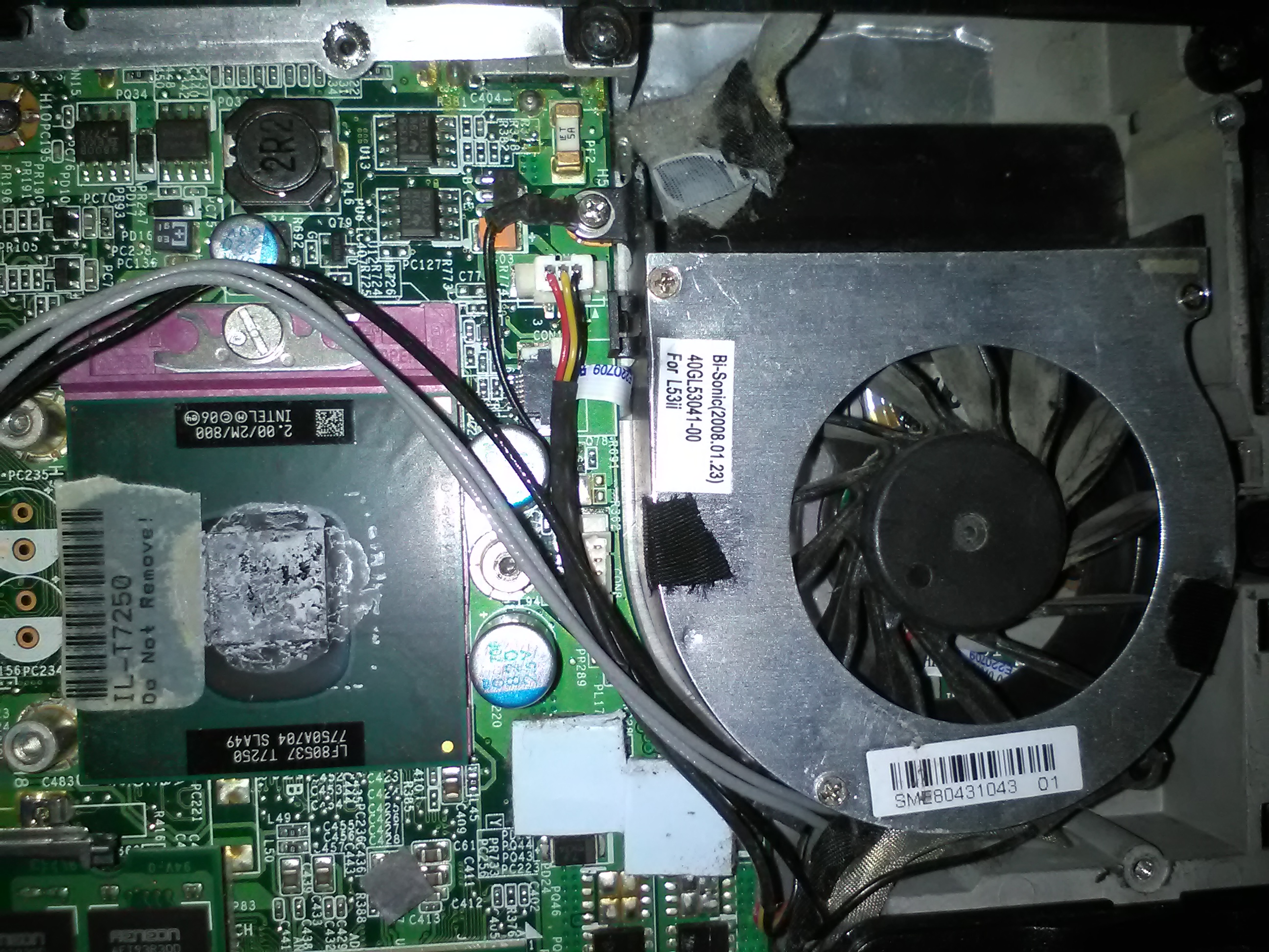

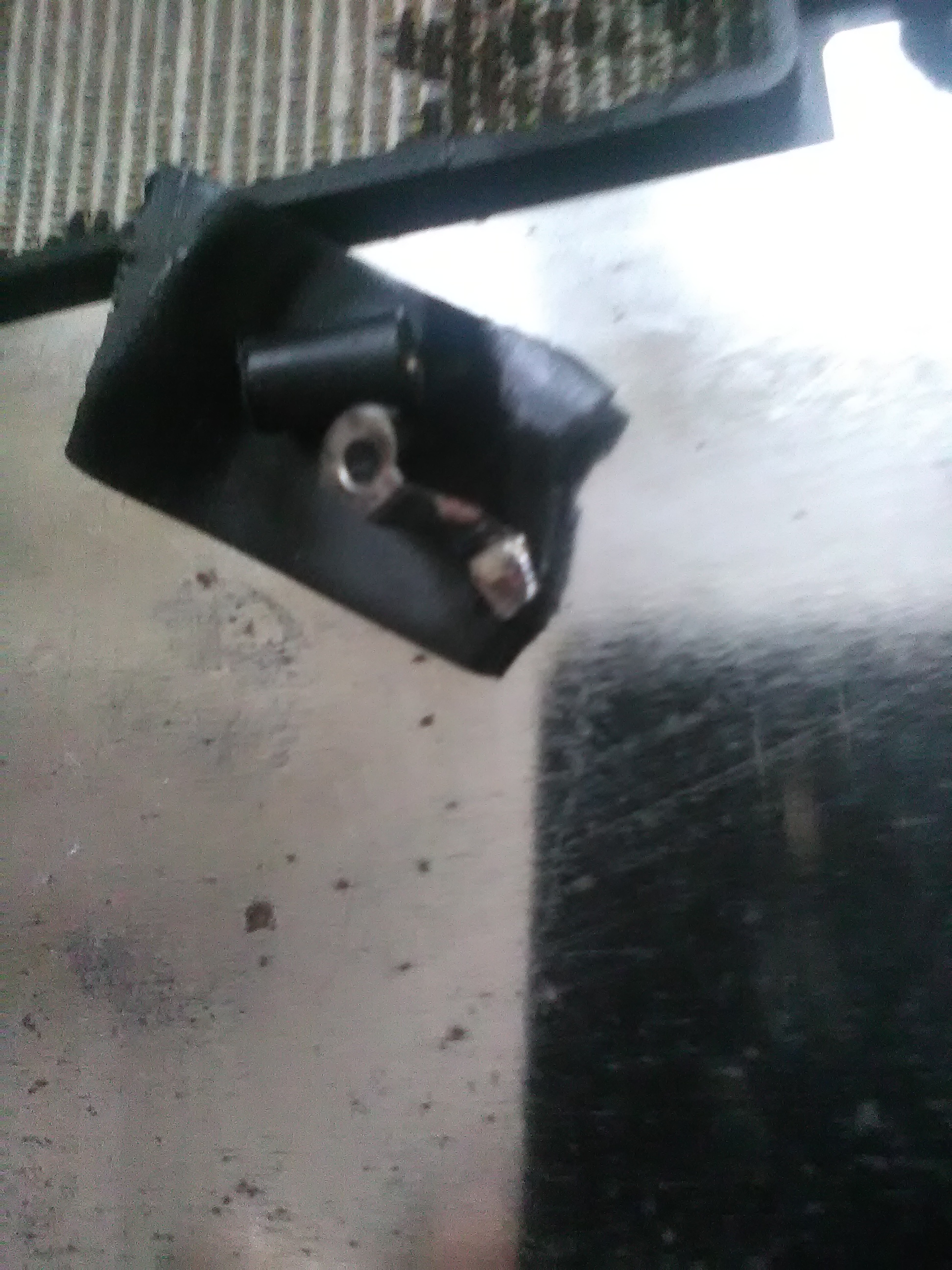

                            The cpu fan plastic bit broke off side, how do I secure it.
                            • diif
                              • Feb 2014
                              • 6978
                              • England
                              On the three wire fan connector ? a dab of hot glue.

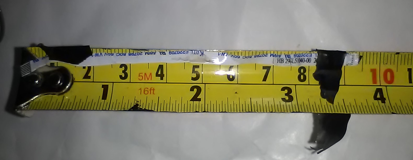

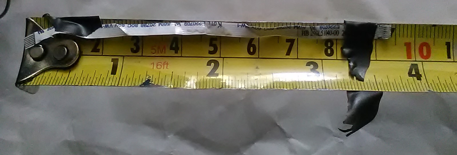

                              A clearer picture of the FFC would help. You have a ruler ? measure the length and width and the amount of contacts.
                                I took pictures of it close up, with markings on it.
                                The ribbon cable.
                                • diif
                                  • Feb 2014
                                  • 6978
                                  • England
                                  And the length and width ? Looks like 6 contacts.
                                  • Fast Alpha
                                    • Feb 2013
                                    • 245
                                    • United Kingdom
                                    I took some photos, sorry it took so long but I got the length and width in photos.
                                    • diif
                                      • Feb 2014
                                      • 6978
                                      • England
                                      0.5mm pitch 6pins forward direction. 10cm should do.
