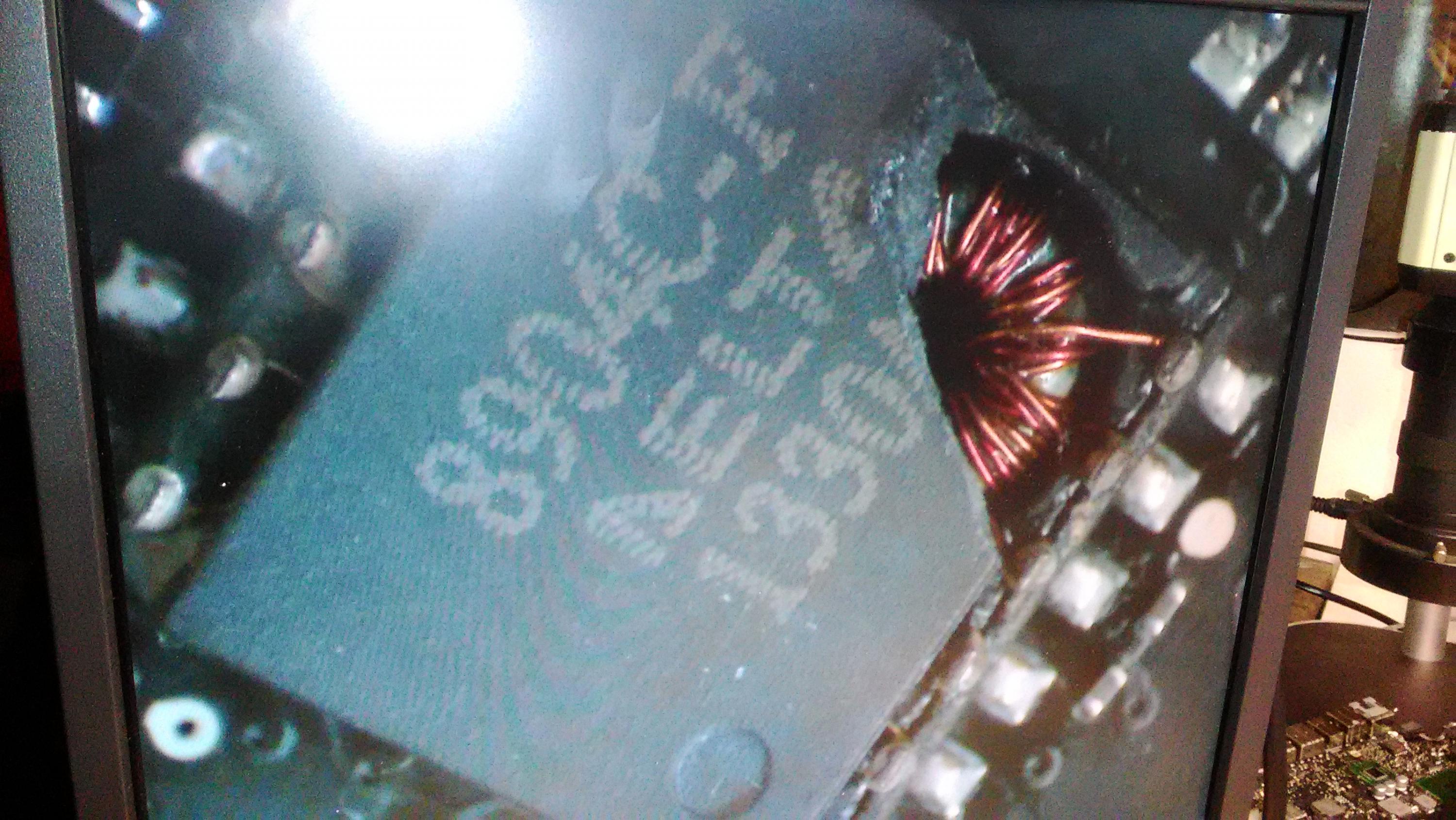

    hello to all
    i need a advice for faulty a1278 .. problem no screen also with external monitor .
    this is a image for a possible faulty , inductor broken.. can this be the cause?
    thanks in advance

    Re: a1278 visible damage
    The part is a Delta 8904C-F power controller. I believe it regulates power to displays, but I'm not too sure about that. It apparently needs replacing. Here is a link to buy the product.
      thank you bro
      i ceck for purchase to jotrin but seems qt 3000 minimun order ..
      now i try to search also on aliexpress for minimun lot.
        No problem. Also, fake capacitors are running rampid in that site.
          I depends on which vendor purchases, on aliexpress often buy lots of SMD components for mobile never had problems ..I had problems only with Micro USB connectors poorly constructed and bad.
