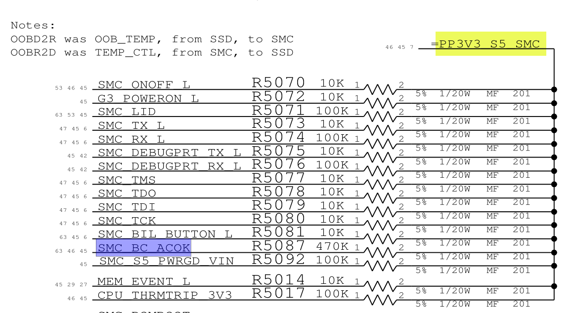

    - SMC_BC_ACOK(CHGR_ACOK) is short to ground, but only when the board is powered (by either adapter or battery)

    Confirm that the soldering is ok for U7000, pin # 14 (CHGR_ACOK).
    Confirm that R5087 is present and its value. This CHGR_ACOK is an open-drain output and respectively requires a local pull-up resistor = R5087 in this case to be present. Then R5087 must have a pull-up voltage (ie. PP3V3_S5_SMC) to be function to allow for the '1' state.

      CHGR_ACOK is open drain on ISL chip. Should be pulled high to PP3V3_S5_SMC by a pullup. This comes from the ISL......PPBUS_G3H is 12.3V, this indicates to me that the SMC isn't communicating to the ISL. Most common cause of that is SMC is stuck in reset or issue around the power rails to the SMC.
          After the above, the MAXIM single wire communication IC will be powered to light up the external adapter light.
          Thanks for the help @mon2 and @reformatt
          Have rechecked pin 14 of U7000, and can confirm no short when board not powered.
          R5087 is a strange one. Unpowered the value of this resistor shows as the correct value (470k Ohm), but when powered shows as short to ground on pin 1 (as this is SMC_BC_ACOK). The voltage when measured across R5087 pins when board is powered is showing as 3.45v and Ohm value shows as OL.

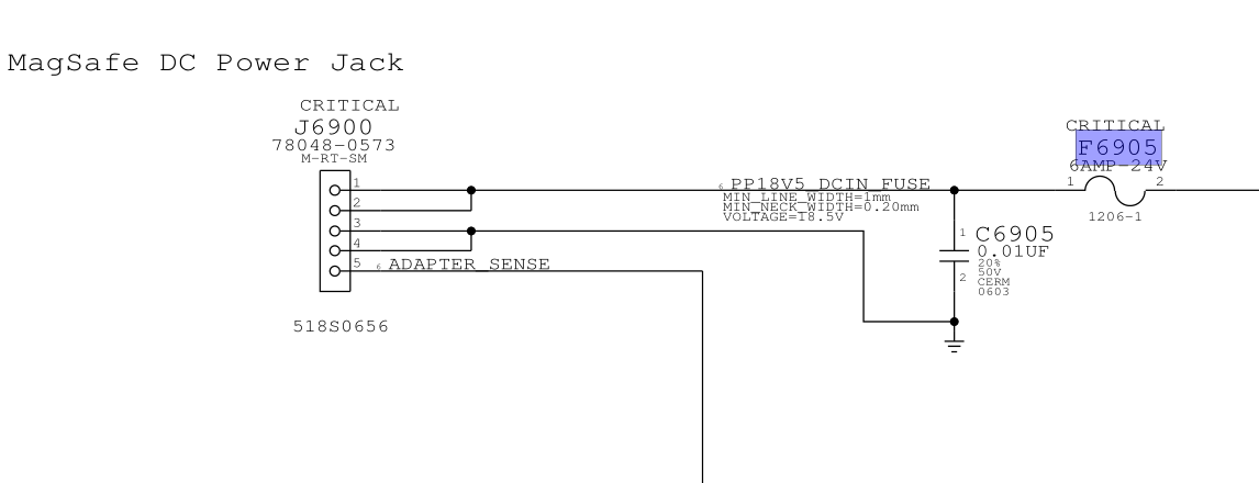

            Also measure the voltages on both sides of fuse @ F6905.
              16.46v measured both sides of this fuse to ground.

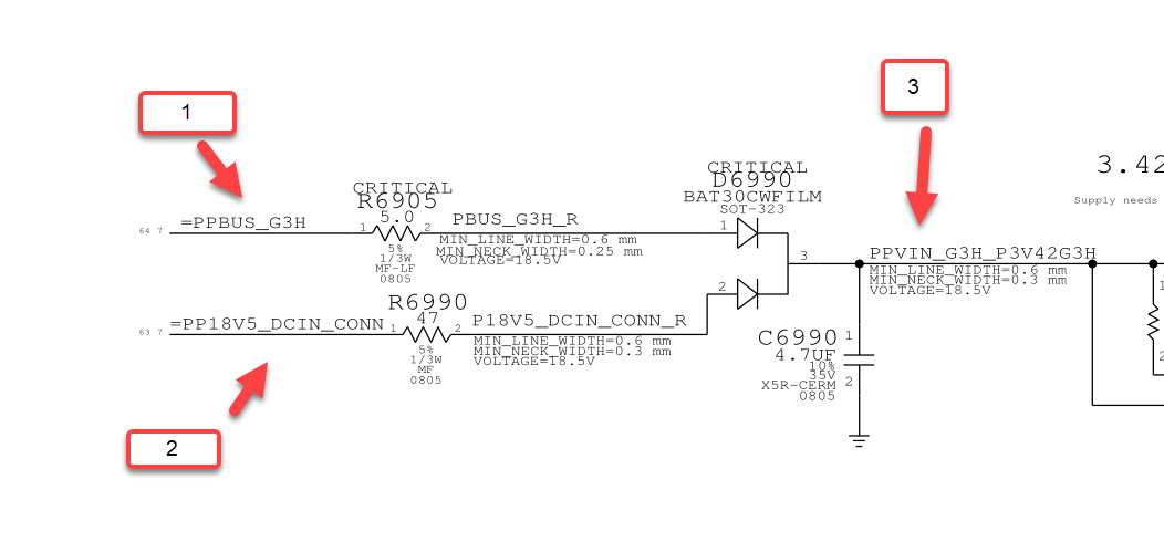

                    1) Confirm that you have PP3V42_G3H_REG with ONLY the external power adapter (your BY cable should be fine).
                    2) See post #2 of this thread and review the voltage @ CHGR_ACIN.
                    Based on the non-existent PPBUS_G3H with the adapter only case, U7000 is not operating properly - for some reason.
                    Also, be sure that U7000 is being powered via
                    PP5V1_CHGR_VDDP
                    PP5V1_CHGR_VDD
                    PPCHGR_DCIN
                    3) The power on order chart on sheet # 3 of the schematics will be logical to follow.
                      Agreed. It is doing my head in lol. I have already replaced it 3 times with new chips, so highly unlikely to be a bad chip, but could be possible I guess.
                      PP3V42_G3H_REG = PP3V42_G3H = 3.45v as measured @ pin 1 of C6999
                      CHGR_ACIN (@pin 3 of U7000)= 3.86v - About the same on working board.
                      PPCHGR_DCIN (Pin 2 of U7000) = 2.36v - This measures 15,9v on the working board, so this could be the main issue. Will investigate this further in bit.
                        This is major. Review this area carefully. Start with removing all power. Meter in resistance mode.
                        Check the resistance from the measured pin to a point where you know the power rail is ok. Again no power. This could be trace break or similar.
                        Compare each measurement to the known good board.
