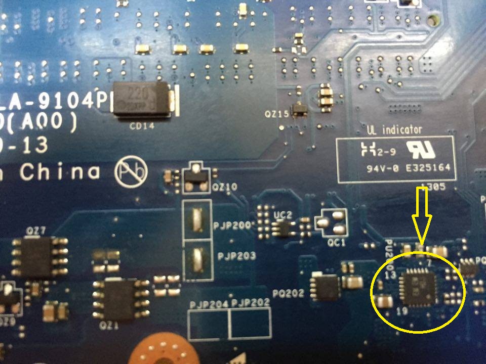

    I'VE DELL 3521 NO POWER
    THE PROBLEM WITH IC NO. EM EM
    I NEED ALTERNATIVE IC No. FOR EM EM IC
    IS IT CAN BE TPS51123 OR WHICH ONE ?

    IC is RT8205LGQW, just replace it with the same one.

        you can replace tps51125
