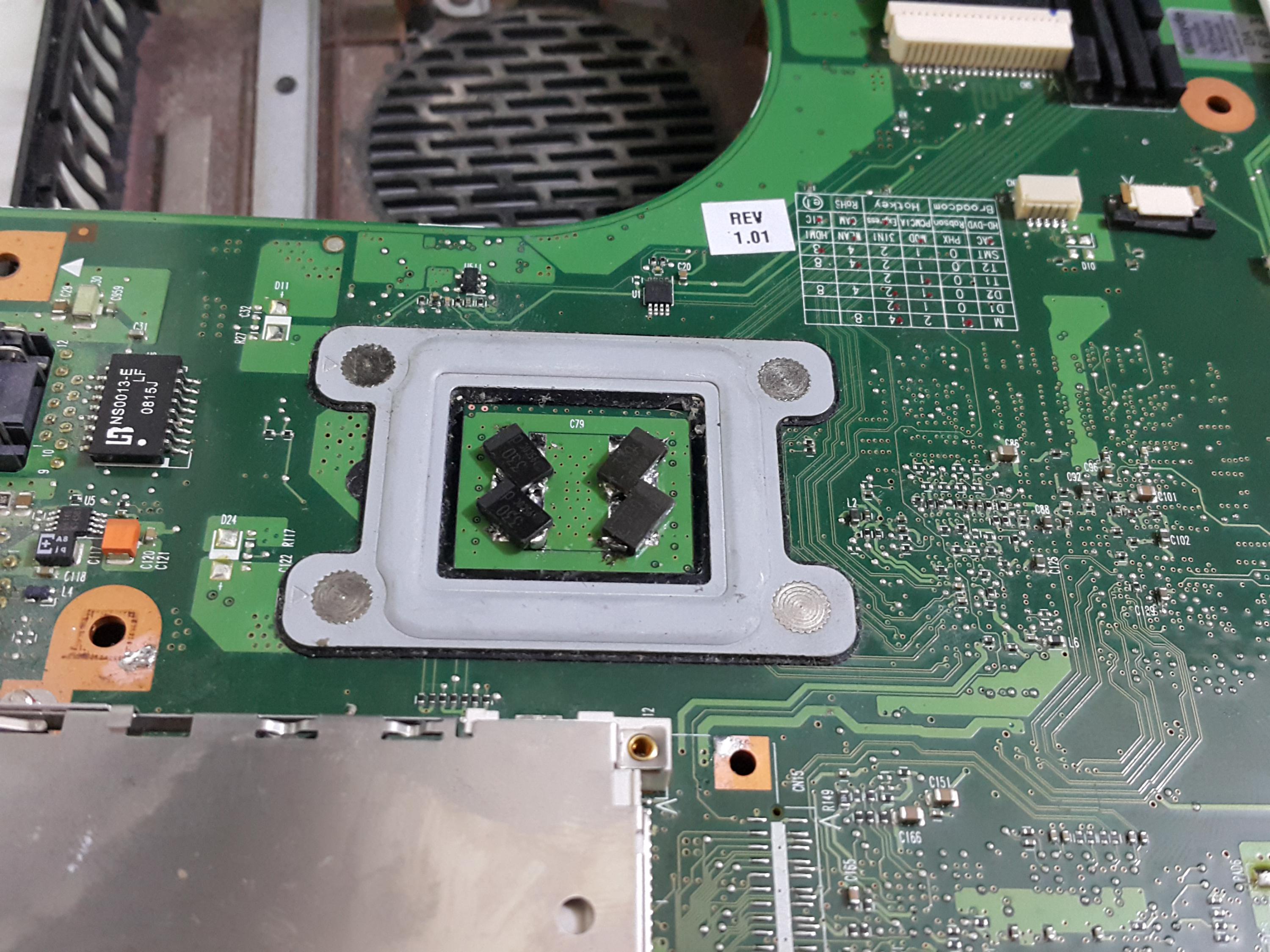

    Hi i have this satellite l300 power up 3 sec after restart again and stay on but no image on screen , i have a doubt that :
    Nec tokin problem , replaced with 4 x330u tantalium ,no change

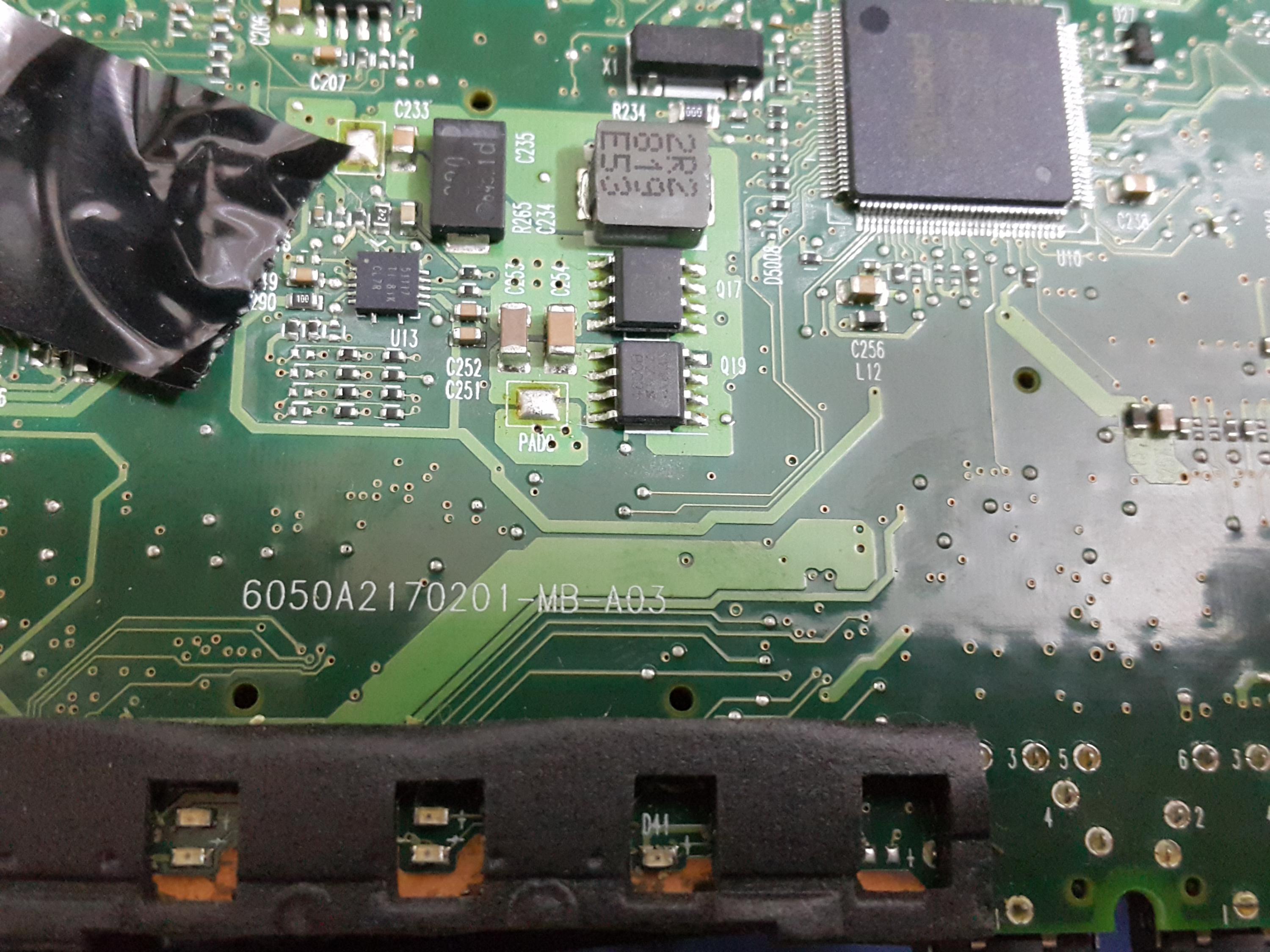

    i checked coils have 3,3v have 5v , and coil of Cpu 0,95V

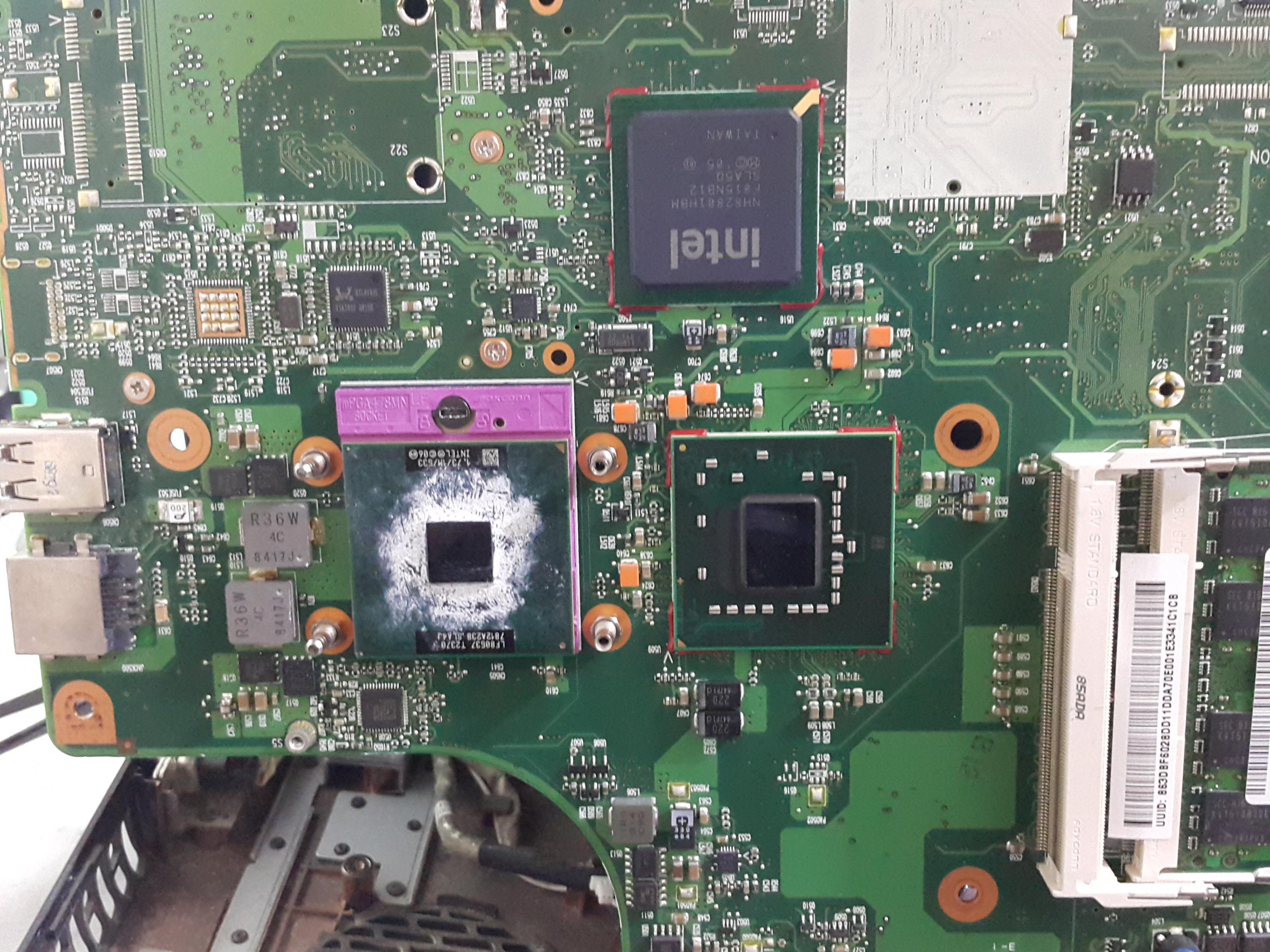

    CPU stay cool replaced cpu with the same model , no change
    replaced with other model now have 1,2v on coil and the cpu make too hot ,
    flashed bios , reflowed chipset , NO CHANGE , TURN ON 3 SEC AFTER RESTART AND STAY POWER ON ......................BUT NO SCREEN............................
    any suggestion please

      Put 2 more caps, this kind is low in farad, and if i use this kind, i put 6pcs.
      I'm using the yellow type, is better than the one you got there.

        reflow nb

          reflowed but no change , i try too with 6x330 tantalium but the same .....

            i have a motherboard L300 with the same symptoms , it powers on, does a restart and then sometimes it stays on or restarts again but with no post, i already replaced TOKIN with 6 x 330 tantalum, any ideas?

              Re: L300 NEC TOKIN ??????? help please
              no ... im not sure i must chek one spare board here , but your nec specially the bottom one from the right side , is solder is between ground and positive (attention im not saying it is , but it looks like . and also if cpu is getting to hot , you gave to much heat on this area for a long perior of time .
              my advise
              remove all capacitors again
              cleam board
              and add only a pinch of solder on each contact of the capacitor ,
