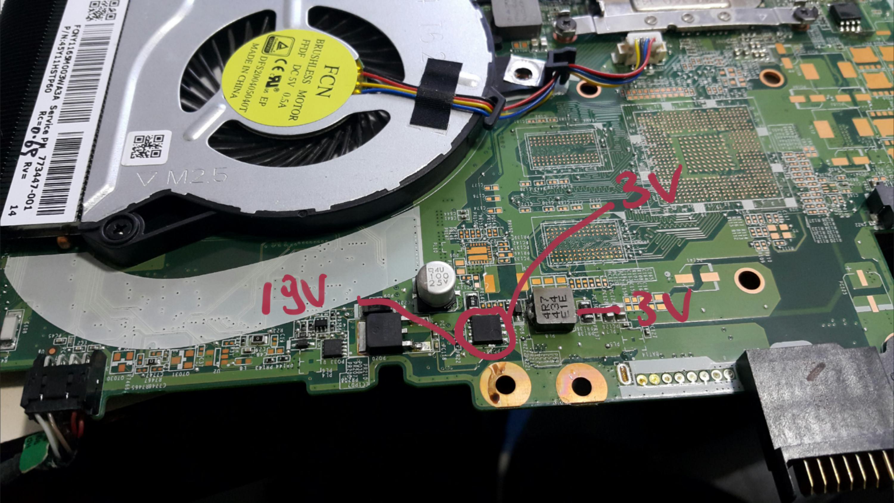

    Hi i m working with this HP
    HP (DAY11AMB6E0) that not charge . no jack led .
    have 19v have 3.3v on coil and 5v on coil , flashed bios first but no change .
    I see a strange thing in this mosfet TPCA8065-H pin 5678 19v pin 123 3v
    voltage goes up to 3v gradually for 30 seconds, then he stops at 3v. changed coil 4r7 but the same thing , without coil pin123 of tpca8065h have 5v constant.
    Any help please or schematic
