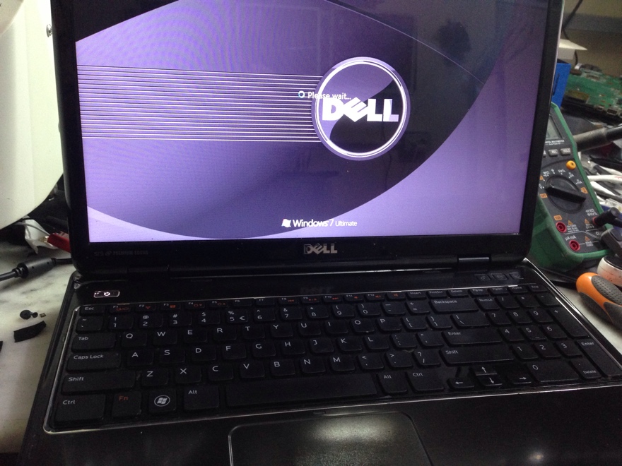

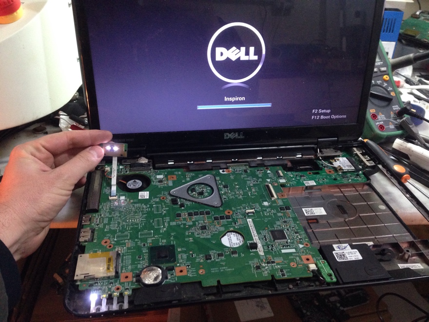

    Hi i m working with this dell inspiron n5110 10245-2 board .
    first i checked PU4103 (tps51123) it gets too hot replaced with tps51125 but not charge again PU4103 pin voltage:
    pin 1 >1.35v
    pin 2 >2v
    pin 3 >2v
    pin 4 >2v
    pin 5 >2v
    pin 6 >1.7v
    pin 7 >3.3v
    pin 8 >1.9v VREG3
    pin 9 >8.7v
    pin10 >3.3v
    pin 11 >3,3
    pin12 >0
    pin 13 >3,2v
    pin 14 >1.9v
    pin 15 > 0
    pin 16 >19v ACIN
    pin 17 > 5v VREG5
    pin 18 >2,5v
    pin 19 >0v
    pin 20 >5v
    pin 21 >5v
    pin22 >10v
    pin23 >3,3v
    pin24 >5v

    Re: N5110 not CHARGE not POWER
    after i checked PL4001 have 2,7v
    PU4001
    1 19v
    2 2.6
    3 2.6
    4 5.8
    5 6
    6 0
    7 0
    8 2.5
    9 2.5
    10 0
    11 1.1
    12 2.7
    13 2.7
    14 0
    15 3.5
    16 0
    17 0
    18 0
    19 21v
    20 21v
    I hear a whistle ,but i do not know where it comes from ?
    don t charge again what do you think maybe is PU4001 the problem or ????
            THANKS MERITOSARI YOU HAVE RIGHT
            two days seeking a tps 51123, it just found in the borders for scrap , replaced and work fine .
            Thanks again.
