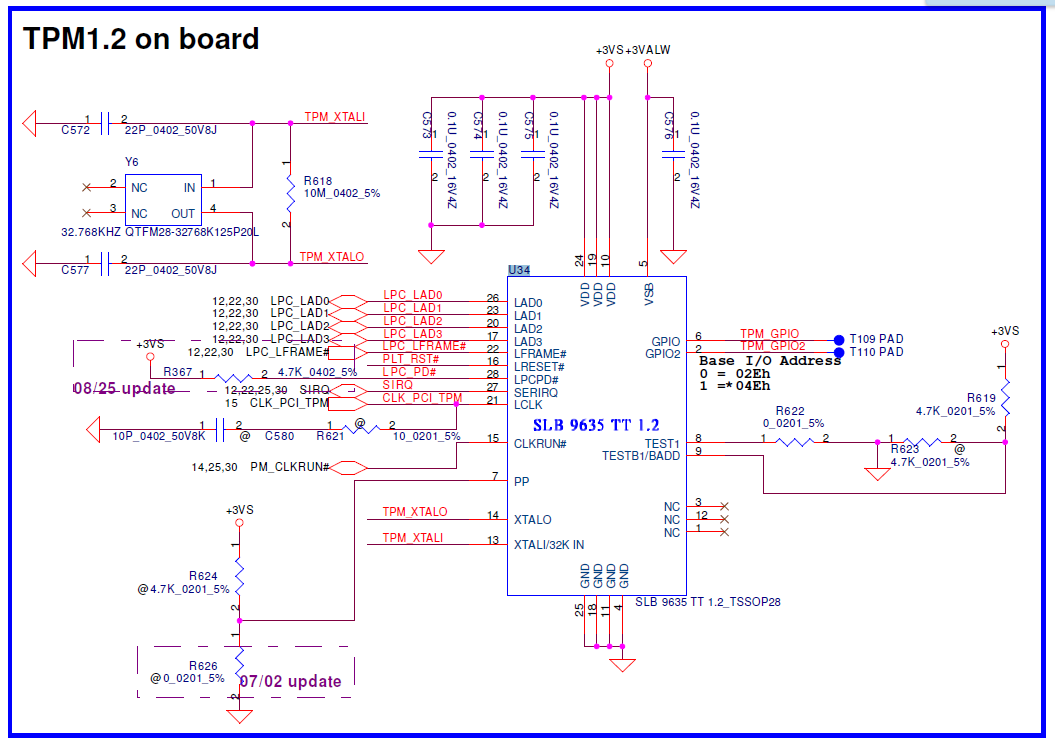

    is there any way to reprogram this chip
    or reset it to remove stored password keys
    there no even data sheet for it but I found it in a
    laptop board schematics
    HP elitebook 2540p

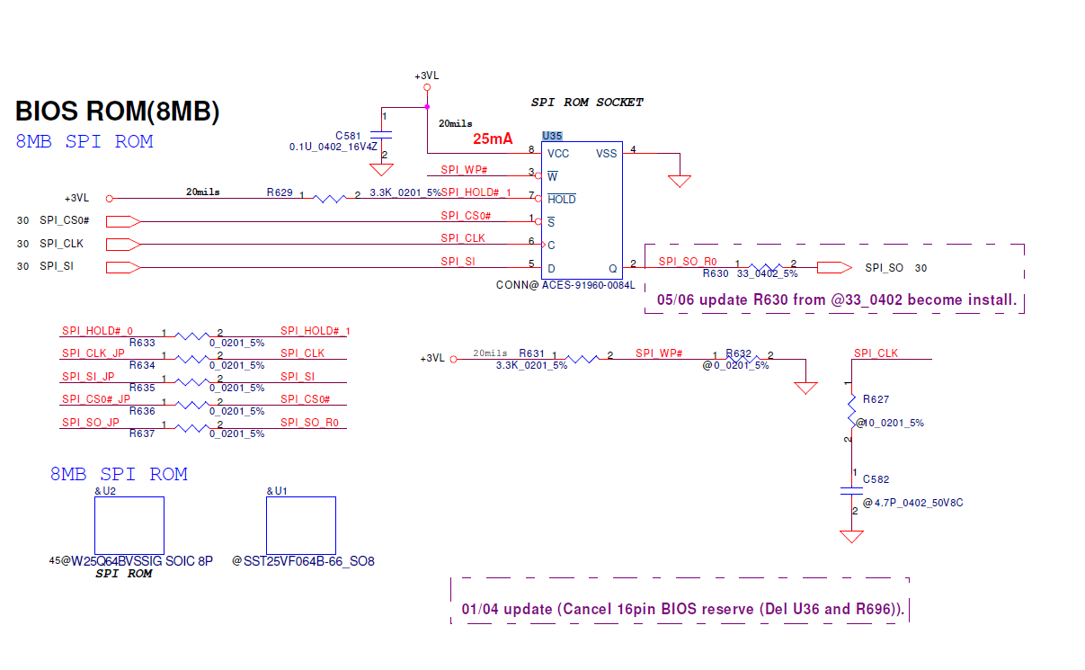

    it's number u34 and the SPI bios chip u35
    i'm afraid to do anything without an advice I could blown the chip with no chance to get this pc back to life

    Re: Infineon TPM 1.2 Chip slb 9635 tt1.2 please help
    To clear the TPM you need to enter the BIOS. The TPM only holds the bitlocker key.
    You will lose access to the files though if they have been encrypted by bitlocker.

        • 31013
        passwords are usually stored in the flash,
        if you want to get rid of ithe tpm try shorting the crystal, some laptops wil run without it because they sell export models to some country's without the chip.

          i've tried reflashing ,,, all bins availabe 3.0mb the backed up was 8.0mb
          i've tried ver f.09 f50 but no boot after programing
          seem it's business laptop with custome german bios
            • 31013
            on your own attached schem are 2 pins on the chip that connect to the crystal (13 & 14) - link the pins together and the chip wont run.
              thanks STj
              I understand now that TPM chip has nothing to do with locked bios I removed it totally like you said laptop worked but still asking for passwords
              it's a BIOS chip matter I'll try to find the right clean software then reprogram it
              I got this wrong I thought this chip stores password
              thanks for your help your time
