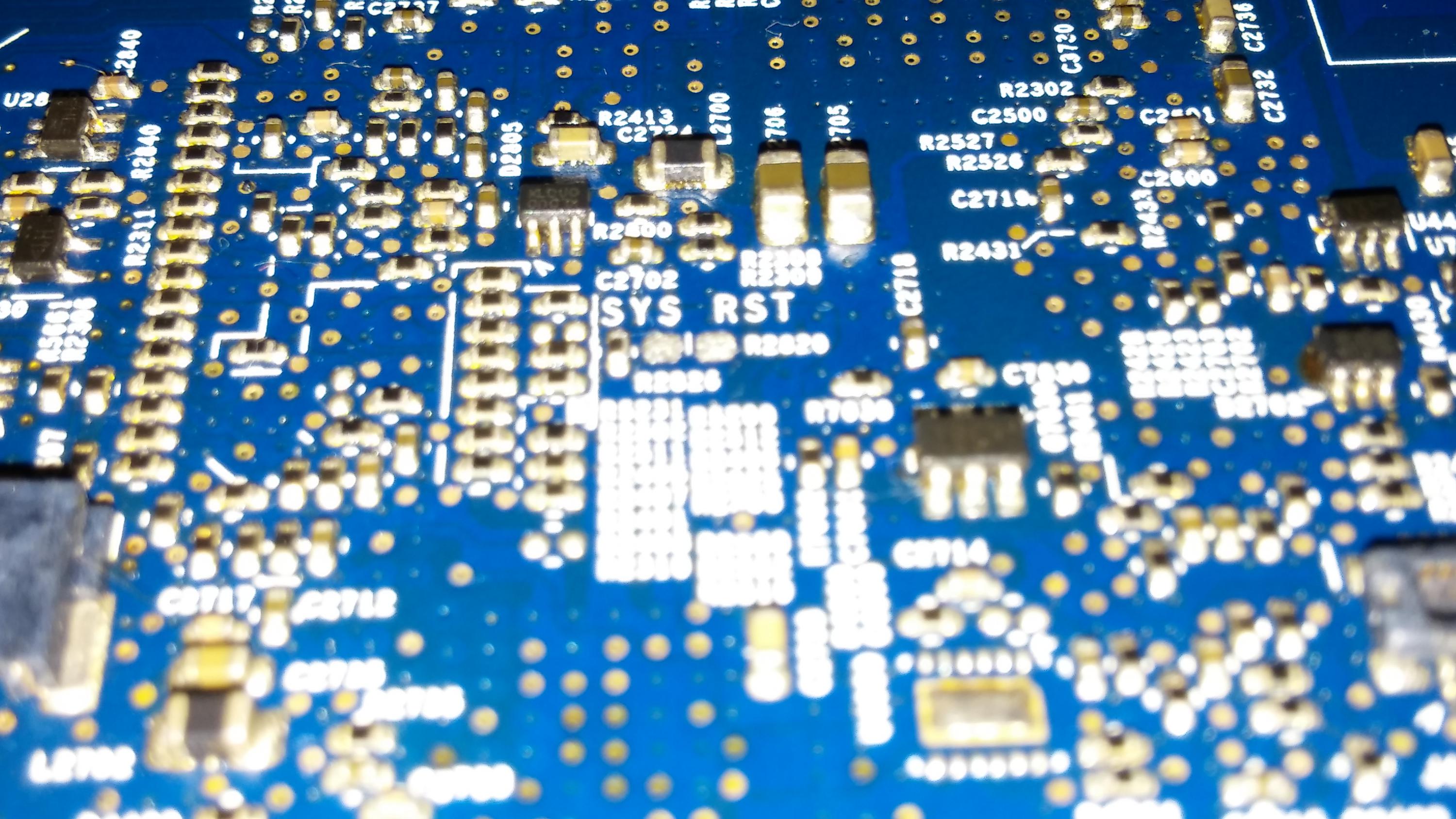

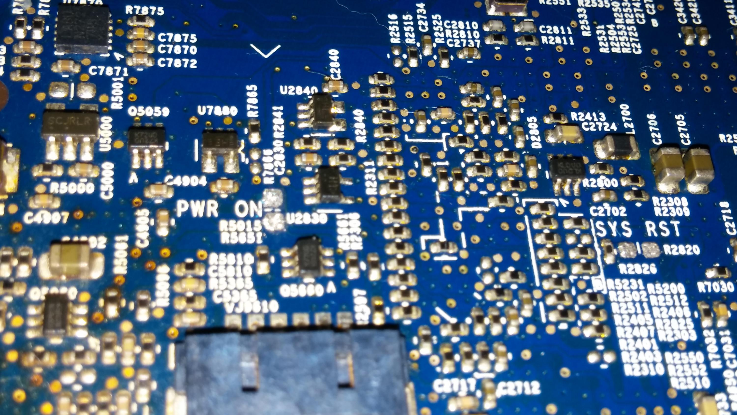

            • lcdcaps1
              • Oct 2011
              • 322
              Re: Logic board repair help needed please please
              there are two pads and has PWR ON
              also another two that have SYS RST

                • lcdcaps1
                  • Oct 2011
                  • 322
                  Attached are pics of PWR ON AND SYS RST PADS

                  • dellxps15
                    • Feb 2014
                    • 1598
                    • italy
                    short 2 power on pads and see if macbook power on like normal. if it power on, but no display, check if cpu and chipset and gpu get hot.
