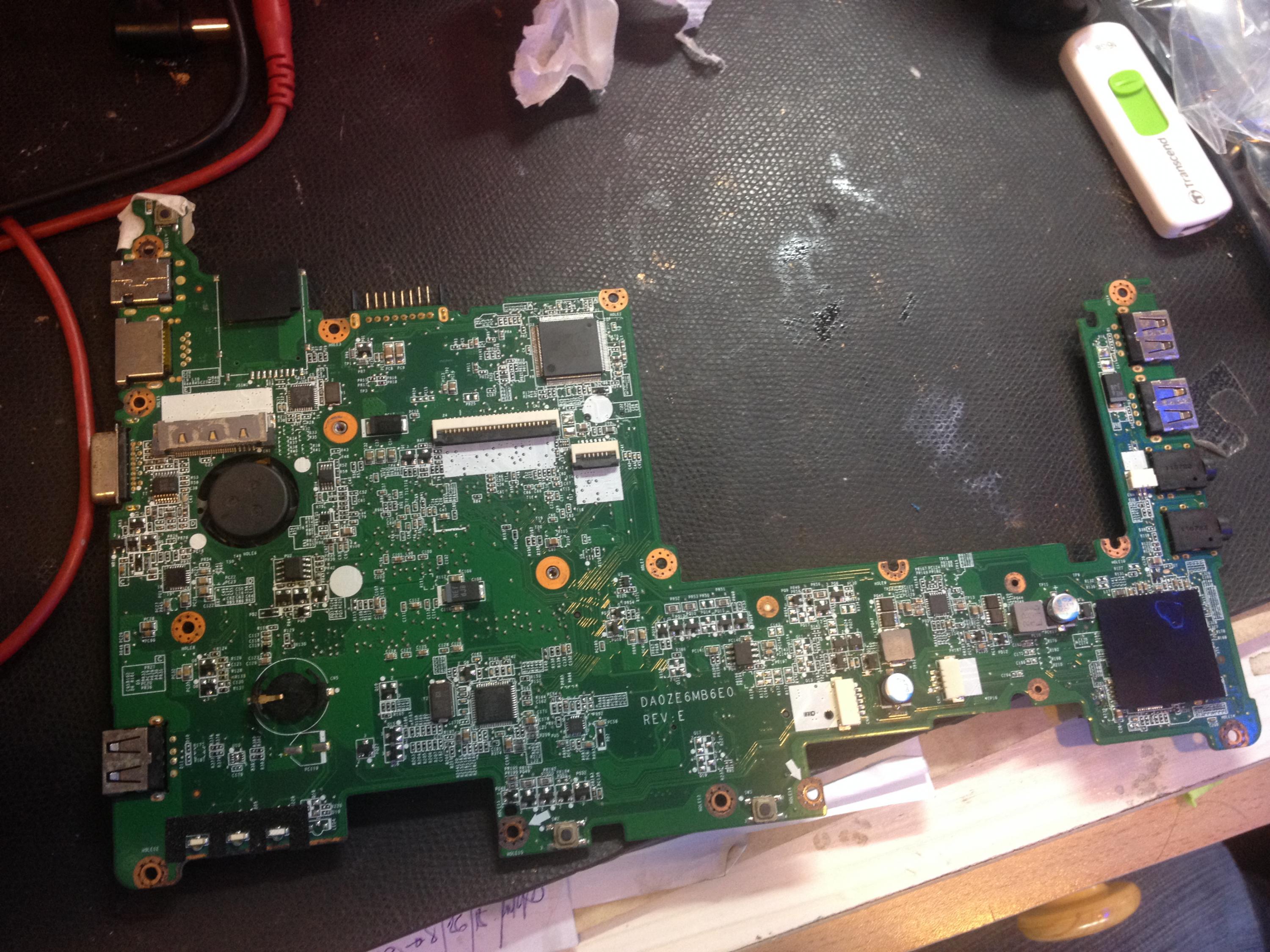

    hello guys. need some help. i got this problem with unknown issue
    it goes on and after a new sec or more it goes off. its appears logo on screen.
    it has 3.3v and 5v alws.

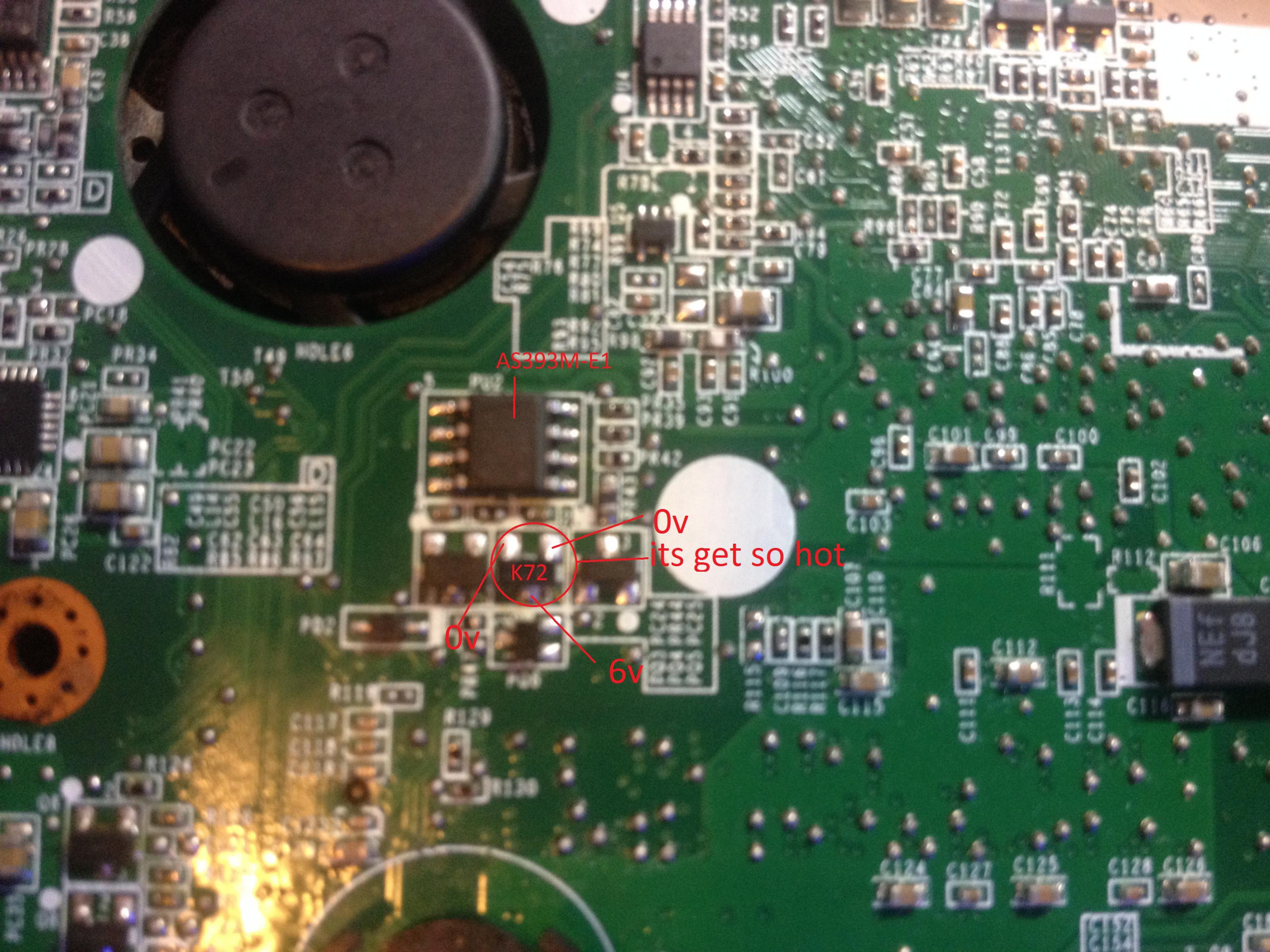

        hi guy i found something that gets hot on the mother board.
        its transistor K72 under nit of CPU. i replace it but it does the same issue it get hot also.
        K72 test
        pin1 0v
        pin2 0v
        pin3 6.1v

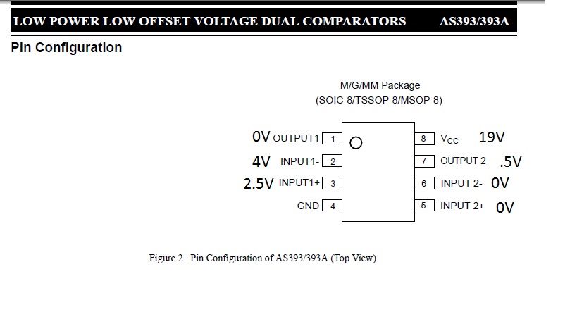

        and i also test AS393 near this transistor
        here is my test
        pin
        1.0v
        2.4v
        3. 2.3
        4. gnd
        5.0v
        6. 0v
        7. .5v
        8. 19v

          -check PQ3, PQ5, PQ6.
          -pin#2 PU2 (AS393) should be low (0v) after pressing power button due s5_on signal pull voltage VL to ground
          -usually i've found ao3409 (PQ3) was leaked or broken

            tnx but i cant find the same ao3409 on my old boards. any replacement that i can use? tnx again

              AO3409 is P-Channel Enhancement Mode Field Effect Transistor you can replace it with AO4407 or AO4435.

                salamat byulo. pero hirap humanap 3pin lng kasi sya tapos ung code nya hindi mismo ung hinahanap mo. meron ako ao4407 pero 8pin eh.
                  Re: acer d257 ZE6 power goes off after a new sec.
                  here is transistor code A9TV 3PIN anu kaya pwede
