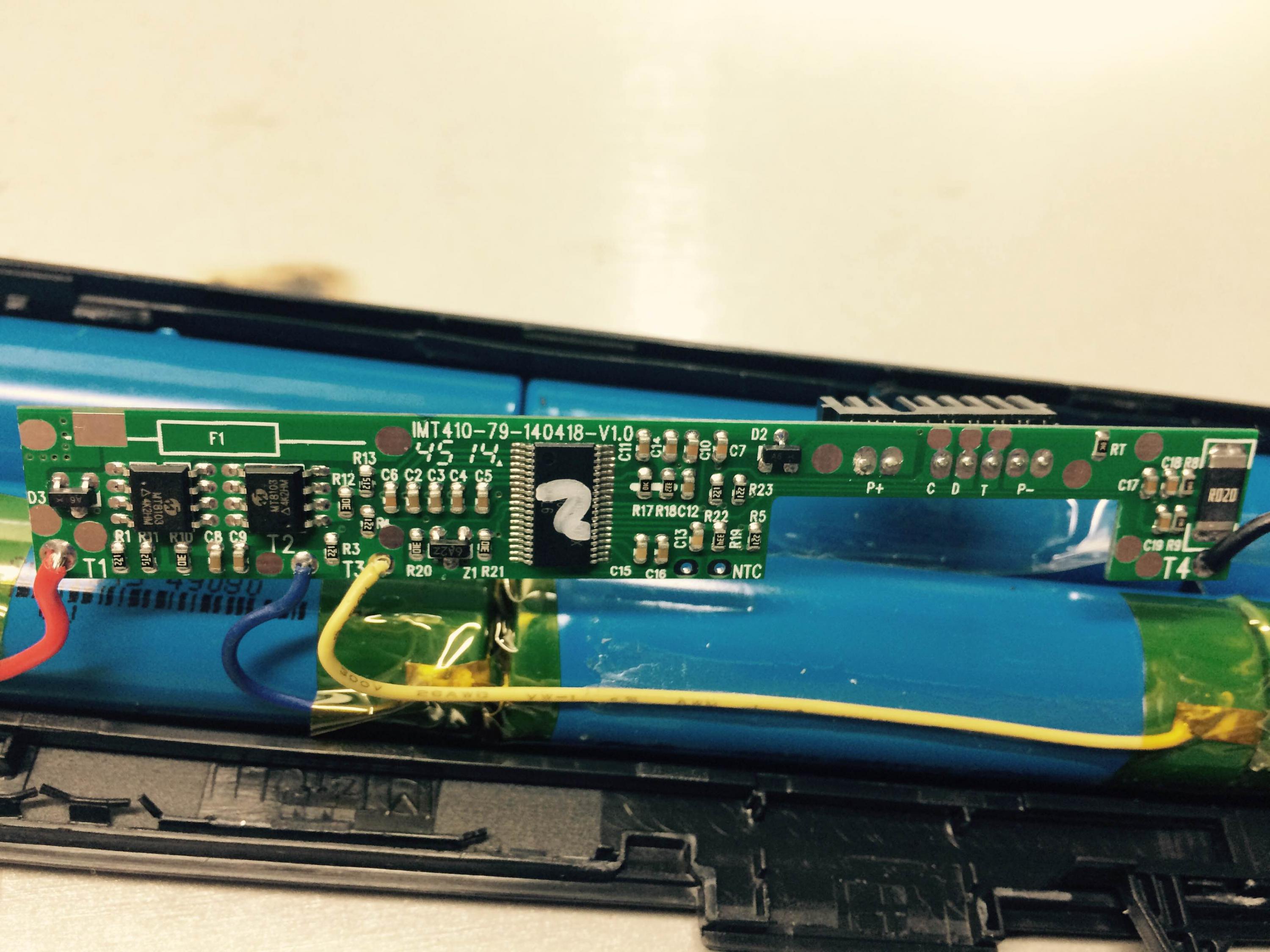

    Hello ! I have this lenovo t520 battery here, it's brand new (lenovo says 2 cycles in the battery utility). Bought it on ebay, got refunded since it didn't work, and seller told me to keep it.
    However, i wondered prior to recycling it, opened it up, and battery has 9.5v from black to red. However, output of the charging pcb is 0.5V.
    So there's just, something wrong on the pcb.. Here's a picture of it, i can't figure out by myself what's wrong. It's rather simple, a few ic's but i cannot find something obvious. Any help would be really great !!!
    Thanks, Vincent

    battery have firmwares, similar to bios, which sometimes goes bad to...

      Ok ! I see 2 MT8103 which seems to be mosfets and some other chip, a SH79F329AX. Which IC would be the culprit ? Can't find anything about these being a bios or eeprom or anything close.. And there's nothing else on the board ?
