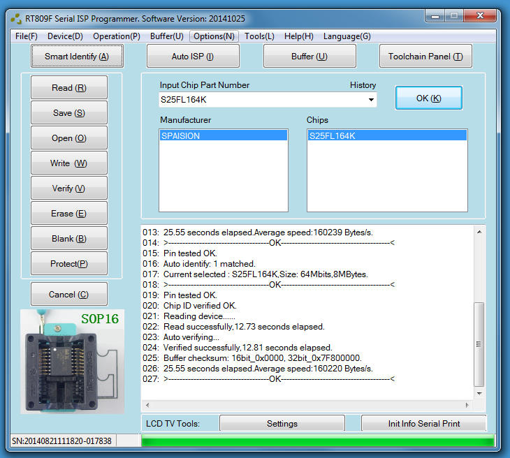

                  I just got a RT809F on eBay which is primarily a programmer for firmware on LCDs and can also be used to do some diagnosis on VGA DDC data.
                  It can read & write firmware either through VGA/HDMI or serial NOR flash (in common SOIC8 or SOIC16 packages) directly through its ZIF socket.

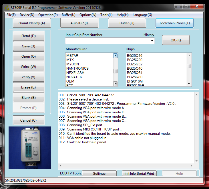

                        Re: how to use RT809F
                        In RT809F i have soldered the chip ENE KB9012 to the separate board given with programmer. But when i click on smart identity, there is a error message,as its not detected.So when i try manual method & select KB9012QF, & try to read the chip,there is ''ISP boot error,please check the ISP wires and EC power'' error msg. So please tell me how to overcome this problem...Thanks..

                                  For anyone still facing the above issue, you need to populate the KB9012 board with the following parts:
                                  R1 -> 47K to 51K (Very important)
                                  C1 & C3 -> 10uF (anything above 5V rating is OK)
                                  C2 & C4 -> 0.01uF (anything above 5V rating is OK)
                                  The capacitors are not mandatory (they are mostly for filtering). But the resistor is very important.
                                  Hope this helps!
