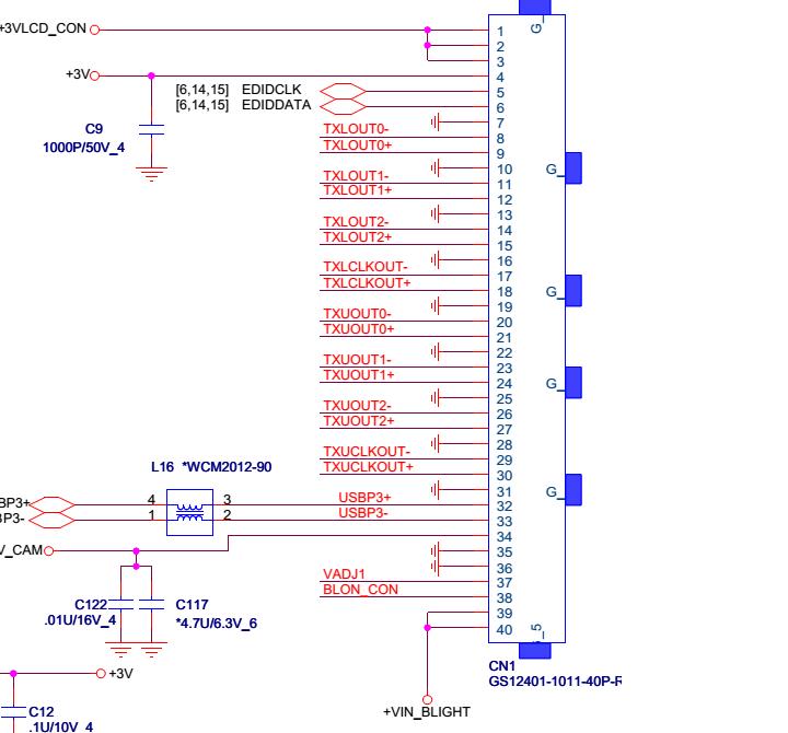

I have here a CQ71 mobo with a weird symptom :
the internal lcd (LED) is very dark at point that I can't use it.
I have made a "soft" reflow on gpu and no change, with LED display, there are not external inverters like before ?
I read that he could be just a setting using the original keyboard, but I don't have any keyboard compatible with this mobo.
same lcd display work's fine on another CQ71 mobo.
Any hints ?
