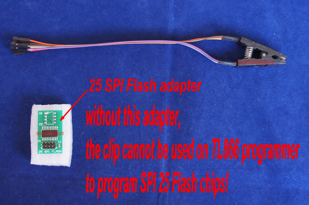

                i try once to read with the chip onboard and stop the adapter.
                its like it try to power the other board from the bios programmer through the USB.
                one thing tough i did not try is to give voltage to the board that got the bios chip that i want to read.

                    Re: HP Elitebook 8560p pw need help pls.
                    i bought myself a extension cord for spi chips to read and write without desoldering and i could not get it to work
                    i think dj_ricoh have the same problem
                    i tried to raise up voltage but it did not work

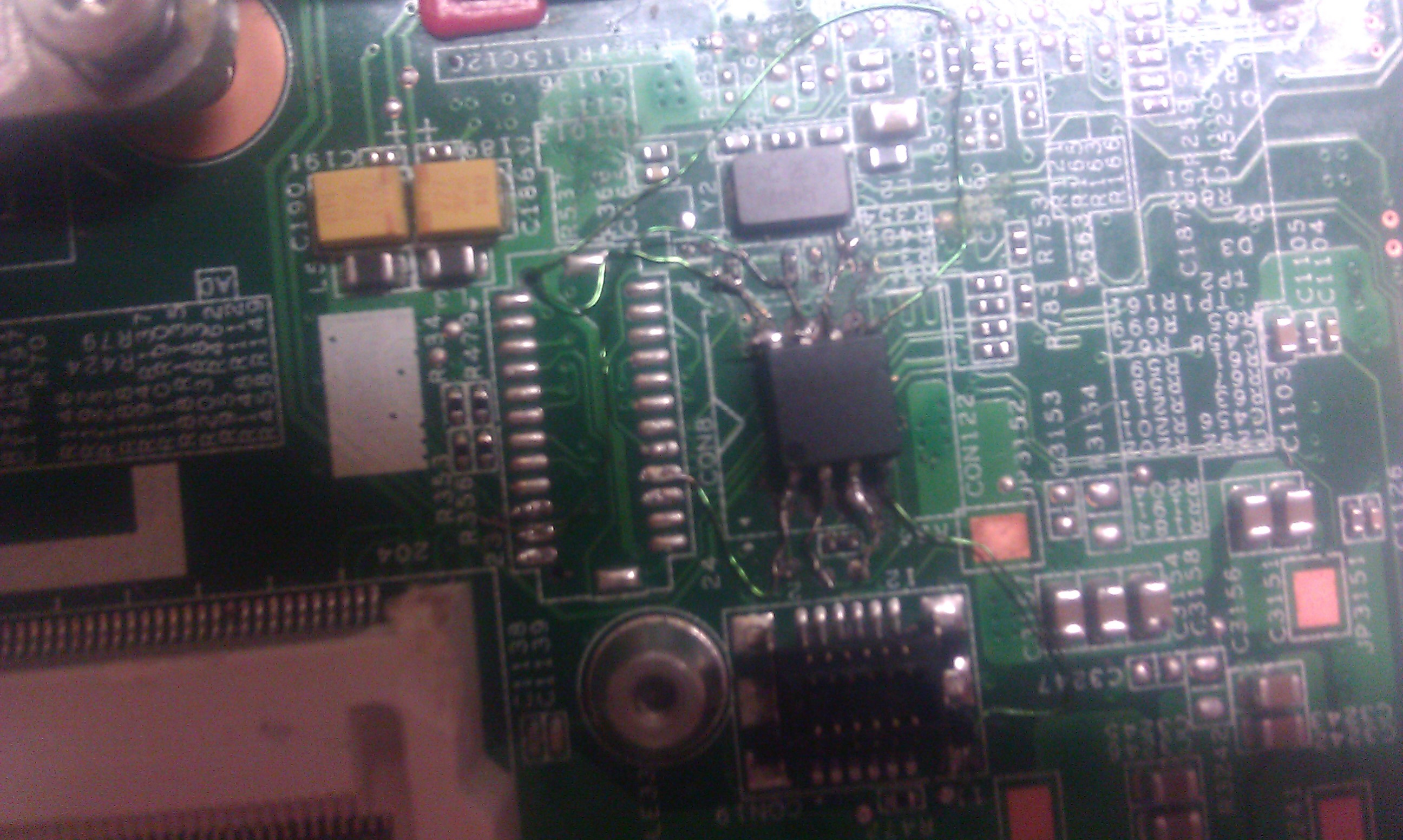

                          Hi Guys,
                          I finally got something done on this mobo.
                          First I ordered a bios chip and soldered it in, but the bios chip was not proper programmed so it had to come out again and a new one had to be placed.
                          That cost me the islands and traces around the chip. Soldering 4 times was to much of heat for the PCB and I am not that quick.
                          On the picture you can see the final repair, don't laugh, it cost me enough but it seems to work.
                          Now I have a next problem, I programmed the chip with a CH341a and everything looked OK, but the system don't work. It switches on, all led's light up and than it switched off right away. Than it keeps on trying every 5 seconds
                          but no image or anything., The fan jumps on and off at the same time.
                          So he wants to work. Tried to reflash bios with windowskey-B, but no luck.
                          Schematics are not available.
                          Can somebody point me in the right direction?

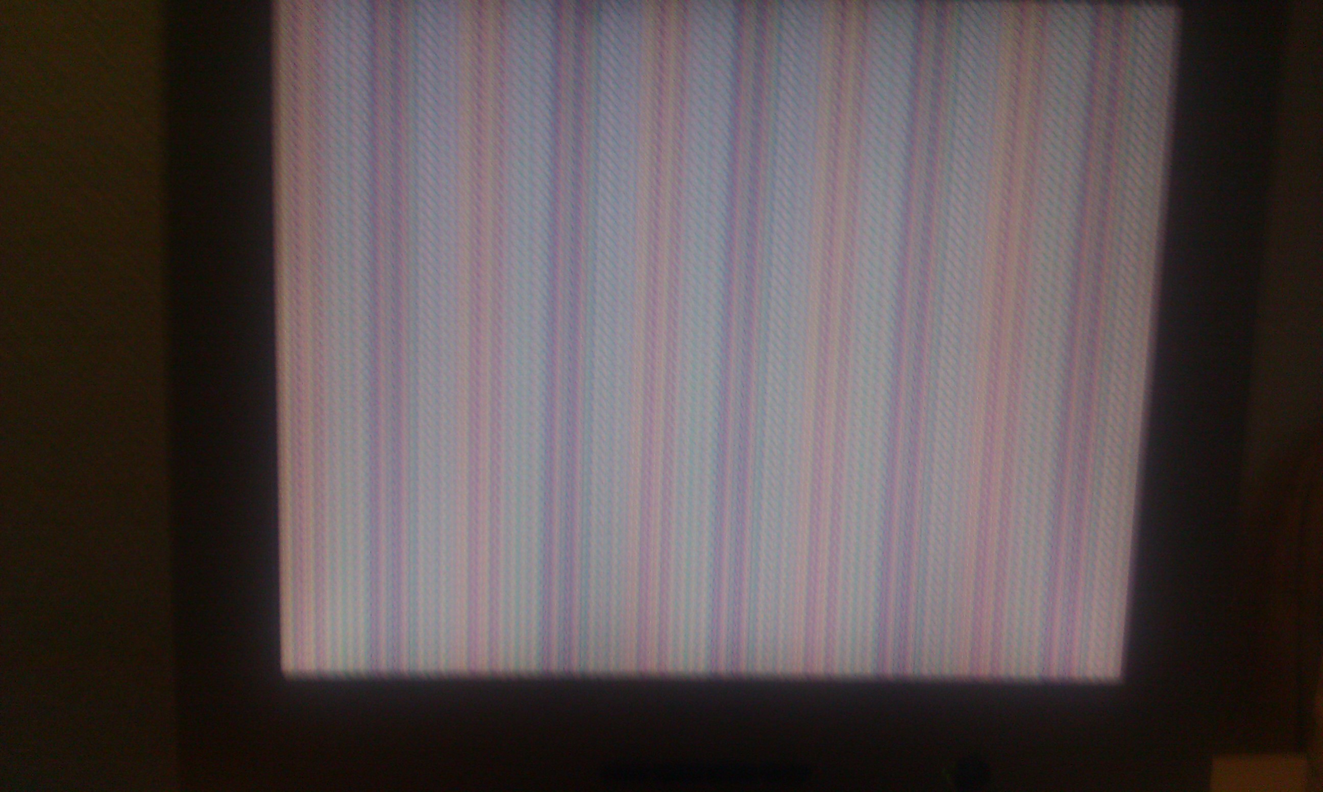

                            Got the mobo working for a minute on an external vga. Distorted picture with colored vertical bars.But you can see the bios and open it and he is starting Windows.
                            On the displayport to hdmi I get nothing.,
                            After a while bios froze and nothing no more on the vga

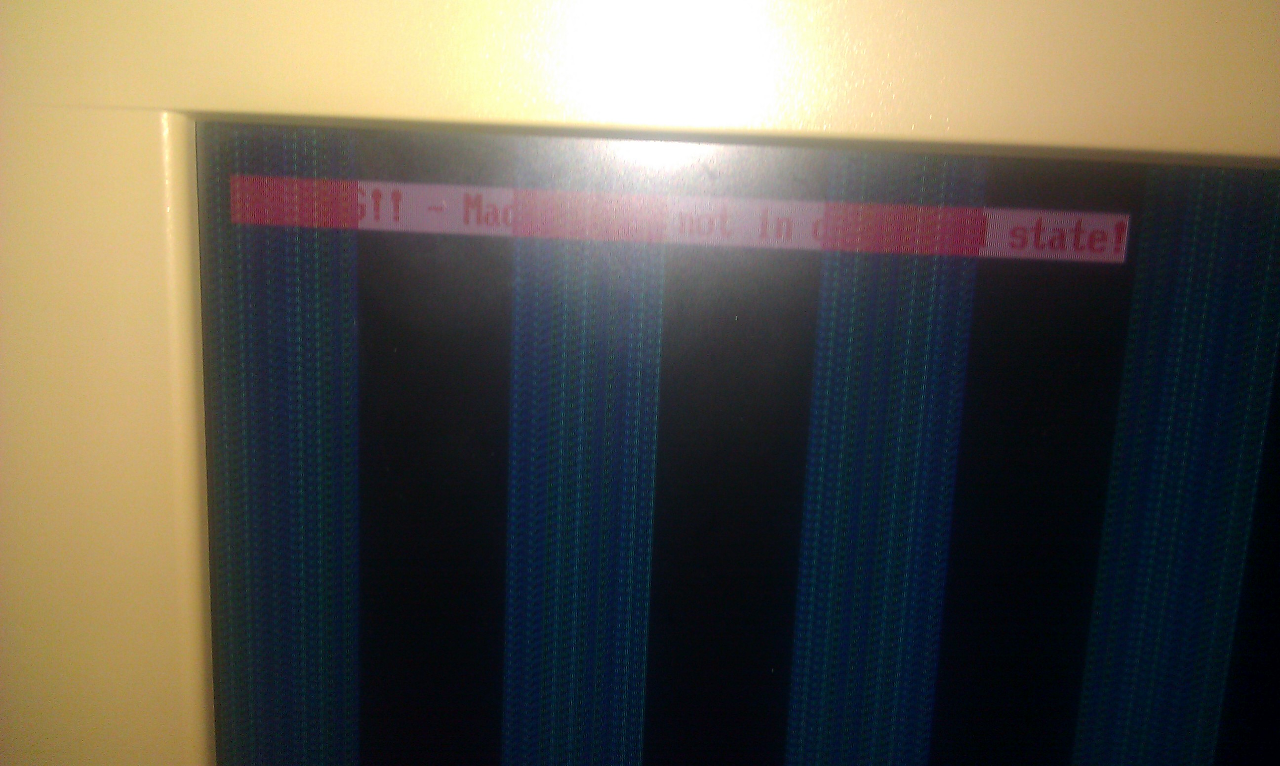

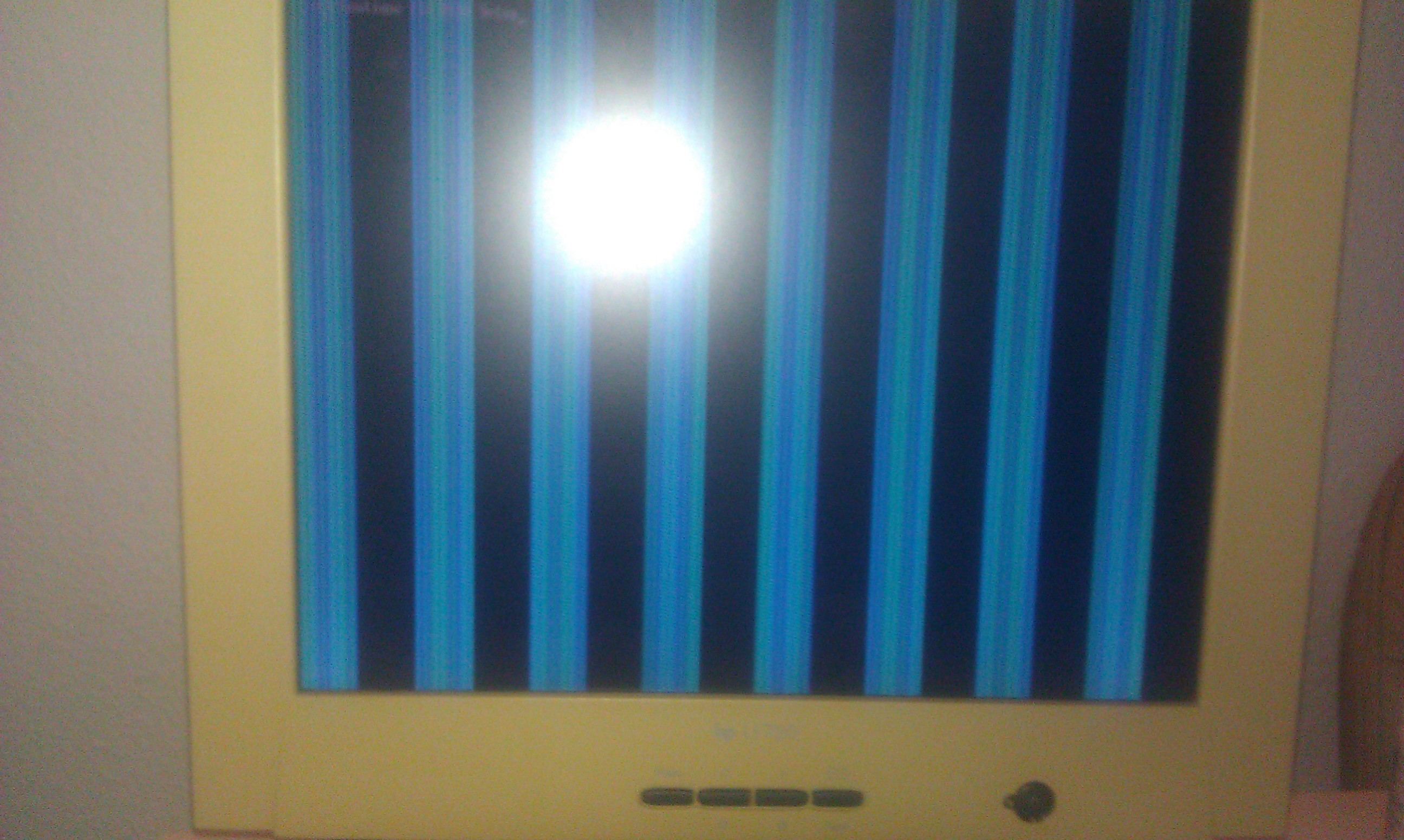

                              I got a little more out of the system.
                              At start up I get the screen with the blue bars.
                              When he continues, I get the all color screen when windows 8.1 is loaded.
                              This will hold about 10 seconds and than he restarts.
                              The message I get right at Post, but I can't read it.
                              Anyone knows this message?
                              I only get these screens on external monitor via VGA. On the displayport and the system screen I get nothing.
                              Can this be extensional problems what is coursed by the BIOS?
                              Pls help me
                                That's video.
                                Cool the board
                                        then i agree with dj_ricoh, must be vga... ati does that kind of things....
                                        try to reflow and see what happens
                                        its hard without sch but none available for now
