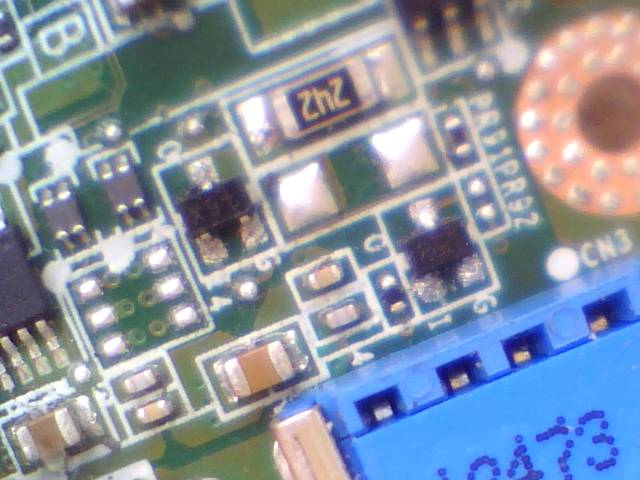

    Hi
    I have a vostro 3360 which don't start.
    On the motherboard I found PQ10 to get very hot, but the components connected to him seems to be OK, no short
    Is this a defective PQ10 for sure or do I have to look at other things?

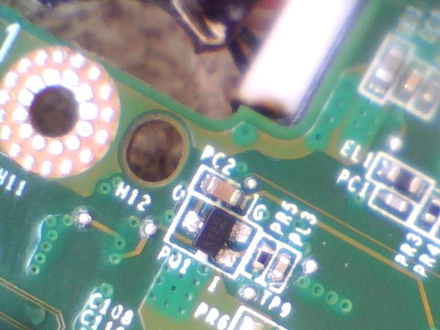

            Re: Dell Vostro 3360 no power on
            Hi Guys,
            I put a new PQ10 on the board, but this one also gets very hot, so no gain there.
            Checked around the PQ10 for other components , but no short there.
            There is a strange thing, the mosfets are usually numbered 1-2-3- or G-S -D. There are several 2n7002W but the marking on the board says I-G-O.which does not correspondent with the factory specs from the 2N7002W.
            The schematics shows 1-2-3 of which 1 is on GND and on the board 2 is on ground.
            Can somebody pls explain how to messure?
                  Wat it looks like, is that Dell uses the marking "In- Out-GND" on the motherboard,
                  This is very confusing, because the schematics use "1-2-3"
                  The pinout from the 2N7002W is 1= Gate, 2= Source and 3= Drain
                  So on the mobo it looks like In=Gate, Gnd=Source and Out=Drain
                  The schematics now look wrong because 1=Source, 2=Gate and 3=Drain and 2 is on gnd
                      Probably you got the wrong numbering (if I am looking at the right schematic). PQ10 is an 4435. 2n7002W is either the PQ11, PQ1, PQ14 or PQ16.
                      • bicalov
                        • Nov 2014
                        • 294
                        • Netherlands
                        That is correct. The PQ10 I have changed for a new one. The PQ11,-1,-14,-16 are 2n7002W and it is by these ones the letters I,G,and O are on the board and not 1-2-3.
                        If I translate the letters from the board to the schematic, it would be: 1= I , 2 = G and 3 = O. or translated to letters Gate=I, Source= G and Drain= O.
                        Very confusing, see pictures
