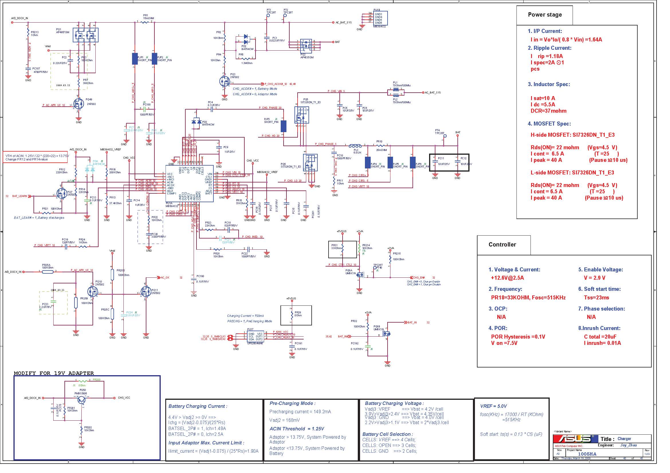

      Re: Asus PC EEE 1005HAB - Charging Circuit Help
      Here is a copy of the charging sheet of the schematics.
      Thank you,
      Jerry

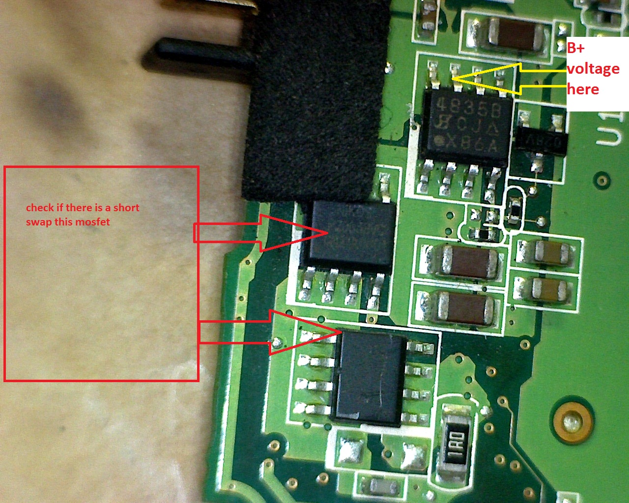

        check this mosfet if shorted and swap the 2 that has same number;

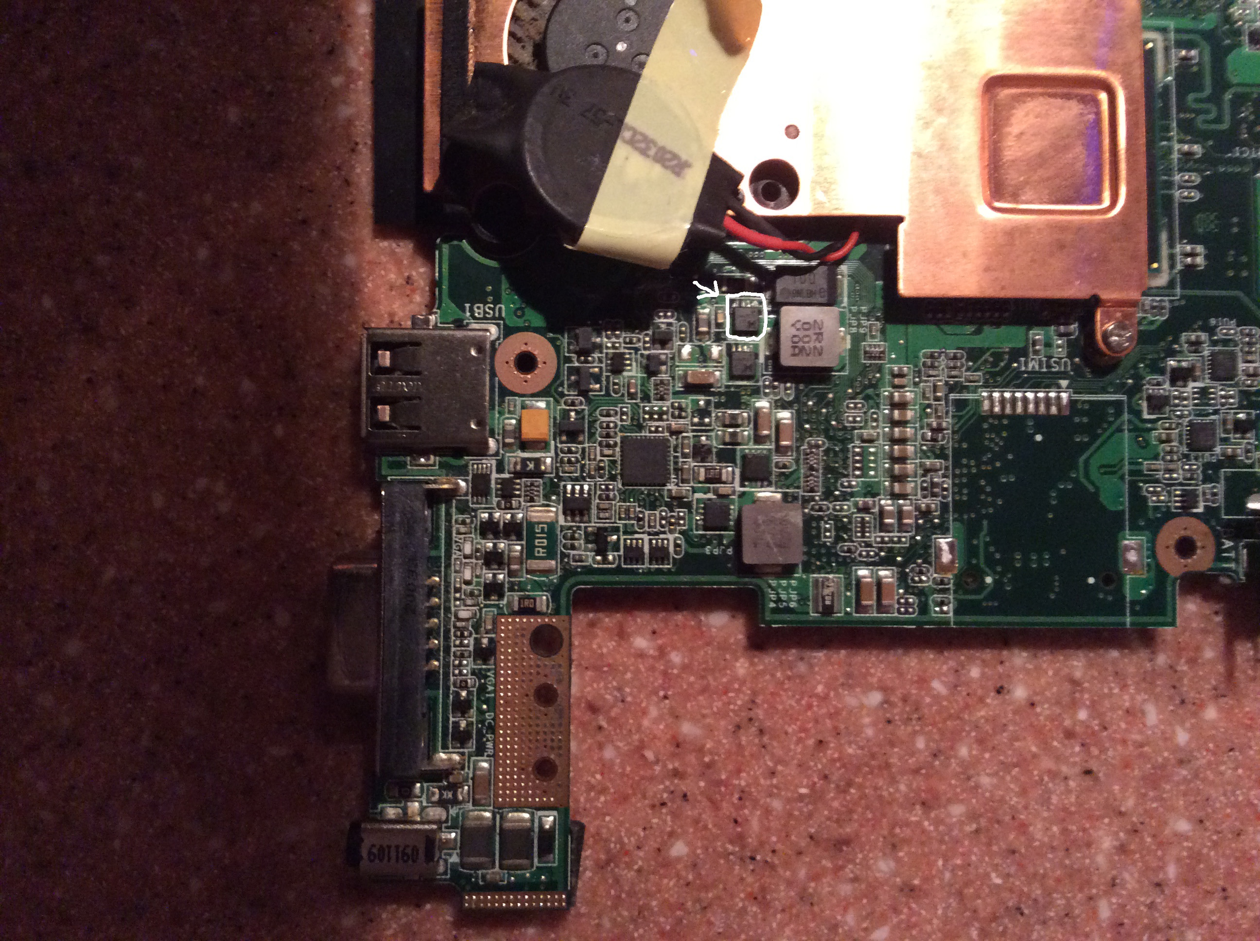

          My board does not look like that one. I did test each mosfet I could find. I found one that was shorted only when I reverse the test leads. None of the other ones did that. I have circle the one that did it. Is this the culprit?
          Thanks,
          Jerry
