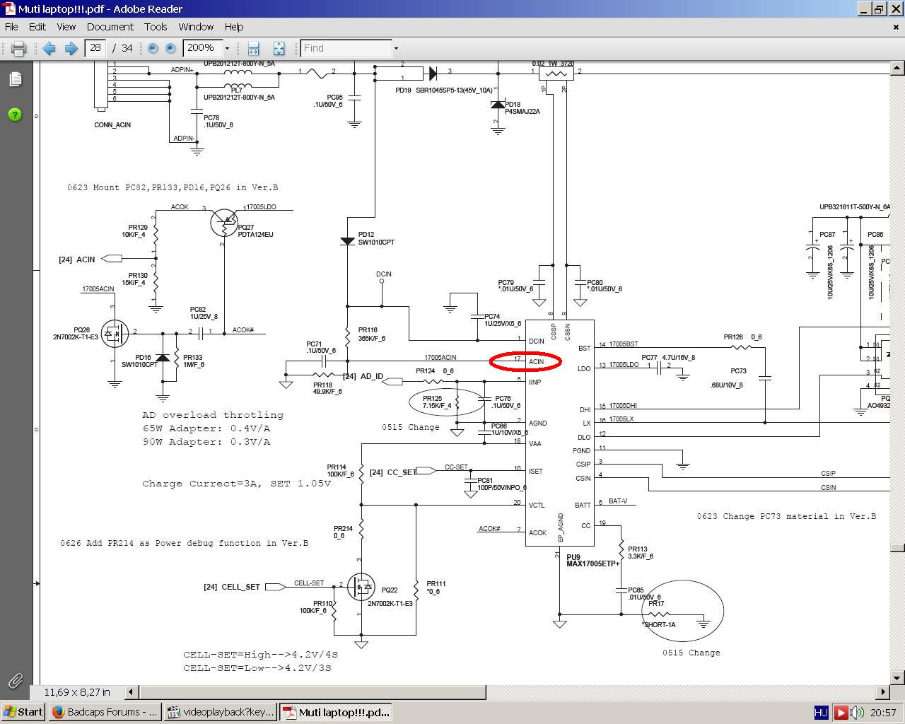

                      i have an amilo li laptop and i accidently shorted an Ic on the mobo ,there's no 3VPCU on NBSWON and i traced the short to pu9 Ic .i circled the shorted pin ,and attached a screenshot from it and also attached the entire datasheet of my mobo.I absolutely sure about this ,but i want to ask ,can I bridge a 3 volt source from elswhere on the motherboard to the Pu9's defective pin, and i have the nbswon working again?( I bridged a defective laptop lcd backlight circuit and it's worked ,that's why I asking it) Or i must buy this Ic from aliexpress?
                      • piernov
                        • Jan 2016
                        • 4435
                        • France
                        Re: Stumped on this Acer 6530G - dead motherboard
                        No this is the charger IC. If it's bad the computer wont turn on, replace it. The EC needs to see a working AC adapter (reported by the charger IC on the ACIN pin) to release RSMRST# AFAIK. If you're on battery, the charger IC needs to work too to alow the current to flow from the battery to the system.
                        Maybe it can work without it but I don't think so, the best idea is to replace it.
